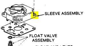

Forrest Carver 52 #9 Posted January 23, 2023 Carburetor problems continue unfortunately. The machine ran OK on a full choke, but required constant choke adjustment to stay running so I couldn't really use it. Upon taking the carb apart, I broke a corner off the top cover (see highlighted section below.) Actually, it looks like it was already broken once as there was some hard black goo all along the side of the broken piece, JB Weld maybe? I assume it would be impossible to find this replacement part? Maybe I can JB Weld it again? Can I just replace the entire carburetor with a modern aftermarket one? Share this post Link to post Share on other sites
lynnmor 9,073 #10 Posted January 23, 2023 I would try to find a good used one or maybe you could find a good welder that would tackle the job. Converting to a later model carburetor and adding an electric fuel pump is a good idea but again, try to find a good used one instead of Chinese junk. Share this post Link to post Share on other sites
oliver2-44 11,816 #11 Posted January 23, 2023 Contact A-Z one of the vendors here, he may have a good use top piece or complete carb Share this post Link to post Share on other sites

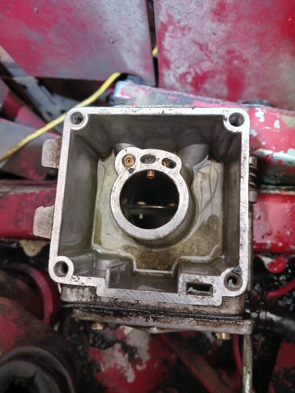

Forrest Carver 52 #17 Posted February 19, 2023 Finally got around to putting it back together. The weld held up and fuel is flowing out of the rectangular hole on the bottom half of the carburetor when the engine turns, but the bowl is not filling with fuel. I have verified that the float/needle both move freely, and the float rests at the bottom of the carb, therefore the needle is not plugging the entry hole. It doesn't appear that fuel is getting through the jet. Although it's brand new and properly installed. Any ideas? Forgive my lack of proper terminology. Share this post Link to post Share on other sites
lynnmor 9,073 #18 Posted February 19, 2023 41 minutes ago, Forrest Carver said: Finally got around to putting it back together. The weld held up and fuel is flowing out of the rectangular hole on the bottom half of the carburetor when the engine turns, but the bowl is not filling with fuel. I have verified that the float/needle both move freely, and the float rests at the bottom of the carb, therefore the needle is not plugging the entry hole. It doesn't appear that fuel is getting through the jet. Although it's brand new and properly installed. Any ideas? Forgive my lack of proper terminology. Does the float actually float or is it full of gas? Is the float made of brass or a plastic? Did you adjust the float as shown in the manual? Can you take a photo of the "rectangular hole?" Share this post Link to post Share on other sites
Forrest Carver 52 #19 Posted February 20, 2023 The float is brass and not full of gas, but I did not adjust it, simply replaced the jet and needle Share this post Link to post Share on other sites
lynnmor 9,073 #20 Posted February 20, 2023 Did you try cranking the engine with the carburetor top off? If you try it, carefully contain the area to keep gasoline from spraying all over, perhaps you could wrap a shop towel around and cover the carburetor with a jar. I guess that the rectangular hole is the one in your photo, if gas is pumping out of it then all that is left is a blockage in the area under the needle and seat. I guess that you are calling the seat the jet. Share this post Link to post Share on other sites

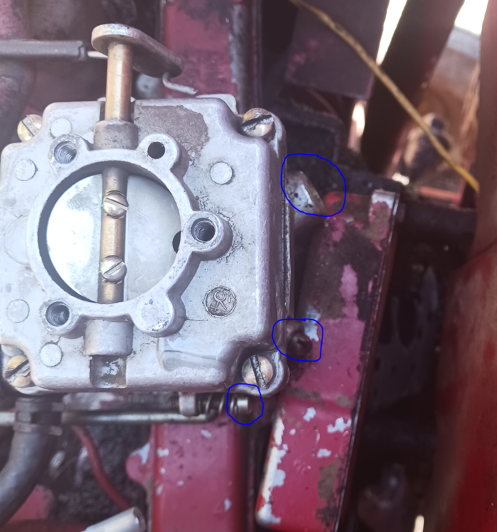

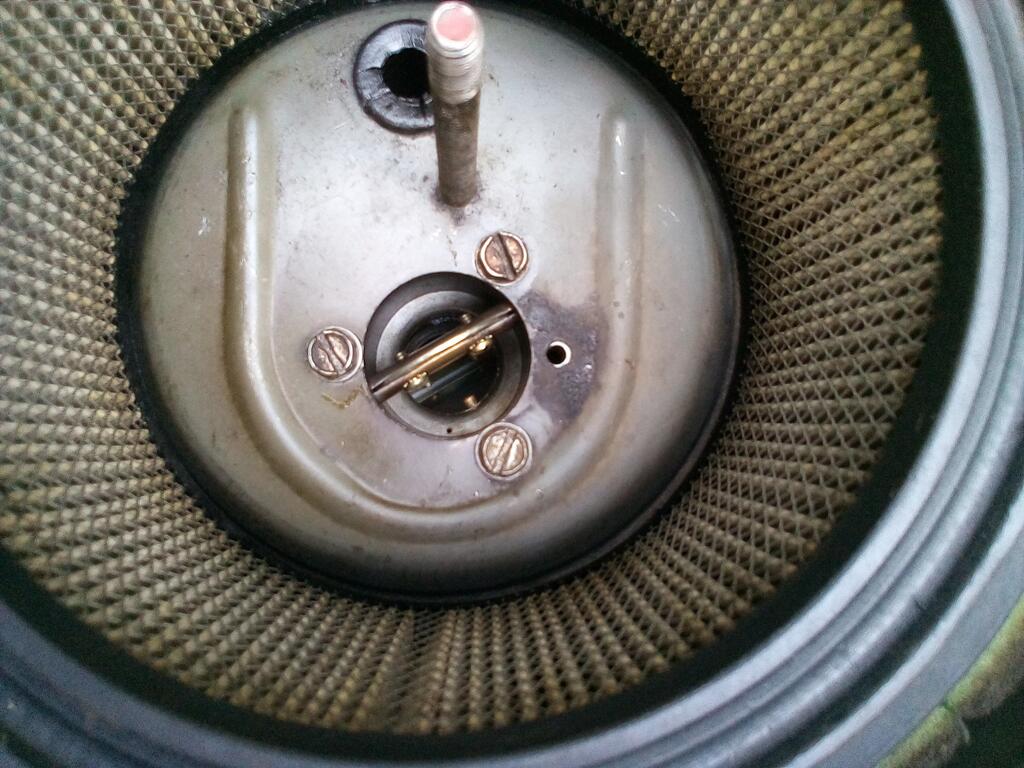

Forrest Carver 52 #21 Posted April 2, 2023 (edited) OK, back at it again. As far as I can tell, the floats were bent down enough that the needle was blocking the hole even with the bowl empty. I bent the floats up a bit, and now we're back to square one. The engine starts and runs fine when fully choked, or nearly-fully choked, but dies when I disengage the choke even a little bit. Does it just need to be adjusted? I see two adjustment screws and one place where it kinda looks like an adjustment screw should be, they are circled in blue below. Can I do anything with these? Is there something missing from the top circle? P.S. In the meantime I drained the fuel, refilled with clean gas, and replaced some fuel lines Edited April 2, 2023 by Forrest Carver Share this post Link to post Share on other sites
lynnmor 9,073 #22 Posted April 2, 2023 I guess that you still haven’t downloaded the Onan Service Manual and followed the directions in it. While doing a proper disassembly and cleaning, you probably shouldn’t remove the throttle and choke plates that the instructions mention since disturbing those screws can be an issue for inexperienced mechanics. When you have the intake manifold off, check for leaks. When reinstalling the manifold, use only genuine Onan gaskets and torque the bolts to the exact specifications shown in the manual. 2 Share this post Link to post Share on other sites

Forrest Carver 52 #24 Posted April 4, 2023 On 4/2/2023 at 6:13 PM, lynnmor said: I guess that you still haven’t downloaded the Onan Service Manual and followed the directions in it. While doing a proper disassembly and cleaning, you probably shouldn’t remove the throttle and choke plates that the instructions mention since disturbing those screws can be an issue for inexperienced mechanics. When you have the intake manifold off, check for leaks. When reinstalling the manifold, use only genuine Onan gaskets and torque the bolts to the exact specifications shown in the manual. I have read the manual although frankly a lot of it is intimidating for a novice mechanic. I don't want to make things worse, break something, or go down a path that I can't return on. I've done just that with carburetors on a snowmobile and a walk behind lawnmower. However, it looks like I have no choice at this point. I discovered something a little weird while trying to remove the intake manifold. In the attached image, the circled bolt spins and the nut on top is frozen. I would think that either A.) the bolt is not supposed to spin, or B.) There should be a head on the bolt instead of a nut. B seems more likely given the exploded view in the original post. In any case, it looks like I need to remove at least one exhaust pipe to remove the manifold? That's going to be a job as the aft bolts and the fore clamp are both rusted solid... Share this post Link to post Share on other sites
lynnmor 9,073 #25 Posted April 4, 2023 You should be repeatedly soaking all of the fasteners with penetrating oil, it can take days for it to work. Usually the exhaust needs to come completely off, so soak the pipe where it goes in to the engine. Do not force the bolts, if they move just a bit, soak some more. Your blue circled bolt is likely a stud for holding other things, is there a hex down next to the manifold? With the exhaust out of the way you can remove the nut and washers to see what is going on. I am going to add some more work for you since this would be a good time to do it. Check the compression to see if the engine is healthy. Remove the valve covers and adjust the valves. Glass bead and paint the exhaust. If you decide to do these worthwhile things, don't worry, just stop back and ask before making moves that may need guidance. Share this post Link to post Share on other sites
