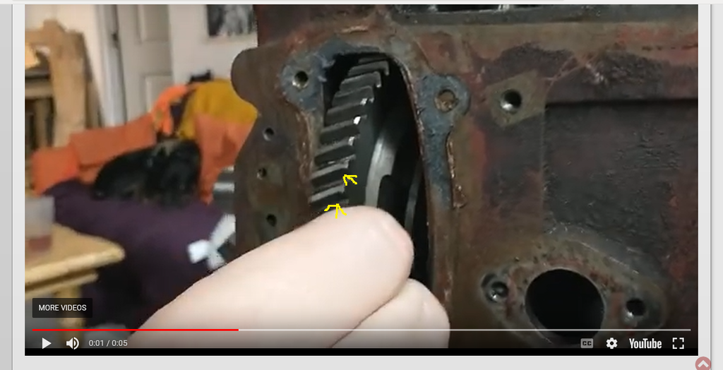

Folks I finally got a minute to go a little further.
Cam (to crank??) is making the clanking noise.
Loose gear mesh?
Are the balance gears attached here?
What do I look for next?
When you move the cam like you did in the video, does the crank move with it... or does it feel sloppy? :confusion-confused:
EDIT: I tried to slow the video down to see if the crank was moving while you were moving the cam... I didn't see the crank move at all.
Seems as if you've those gears are worn... :ph34r:
Wouldn't be the first time someone has encountered that problem...
Don
Edited by Snoopy11

ebinmaine
Don
Crank does not move.
Just now, Jeff-C175 said:
I haven't looked at vid yet...
How is the cam end play?
Side to side movement makes a similar noise

Snoopy11
1 hour ago, Jeff-C175 said:
What would puzzle me if it's found to be excessive
I thought about this overnight. It could be that there is so much end play and the cam is so off-center that the cam and crank gears are not parallel... perhaps with the cam gear riding on the edge of the crank gear... :eusa-think:
Stating the obvious... that cam gear is supposed to be tightly meshed with the crank... no play. When you move the cam, the crank should move. THAT is what can break gear teeth... :bow-blue:
Going over the video again... it is VERY hard to tell... but am I seeing bite marks on the inside of the cam gear?
Don

Jeff-C175
With helical cut gears if there's end play in the cam, the cam will slide sideways when you move the gear up / down.
I  think  I recall seeing a 'relief' cut on the edge of that cam gear last I had mine apart.
  • Like 1
  • Excellent 1
Snoopy11
Which would make it roll on the edge of the cam gear... :eusa-think:
If that cam shows any signs of damage... I would NOT put it back in that engine...
I may have a spare k341 cam around here... somewhere... if you need it Eric, just let me know and I'll go lookin' fo' it...
YIKES... I forgot that I bought it from VM when I was thinking about going performance on my K341... I think you might be able to find one cheaper elsewhere, Eric if you need one... :scared-eek:
Don

Just for reference, I posted this pic in another thread, but it shows the relief cut on the balance and crank gears, I recall seeing this same type of cut on the cam gear.  I also recall having the same sort of clearance between the cam gear and the crank gear.
In this pic the arrow is pointing to what I believe is the source of the earth shattering kaboom when the bearings on the balance gears get worn.  The balance gear can slide over just enough to contact the crank gear at that point.  When that happens, game over.
