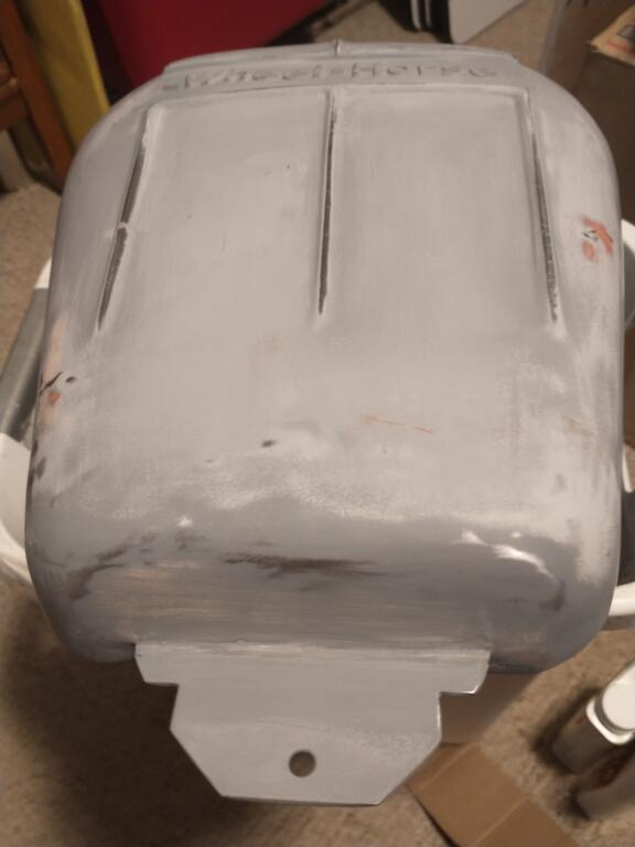

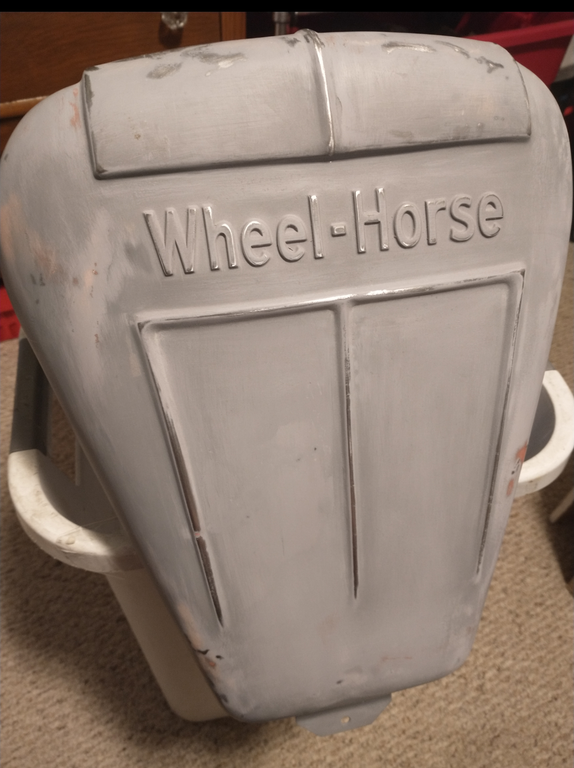

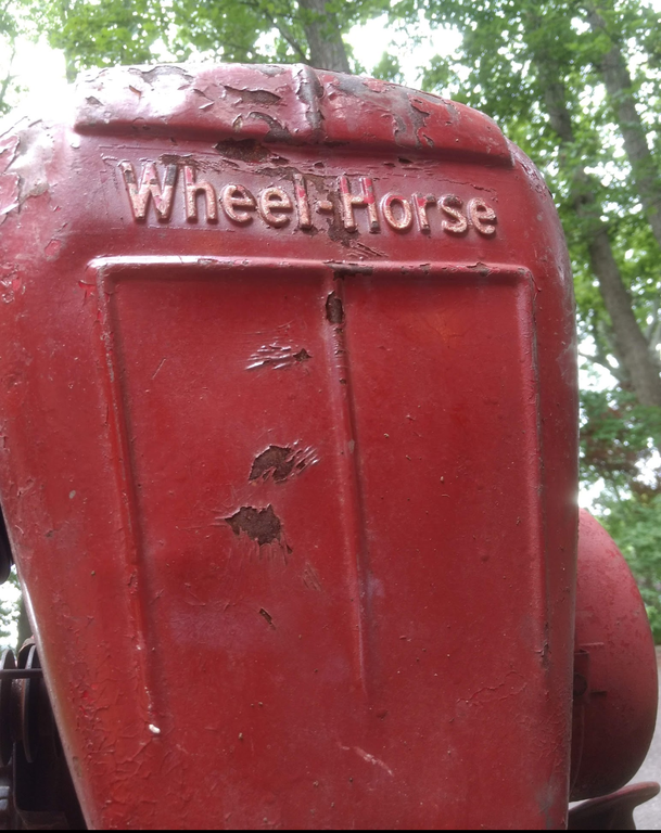

rmaynard 16,291 #1 Posted September 14, 2022 (edited) Over my 72 years, I have dabbled with automotive body work from time to time. Back in the early 1990's I took a night school course in auto body. I learned a bit, but lots of things have changed since then. In 2009 when I decided to restore my B-100, the bug again bit me and I watched hours of YouTube videos on how to use hammer and dolly to remove dents. I found it fascinating, so i bought a set. Fast forward to 2018 when I bought a project 701 at the WHCC show. This is what the hood looked like. It's been over 4 years of working off and on with my hammers, and I think that I'm finally ready to put some primer on this thing. Edited September 14, 2022 by rmaynard 6 28 1 Share this post Link to post Share on other sites

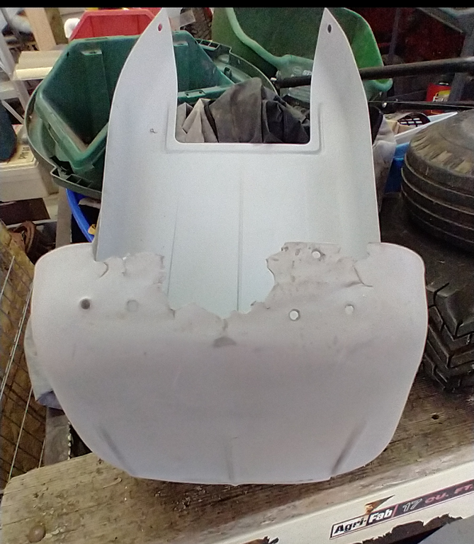

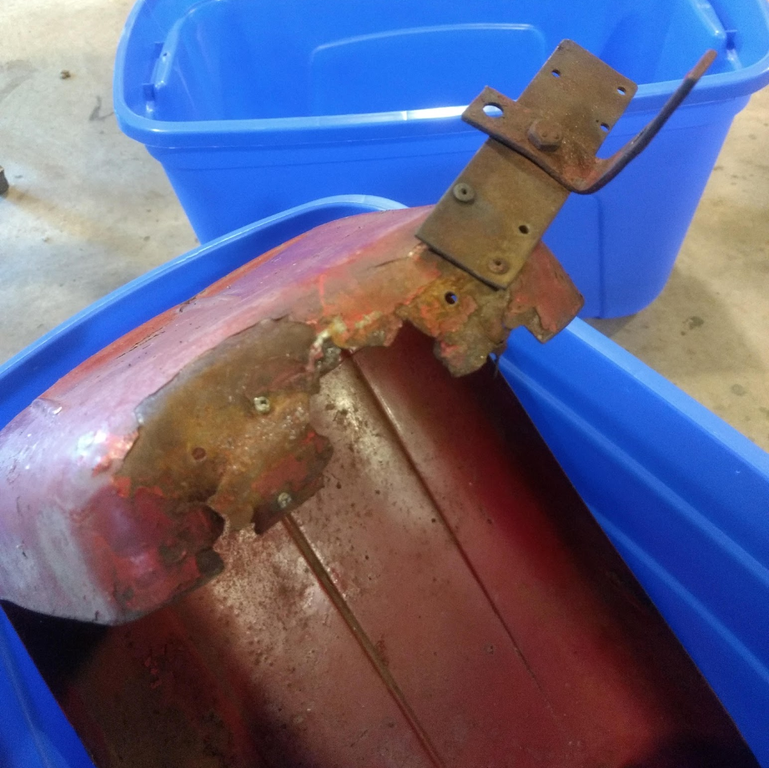

ri702bill 9,350 #3 Posted September 14, 2022 Seem like you have mastered the "hammer on" and the "hammer off" techniques. Body work is 10% inspiration, 70% preparation, and 20% perspiration (depending on the season)..... If done properly with very little filler, the inside of the hood will look acceptable too. Good work. How was the lower tab when you got it?? If you had to replace it, a good spot to learn how to "Hammer weld"... (actually not hard to master).... Bill 1 1 1 Share this post Link to post Share on other sites

Snoopy11 5,718 #5 Posted September 14, 2022 I guess, by the way that... eh... "indention" looks... a tree ran into the tractor? That hood looks brand new now, Bob! Don 1 1 Share this post Link to post Share on other sites

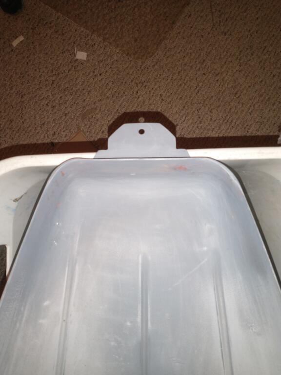

rmaynard 16,291 #11 Posted September 14, 2022 4 hours ago, ri702bill said: How was the lower tab when you got it? Here's a couple of pictures of the bottom tab area. Before: After: 1 12 Share this post Link to post Share on other sites
