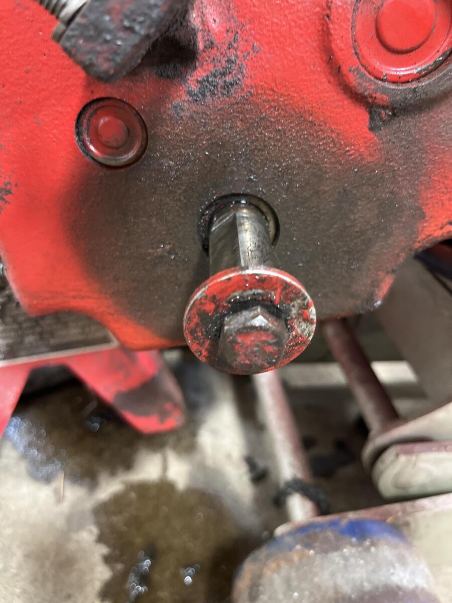

Kevippolito 3 Posted June 6, 2022 Need to replace the brake shaft seal on the tranny, it’s leaking. Can I do it from the outside or do I need to pull apart the whole transmission? Thankyou Share this comment Link to comment
JoeM 10,317 Posted June 6, 2022 Get the metal encased seal, skf I believe. Tried the rubber housing ones twice did not work for me. Share this comment Link to comment
Kevippolito 3 Posted June 7, 2022 30 minutes ago, OldWorkHorse said: Outside job. Thankyou! 1 Share this comment Link to comment
Kevippolito 3 Posted June 7, 2022 21 minutes ago, JoeM said: Get the metal encased seal, skf I believe. Tried the rubber housing ones twice did not work for me. 21 minutes ago, JoeM said: Get the metal encased seal, skf I believe. Tried the rubber housing ones twice did not work for me. Great Thankyou Share this comment Link to comment
Maxwell-8 4,371 Posted June 7, 2022 (edited) Looks to me their isn't a seal in place in the picture. And if their is one, be very carfull taking it out, not to damage the shaft or the bearing behind the seal. Edited June 7, 2022 by Maxwell-8 Share this comment Link to comment
