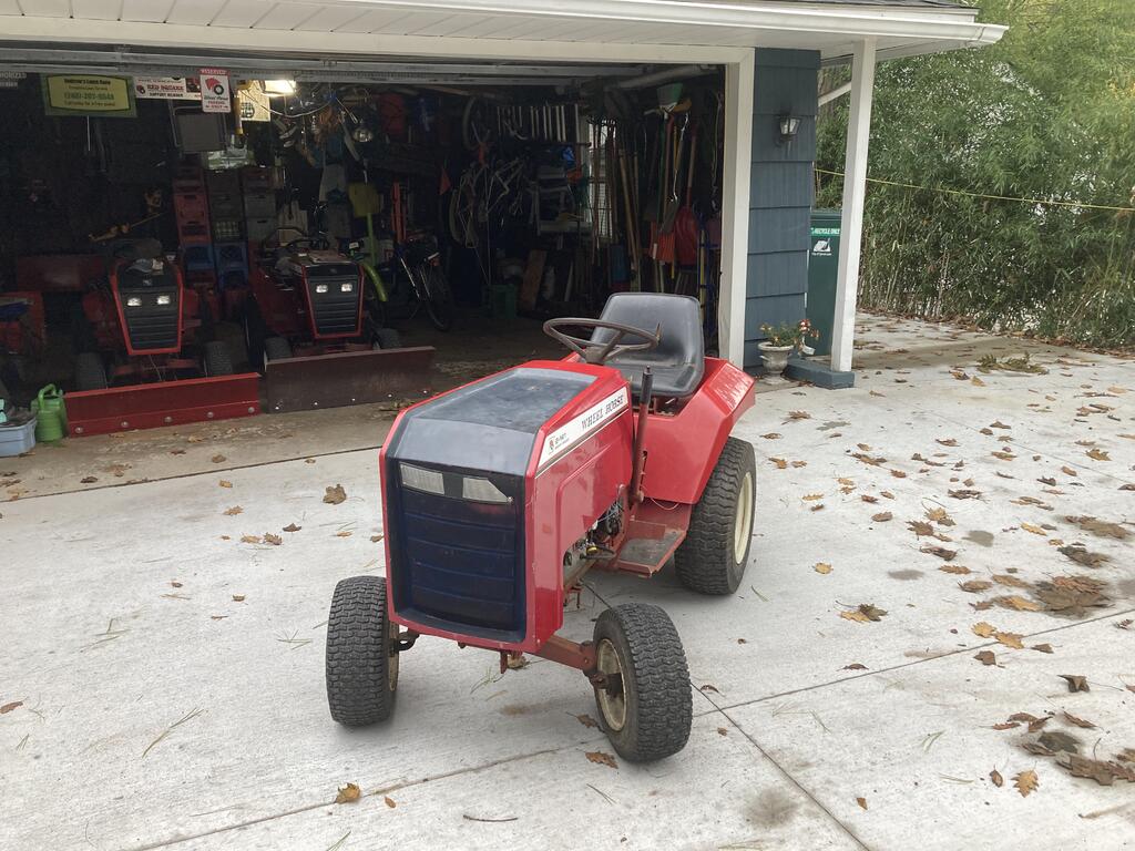

	I’m converting my 314-8 to electric
</p>
<p><a href="https://www.wheelhorseforum.com/uploads/monthly_2025_12/IMG_5789.jpeg.bb69e5fb5aa8e5df765fe5aea58413bf.jpeg" class="ipsAttachLink ipsAttachLink_image"><img data-fileid="459802" src="https://www.wheelhorseforum.com/applications/core/interface/js/spacer.png" data-src="https://www.wheelhorseforum.com/uploads/monthly_2025_12/IMG_5789.jpeg.bb69e5fb5aa8e5df765fe5aea58413bf.jpeg" data-ratio="133.33" width="576" class="ipsImage ipsImage_thumbnailed" alt="IMG_5789.jpeg"></a></p>
<p><a href="https://www.wheelhorseforum.com/uploads/monthly_2025_12/IMG_5791.jpeg.a16f4a80d8931fb842b766686619b7e9.jpeg" class="ipsAttachLink ipsAttachLink_image"><img data-fileid="459803" src="https://www.wheelhorseforum.com/applications/core/interface/js/spacer.png" data-src="https://www.wheelhorseforum.com/uploads/monthly_2025_12/IMG_5791.jpeg.a16f4a80d8931fb842b766686619b7e9.jpeg" data-ratio="133.33" width="576" class="ipsImage ipsImage_thumbnailed" alt="IMG_5791.jpeg"></a></p>]]></description><guid isPermaLink="false">114142</guid><pubDate>Fri, 19 Dec 2025 15:32:03 +0000</pubDate></item><item><title>Elec-Trak</title><link>https://www.wheelhorseforum.com/topic/113923-elec-trak/</link><description><![CDATA[<p>
	When I seen this video, I was intrigued by how many different models and the attachments that were available. Anyone know if WH offered the attachments? And which one was the E-141? The 15 or 20
</p>

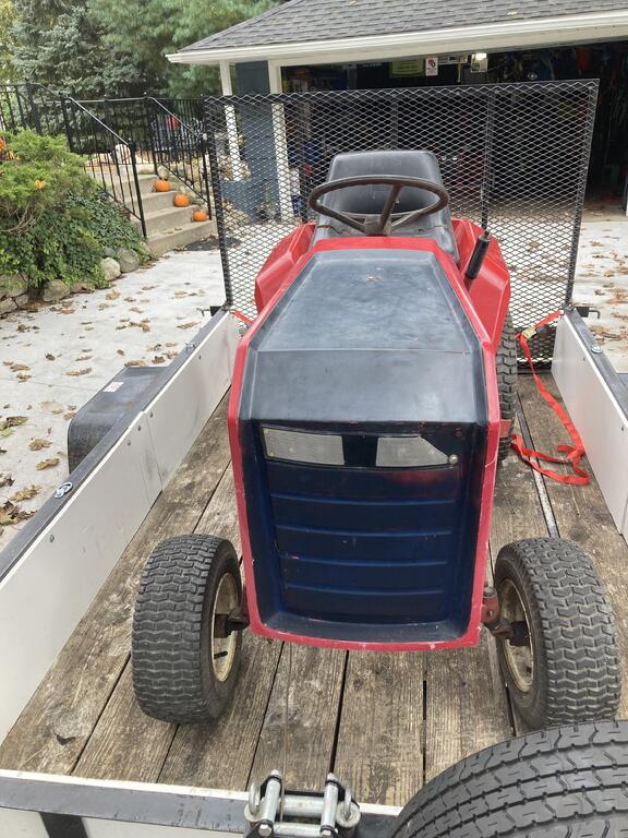

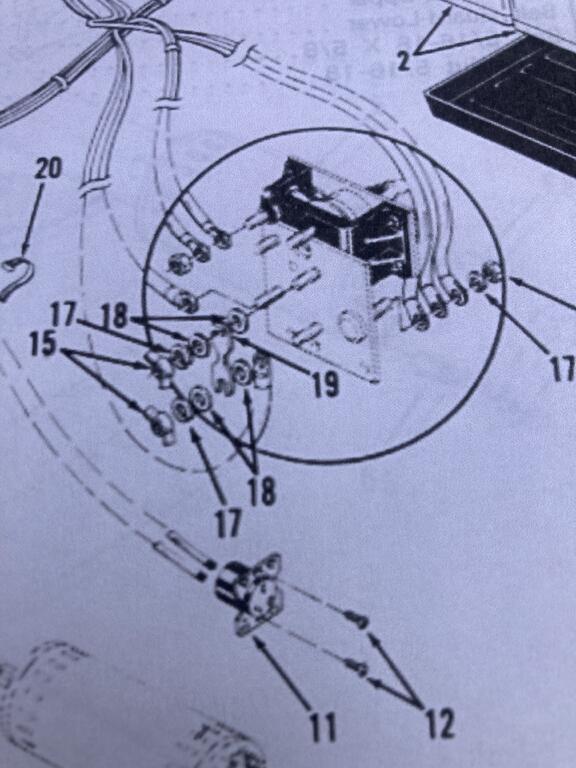

	Hello, I will be needing a couple photos of how the original seat safety switch mounts on a E 141. The new addition to the collection has the wrong switch and it may not be mounted correctly. I will get some pics of the machine  up later today i hope.
</p>
<p>
</p>
<p>
	Thanks of course to the info on this website i was able to get the correct part numbers for the key switch,and seat safety switch and order them off ebay.
</p>

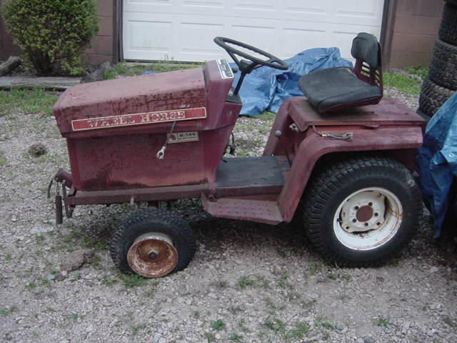

	As much as I love my Raider 10, boy is it LOUD!
</p>
<p>
</p>
<p>
	Sometimes I need to grab firewood or move a trailer around the yard at night, and I would like to be considerate of the neighbors. So, I had the idea to make an electric wheel horse.
</p>
<p>
</p>
<p>
	I began the hunt for a non-working tractor for this project and finally found one this weekend!
</p>

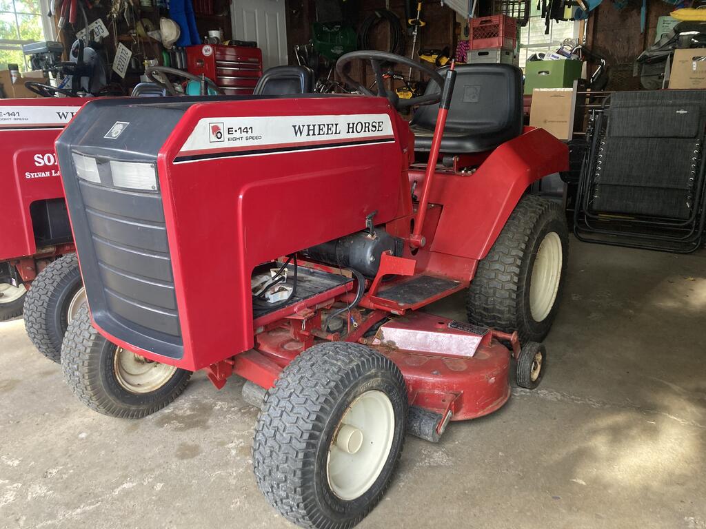

	I noticed another member posted his E141 setup to push that pesky white snow, so I thought I would just make a thread to show our machines at work ,instead of highjacking his.
</p>
<p>
	Needed some fire wood and the woods around here is full of dead small trees.
</p>

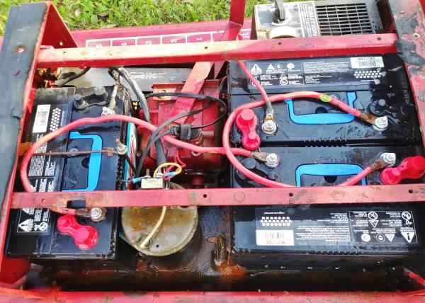

	3 new deep cycle batteries from Costco. Saving the WH branded, never seen acid still in shrink wrap, for garage decorations.

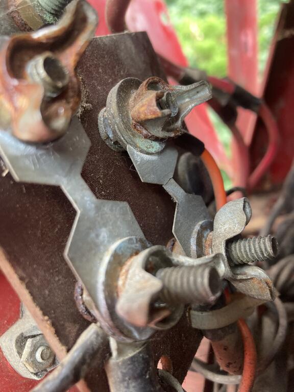

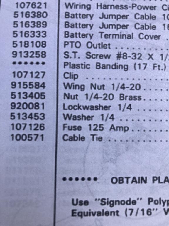

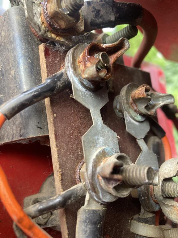

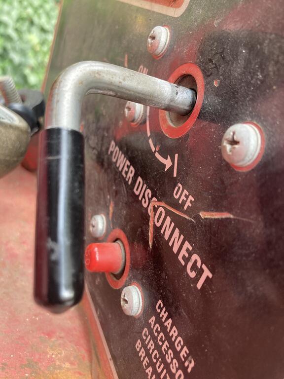

	Went to get the E-141 SolarExpress ready for train duty and nothin, nada, zip... looked at the power disconnect and sure enough same issue as the A-60... Not sure though if Dans same fix? <a contenteditable="false" data-ipshover="" data-ipshover-target="https://www.wheelhorseforum.com/profile/14491-achto/?do=hovercard" data-mentionid="14491" href="https://www.wheelhorseforum.com/profile/14491-achto/" rel="">@Achto</a> <a contenteditable="false" data-ipshover="" data-ipshover-target="https://www.wheelhorseforum.com/profile/658-wallfish/?do=hovercard" data-mentionid="658" href="https://www.wheelhorseforum.com/profile/658-wallfish/" rel="">@wallfish</a> <a contenteditable="false" data-ipshover="" data-ipshover-target="https://www.wheelhorseforum.com/profile/15265-whx/?do=hovercard" data-mentionid="15265" href="https://www.wheelhorseforum.com/profile/15265-whx/" rel="">@WHX??</a>
</p>
<p>
	<a href="https://www.amazon.com/Tocas-Surface-Mount-Circuit-Breakers-Waterproof/dp/B07D7S2VBY/ref=sr_1_5?keywords=70%2Bamp%2Bcircuit%2Bbreaker&amp;qid=1692491449&amp;sr=8-5&amp;th=1" rel="external nofollow">https://www.amazon.com/Tocas-Surface-Mount-Circuit-Breakers-Waterproof/dp/B07D7S2VBY/ref=sr_1_5?keywords=70%2Bamp%2Bcircuit%2Bbreaker&amp;qid=1692491449&amp;sr=8-5&amp;th=1</a>
</p>
<p>
</p>
<p>
	They have a breaker 120 amp but not 125...
</p>
<p>
</p>
<p>
	Part 19 - 125 amp fuse...
</p>
<p>
</p>
<p>
	Definitely the issue - I jumped it with clips and it fired right off...
</p>
<p>
</p>
<p>
	Help...advice...please...
</p>

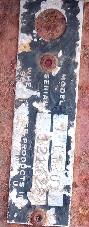

	I have a B-145 / model C720 that is   .....well, pretty ruff shape.<br />
	I no longer have any intent to bring this thing back to life and I was planning to salvage the motors (if I can find a use for them) and scrap the rest.<br />
	What voltage run the motors on these? I have looked and none of the electric motors have anything identifying them, nor voltage requirements.<br />
	I did download the manual but seen nothing for motor voltage.<br />
	It has 2 - lift motors (front and rear) and a drive motor.<br />
	I did connect 12 VDC to one of the lift motors and got no response.
</p>

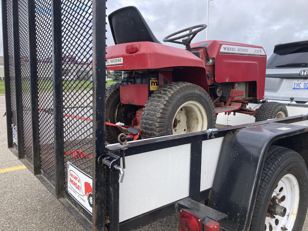

	So last fall I bought a NOS A-60 Electric from a gentleman in Minnesota. But... I'm 11 hours away in Michigan... <img alt=":eusa-think:" data-emoticon="" src="https://www.wheelhorseforum.com/uploads/default_eusa/think.gif" title=":eusa-think:" />
</p>
<p>
</p>
<p>
	Then it dawned on me... I know several folks who think 11 hours one way is "before lunch" on a Wheel Horse wrangler trip... So, I message a few and before long, thanks to the generosity and ingenuity of <a contenteditable="false" data-ipshover="" data-ipshover-target="https://www.wheelhorseforum.com/profile/10921-pullstart/?do=hovercard" data-mentionid="10921" href="https://www.wheelhorseforum.com/profile/10921-pullstart/" rel="">@Pullstart</a>, <a contenteditable="false" data-ipshover="" data-ipshover-target="https://www.wheelhorseforum.com/profile/15265-whx/?do=hovercard" data-mentionid="15265" href="https://www.wheelhorseforum.com/profile/15265-whx/" rel="">@WHX??</a>, and <a contenteditable="false" data-ipshover="" data-ipshover-target="https://www.wheelhorseforum.com/profile/14491-achto/?do=hovercard" data-mentionid="14491" href="https://www.wheelhorseforum.com/profile/14491-achto/" rel="">@Achto</a> the little gal started her way to Michigan yesterday when achto and whx?? added a stop and picked her up on a previously planned all day run to Iowa, Minnesota and back to Wisconsin...

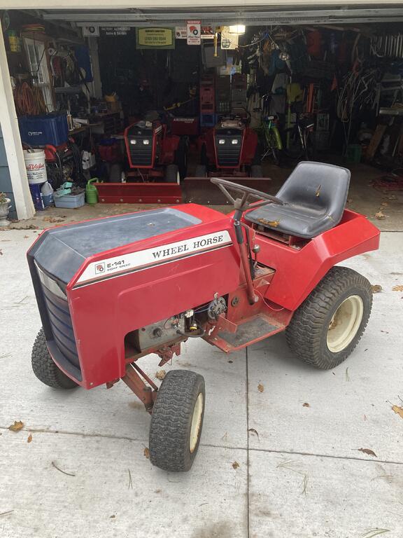

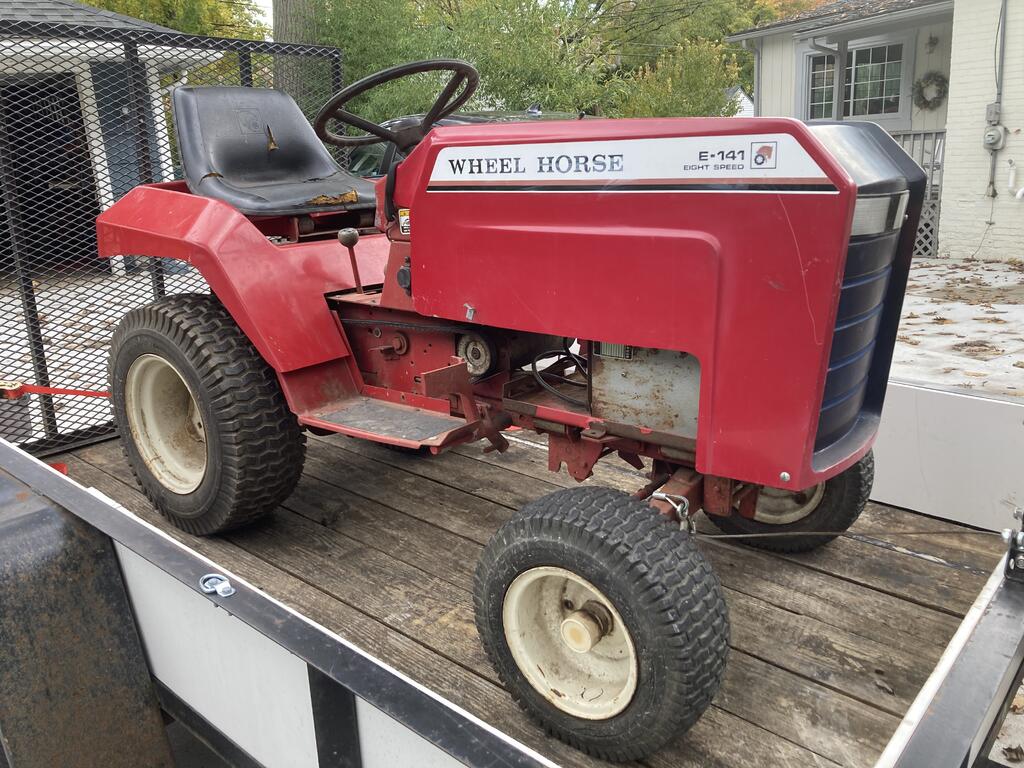

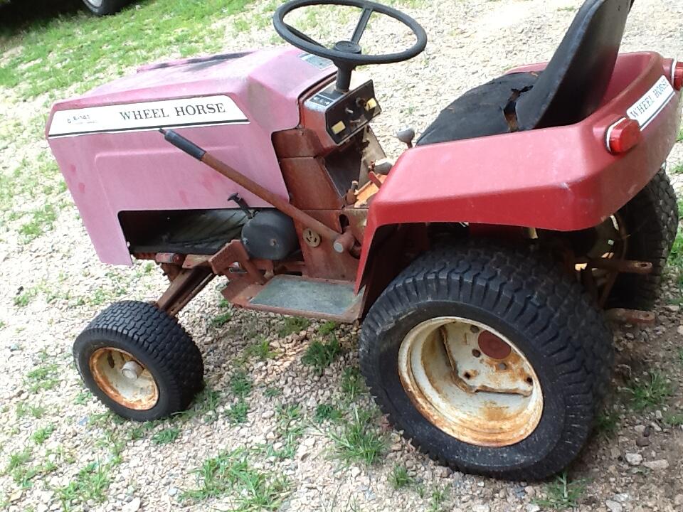

	I thought I would at least get started here by posting pics of the 2 recent purchases and ask a few questions about the E-141
</p>
<p>
	What I was hoping to learn,was if there is a troubleshooting guide for the E -141? I know GE has a service manual with trouble shooting flow charts and info.I did find a schematic and parts break downs which is a big help.
</p>
<p>
	BUT long story short,due to a accident related brain injury  I am a bit slow to figure things out and pictures help. <span><img alt=":)" data-emoticon="" src="https://www.wheelhorseforum.com/uploads/emoticons/default_smile.png" title=":)" /></span>
</p>
<p>
	<span>The B-145 is the same as a GE Electrac E-14 so my book on ge's will be a big help for it.</span>
</p>
<p>
	<span>But I think the E 141 is a bit more scarce and plus it is a single speed PM motor,easier to bring back.</span>
</p>
<p>
	<span>I have done some work to it since the photo was taken, Replaced rear tires with good used, new bearings in the motor,it runs, new pulleys.BUT having issues with belt length that is about to drive me nuts. Original belt is Almost perfect fit but stretched  a bit. 60 inch belt to short,61 inch to long.</span> <img alt=":bitch:" data-emoticon="" src="https://www.wheelhorseforum.com/uploads/default_bitch.gif" title=":bitch:" />Any who,I also got a really nice charger for the E 141 from a fellow in indiana. so that is covered.
</p>
<p>
	Now more questions.
</p>
<p>
	1,what does the correct hitch look like on the back of the E 141? I would like to be able to put a brinley hitch on it perhaps but can't find a photo of that set up on a electric.
</p>
<p>
	2, Will a push blade from a late 60's  854  horse fit this E 141? It has the Unidrive transmission so I am thinking it will.
</p>
<p>
	Ok, I will stop for now.:) thanks for letting me in the door!
