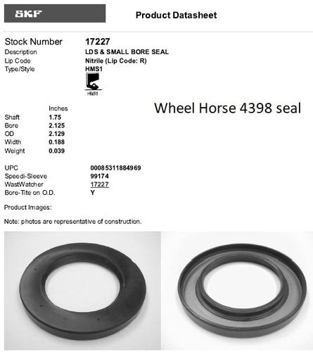

A possible replacement for the Wheel Horse 4398 pto seal used in the PT-5 and 8-3411 pto clutch
Found 17211SB-H-RM
1.750" ID
2.125" OD
.188" deep
Don't know if that is the seal size or bore and shaft dimensions.
Garry
Adding
SKF/Chicago Rawhide or CR 17227 replacement seal for 17211SB
http://www.skfextranet.com/Catalogs/457010/sealdetail.asp?s=17227
