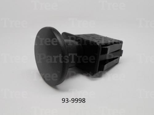

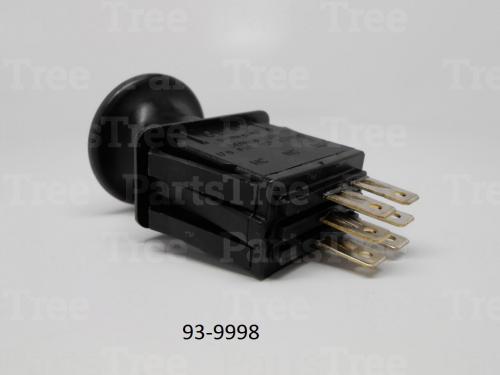

Electric pto clutch switch description
92-6787 replaced by 93-9998
