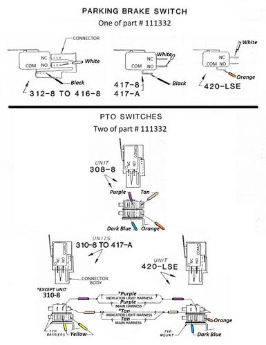

From the #492-4509 Electrical Service Manual

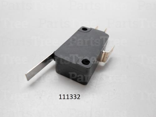

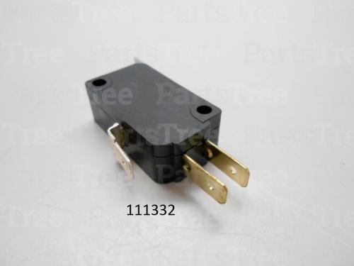

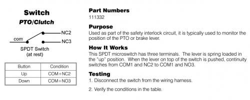

111332 switch

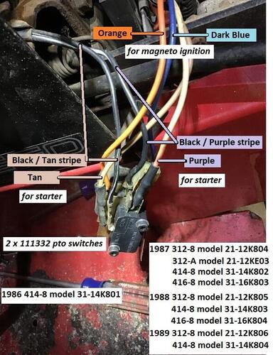

Wiring to switches photo 1987-1989 312, 1987-1988 416, 1989 414

Two used as a pto safety switch and one for the parking brake light
Schematics taken from 1986 300-Series 400-Series IPL SM Wiring

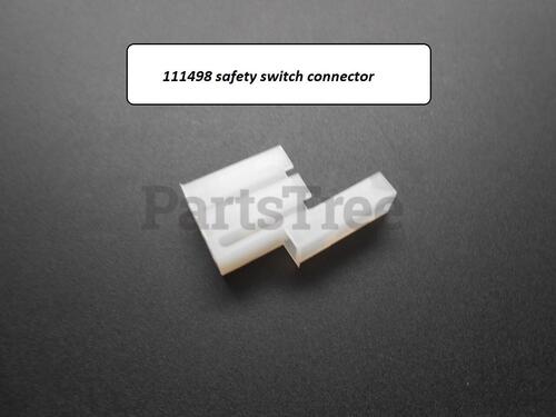

White plastic wire connector part number 111498 for 111332 switches
Also used on the 114240 and 112418 seat switch
