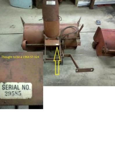

1-stage
Uses # 41 chain (Pitch 1/2" and roller width 1/4")
First model to use cable on the chute
Drive belt 1589 (4L x 56.5" or 1/2" x 56.5")
1964 32in Snowthrower model ST-324
1964 serial numbers that have shown up for the ST-324
A-63040
A-63362 - Model a guess
030240
