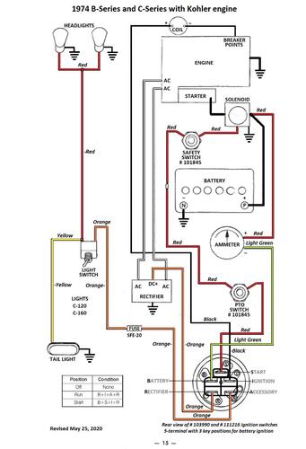

Part 2 of 2 has wiring diagram
11 of 23 pages 3.40MB
Color wiring pdf
1 page 305KB

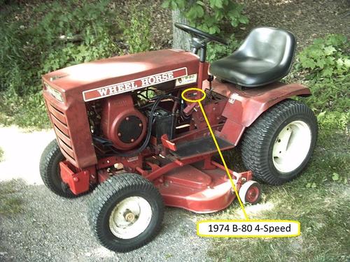

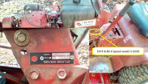

B-80 4-speed model 1-0140 - Suspect this model used 2-piece differential pinion gears in transmission model 5080
1974 serial numbers that have shown up for the 1-0140
0051754 - Model 1-0140-9
0057855 - Model 1-0140-9
0057945
0059617
0059721 - Model 1-0140-9
0059723 - Model 1-0140-9
0059906
0060091
0065106 - Model 1-0140-9
0065183
0067208 - Model 1-0140-9
0067213
0074783
0992883
0993144
0994377
0995104
0997494
1015869
1020587
1020798
1020806
1022014
1022098
1023602
1023711
1023767
1023818
1023858
1023877
1023920
1024044 - Model 1-0140-9
1029105
1029144 - Model 1-0140-9
1029288
1029449 - May be a model 1-0145
103367x - Model 1-0140-9
1038514
1038583
