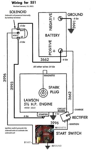

551 Wiring revised pdf
1 page 288KB
Notice the ignition switch grounds the starter solenoid to activate it.

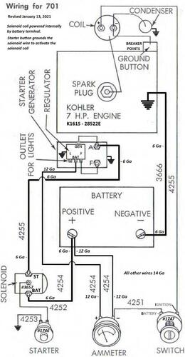

701 Wiring revised pdf
1 page 340KB

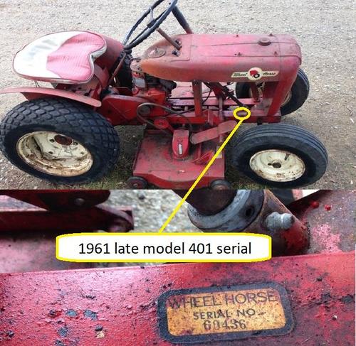

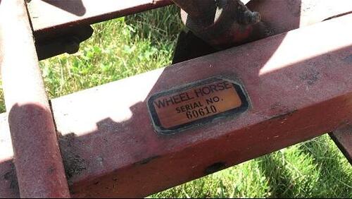

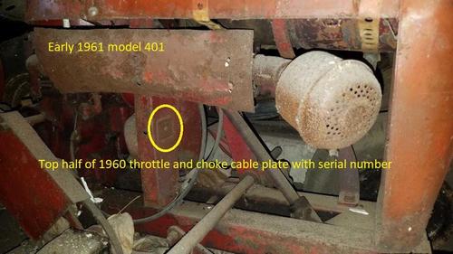

ID plates and serial numbers by CasualObserver
1961 Suburban - early used the top section of the 1960 plate, cut off and screwed to the hood stand.
1961 Suburban - later used a decal on the right frame rail ahead of the foot peg.

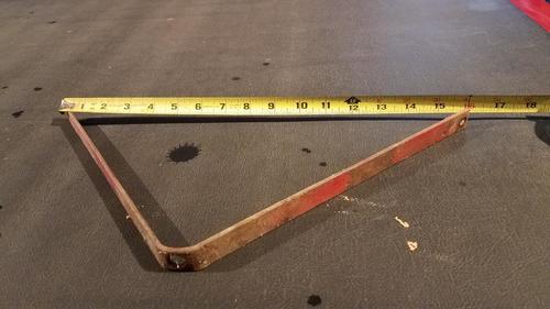

Model 701 only model to use braces on the rear fenders because the tool box was short.

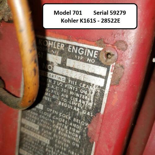

701 used Kohler K161S-28522E. Toro have the engine used as K161S-28622E as used on the 702
3 photos 463KB supplied by CasualObserver for dimensions. Brace not in the parts list.

1961 model 401
1961 serial numbers that have shown up for the 401

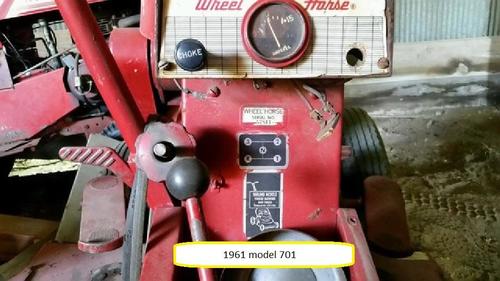

551 frame is 6" wide

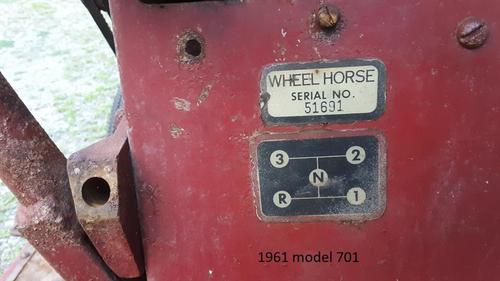

1961 model 701
1961 serial numbers that have shown up for the 701
41724 - May be a 551, misread or typo
