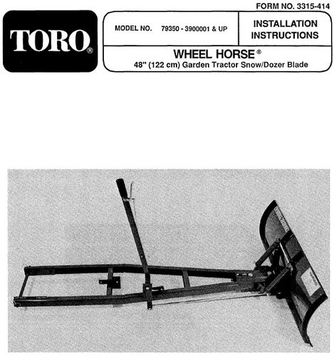

    1981-1984 model 06-42BC02 (Up to here they are 42" wide)
    1984-1989 model 06-48BC01 (They are now 48" wide)
    1990 model 06-48BC02 (Last blade to have 3 angle positions)
    1991-1993 model 06-48BC03 (First blade to have 5 angle positions) - May be identical to 79350 - Model number format change
    1993-2001 model 79350 - (105-1502 kit adapts 2001 and older GT Classic-Series blades to fit 2002 and later tractors - May be identical to 06-48BC03 - Model number format change
                                               1995 may be the first year for the bottom of the blade to have two key-hole slots on each side for optional skids.
    2002 2004-2009 2012 model 79364 - (105-1501 kit adapts 79364 blade to fit 2001 and older GT Classic-Series)

  22. Free
    Blade Dozer 48in 1993-1994 79350 300-Series OM SN.pdf
    Operator manual #3315-414
    8 pages 3.69MB
    Fits long and short frame tractors
    520 models require the 81640 kit because of the swept forward front axle
    Will fit XT-Series - Requires Conversion Kit 106-8256. and Rear Attach-A-Matic Hitch 106-5694 or 107-8490
    1993 Dozer 48in model 79350 Serial 3900001-3999999
    1994 Dozer 48in model 79350 Serial 4900001-4999999
    1994 serial numbers that have shown up for the 79350
    4900203
    4902182
