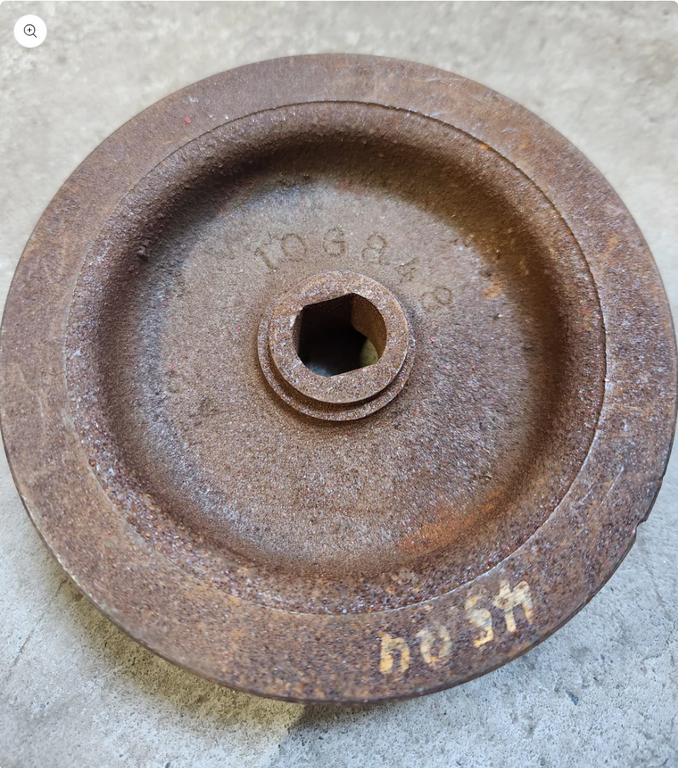

    I am seeking a middle drive pulley for my RL-486 mower deck.  The old part number is: 6756.  The newer part number is: 106848.
    This is off of the 48" deck in the middle position.  It is a double D style shaft pulley.

    is that also the typical double pulley part # 110147 for a 48 inch sd deck?

    Thanks for reaching out.  This is a slightly different part with the double D shaft design.  See picture that I added in the original post.

    I found a local machine shop that made a bushing and then bored my old pulley out and brazed the bushing in place.  Works like a charm now.  I'll see how it holds up in the long run.
