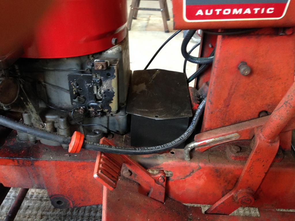

mrshaft696 131 #26 Posted March 5, 2018 I built a battery tray to raise the battery up 3" or so, because it would not fit with this engine in front of the steering shaft. I re-wired everything about 90% & cleaned it all up, snap a pic tomorrow of the final setup... 3 Share this post Link to post Share on other sites

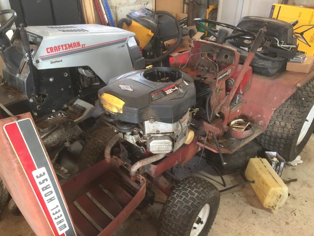

mrshaft696 131 #37 Posted May 21, 2019 so this project is finally taking shape now more than a year later, its been sitting untouched..... So I have finally settled on a 24hp briggs vtwin, which is on the engine stand and for the most part running, pulled the tractor out and cleaned it all off so I can finally start working.... 1 Share this post Link to post Share on other sites

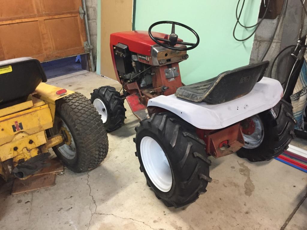

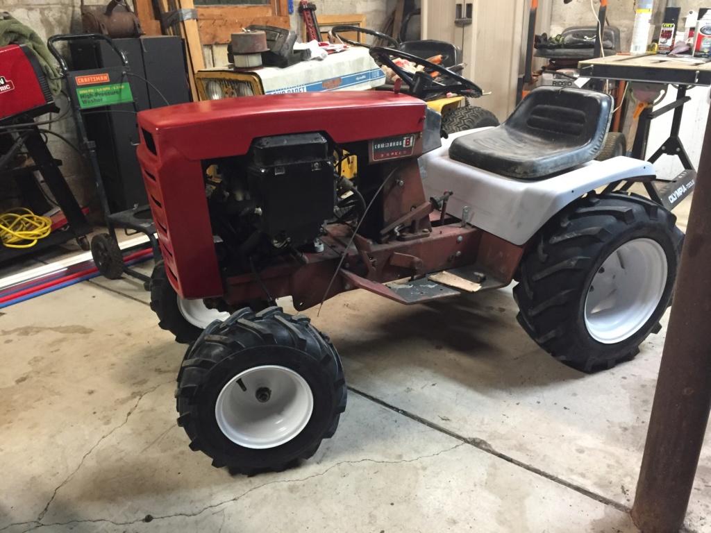

mrshaft696 131 #38 Posted September 23, 2019 I changed my mind allot on this project, but i landed on a 18hp opposed twin briggs to stick in it, cut the hood, and am going to run ag tires all around...... 5 Share this post Link to post Share on other sites

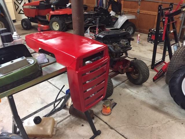

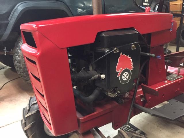

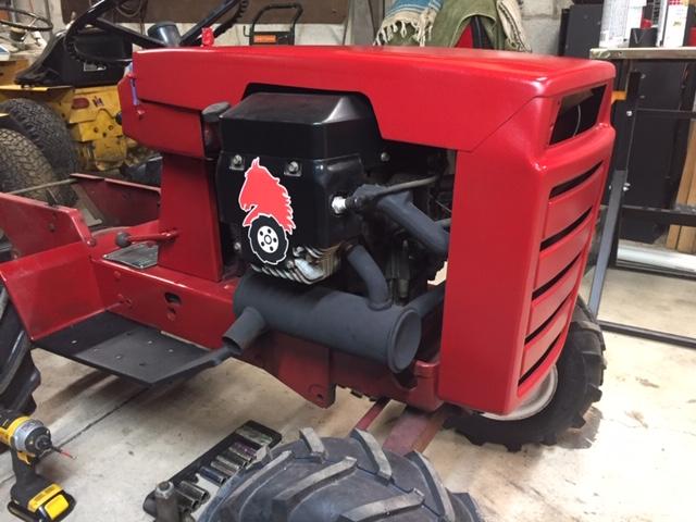

mrshaft696 131 #41 Posted October 8, 2019 (edited) On 10/5/2019 at 7:14 PM, pullstart said: Where have I been on this? Fun stuff here! hah thanks, progress is slow because of how much of a pain painting is. I just have to get the grip tape off the foot boards, paint them and start re assembly. I had to weld a stud for one of the front motor mounts to work because of how close it is to that exhaust cut out, and had to tap a hole on the other side. Edited October 8, 2019 by mrshaft696 1 Share this post Link to post Share on other sites
mrshaft696 131 #42 Posted October 11, 2019 done painting for now, just touching up the foot board, engine is back in, time for re-assembly... 3 Share this post Link to post Share on other sites
mrshaft696 131 #43 Posted October 15, 2019 engine is in permanently, mostly all painted, working on the home stretch..... 1 1 Share this post Link to post Share on other sites

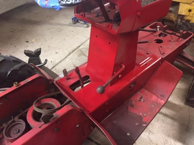

Tractorhead 9,207 #45 Posted October 15, 2019 Real cool, also, because you had a better Gearbox than mine .👍😎 curious what kind of Gearbos this is. how is this called ? 1 Share this post Link to post Share on other sites
mrshaft696 131 #46 Posted October 16, 2019 21 hours ago, Tractorhead said: Real cool, also, because you had a better Gearbox than mine .👍😎 curious what kind of Gearbos this is. how is this called ? To the best of my knowledge it is a 5066 transmission, 3speed with reverse. I has the impossible to replace gear shifter boot seal. Share this post Link to post Share on other sites
Tractorhead 9,207 #47 Posted October 16, 2019 Thanks for Info. why impossible to replace Seal? closer Picts available? Share this post Link to post Share on other sites
mrshaft696 131 #48 Posted October 21, 2019 On 10/16/2019 at 11:31 AM, Tractorhead said: Thanks for Info. why impossible to replace Seal? closer Picts available? I meant the part is no longer available.... I got the diagram on this site where they keep the manuals for the commando v8......I do have pics I can get later.... got my linkages hooked up, some more stuff re assembled. Now have to do the wiring. 2 1 Share this post Link to post Share on other sites

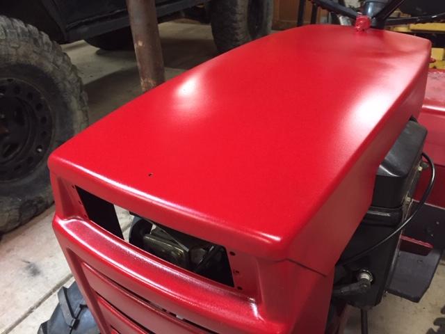

mrshaft696 131 #50 Posted October 23, 2019 (edited) clear coated my paint, got my belt and pulleys all set up... gotta find a headlight or headlight cover, and get wired. Edited October 23, 2019 by mrshaft696 3 Share this post Link to post Share on other sites
