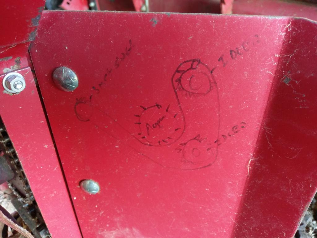

WVHillbilly520H 10,369 #3 Posted February 8, 2018 to Here's a pic of the chain routing, you will need it also recommend doing the same, also it #40 roller chain it's cheaper to buy a roll some half and master links at TSC than a replacement from Toro then you'll have a spare to boot, a chain breaker tool will be helpful as well, Jeff. 2 Share this post Link to post Share on other sites
ACman 7,509 #4 Posted February 8, 2018 (edited) ... you’ll need your model and serial #’s off the blower for Toro parts . You could post them here and probably get more help . A lot of these parts are standard parts . You can get them from TSC or NAPA (chain, bearings, bearing flanges, some sprockets/pulleys) saving you $ over Toro prices if you’re handy . Take the parts you need in with you to match them up and hopefully you get a good parts counter guy that can help you too .....And ! I see @WVHillbilly520H beat me to it ..... Edited February 8, 2018 by ACman 1 1 Share this post Link to post Share on other sites
jag19551 7 #5 Posted February 8, 2018 Thanks for your help guys! This website and the people on it are unbelievable. Thanks for the pic of the chain routing. Looks like a quick trip to TSC should put me back in business before the next snow storm. Our driveway is 400 yards. Having the 520H and the support of the Wheel House Forum has been a lifesaver this past year. Jeff 2 Share this post Link to post Share on other sites
