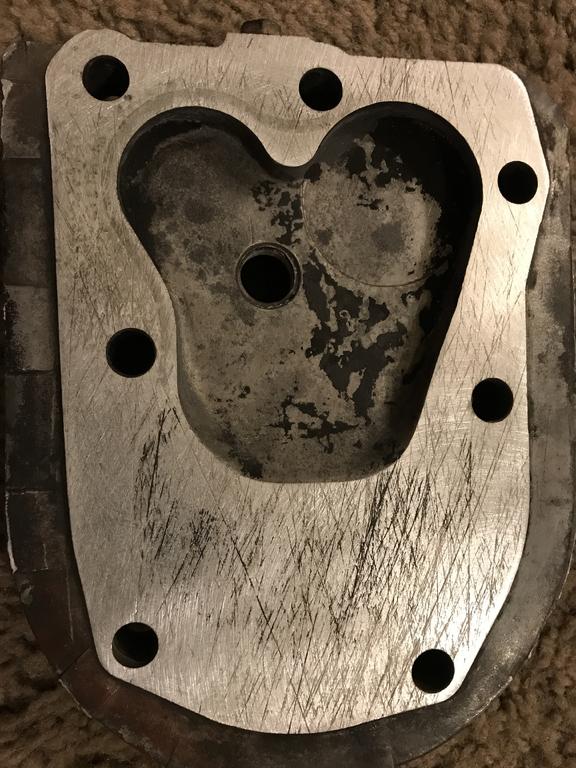

dells68 7,494 #54 Posted January 23, 2018 I tried to surface the K181 head with some 220 wet or dry to remove some of the scaring caused by a mechanic with really rough paper 60 or 80 grit! Got a lot of it out, but I'd have to remove too much material to remove it all. I'm going to give it a try before I look for another head. Might try to scrap a little more carbon from the combustion chamber with a razor - dissolved all I could with oven cleaner - afraid to leave it on too long. 4 Share this post Link to post Share on other sites
WHX?? 46,797 #55 Posted January 23, 2018 Try some Berrymans carb cleaner on it Dells that might help take the carbon off . Dump some in a shallow scrap baking pan from the missus and set it in if it don't fit in the can. As far as the gouges go yer on your own... look pretty deep. Maybe know a machine shop that could surface grind it!? Then some glassing? Might end up with a high compression head which means you might have to get into the pulling business! "Nother tip Dells is a Dremel with a small wire wheel gets in those tight spots. While you got the Dremel out some porting and polishing.... whoops back in the pulling business! 8 1 Share this post Link to post Share on other sites
dells68 7,494 #56 Posted January 23, 2018 Yup, they are pretty deep. I managed to get quite a bit out with 220 wet or dry on a piece of flat glass I have from the back window of a 52 Ford pickup. I've used it before and had good luck getting a flat surface. I'm afraid of removing too much, as I don't want to get into valve clearance issues. I'd be all about raising the compression if I knew I had enough clearance. 1 Share this post Link to post Share on other sites
WHX?? 46,797 #57 Posted January 23, 2018 (edited) Time to bust out the calipers and crunch some numbers then Dells. I think you would be ok .... with some high RPM puller valve springs ......LOL here we go again! Edited January 23, 2018 by WHX14 1 1 Share this post Link to post Share on other sites
ebinmaine 63,153 #58 Posted January 23, 2018 8 hours ago, dells68 said: Yup, they are pretty deep. I managed to get quite a bit out with 220 wet or dry on a piece of flat glass I have from the back window of a 52 Ford pickup. I've used it before and had good luck getting a flat surface. I'm afraid of removing too much, as I don't want to get into valve clearance issues. I'd be all about raising the compression if I knew I had enough clearance. 7 hours ago, WHX14 said: with some high RPM puller valve springs Dells I can't remember what it's called but what about picking up a bit of the stuff engine builders use to physically check the valve clearance in a hand turned engine? Put a glob of it in the head, bolt it on, spin the engine, carefully pull it back apart and use a micrometer to measure the squeezed part. Then use the tight springs to ensure stuff stays where it oughtta. I think you'll find there's some guys that swear by putting sealer on a head gasket and others that would never do it... which tells me you should be able to seal those gouges up without an issue. 3 Share this post Link to post Share on other sites
AMC RULES 36,945 #59 Posted January 23, 2018 (edited) Edited January 23, 2018 by AMC RULES 5 1 Share this post Link to post Share on other sites
dells68 7,494 #60 Posted January 23, 2018 Thanks guys. I had thought about using a speck of Emory's playdough to make sure I still have some valve clearance. Tiny speck on each valve and see how much it is compressed between the valves and head when the engine is rotated. Use what you've got! 5 1 Share this post Link to post Share on other sites
ebinmaine 63,153 #61 Posted January 23, 2018 1 hour ago, dells68 said: Thanks guys. I had thought about using a speck of Emory's playdough to make sure I still have some valve clearance. Tiny speck on each valve and see how much it is compressed between the valves and head when the engine is rotated. Use what you've got! Maybe if I could add to that a bit. If you put a light spray of oil on the piston and valve so that the play dough doesn't stick to either one? 1 Share this post Link to post Share on other sites
WVHillbilly520H 10,369 #62 Posted January 23, 2018 (edited) 9 hours ago, dells68 said: Thanks guys. I had thought about using a speck of Emory's playdough to make sure I still have some valve clearance. Tiny speck on each valve and see how much it is compressed between the valves and head when the engine is rotated. Use what you've got! That's what I used when I built the little SBC in my Malibu, and it did NOT stick to any of the clean parts... Edited January 23, 2018 by WVHillbilly520H 5 Share this post Link to post Share on other sites
Sarge 3,462 #63 Posted January 23, 2018 Been using simple Play-doh for years for checking valve clearances - it's simple, cheap and just plain works. A shot of Fluid Film will prevent it sticking, btw... You can remove a fair amount off those heads, but the trick or question is this - how much did someone remove already ? I know somewhere there is a height measurement on the various Kohler K series heads - it's the total thickness to either top of fins or the spark plug seat, can't remember right now but that is the basis for how much can be removed before the head is scrap or a thicker gasket is needed. A copper head gasket is always another option, although a good used head would be cheaper. Sarge 2 Share this post Link to post Share on other sites

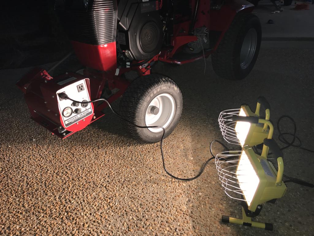

dpriceute 71 #65 Posted January 26, 2018 I tested my new generator tonight. It works! 9 6 Share this post Link to post Share on other sites
PeacemakerJack 10,671 #66 Posted January 26, 2018 Cool setup there for sure My son picked up a "home built" generator with his JackRabbit. Once we have the tractor running, I want to test it and do some organization of the external box, gauge, and wiring. I'm hoping that my local expert @Achto will be able to guide us through this process. I can see a lot of possibilities with it.... 5 Share this post Link to post Share on other sites

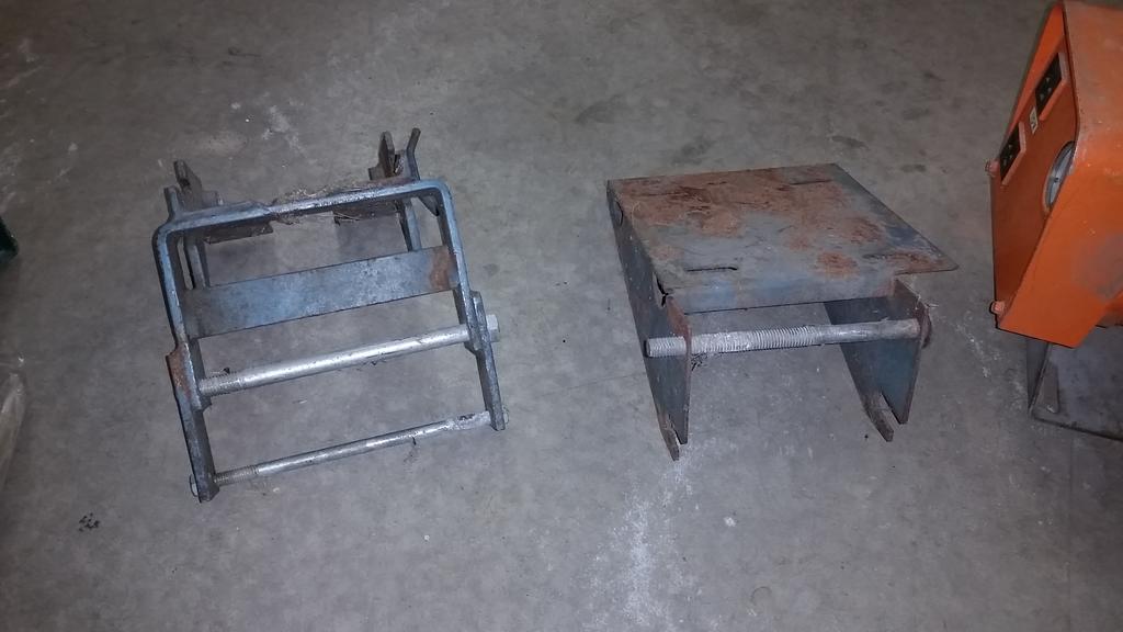

WHX?? 46,797 #72 Posted January 26, 2018 1 hour ago, PeacemakerJack said: One of my local cirle buddies told me that I should use it at plow fishing days for some front end boat anchor weight 38 minutes ago, PeacemakerJack said: that it is more than 30 100 years old. Sorry Josh ...couldn't resist! Actually I do see some possibilities .... a bracket something like these, clean it up, figure out what those gator clips might be for, some rewiring, Biggest problem might be getting that pulley off for internal work & to get it spinning at the correct rpm per Dan's specifications. I'd take a crack at you get that pulley off. Any nameplate for research on it? 3 1 Share this post Link to post Share on other sites
ebinmaine 63,153 #73 Posted January 26, 2018 2 minutes ago, WHX14 said: Sorry Josh ...couldn't resist! Actually I do see some possibilities .... a bracket something like these, clean it up, figure out what those gator clips might be for, some rewiring, Biggest problem might be getting that pulley off for internal work & to get it spinning at the correct rpm per Dan's specifications. I'd take a crack at you get that pulley off. Any nameplate for research on it? I'm on my phone which only has about a two and a half inch wide screen on it so I can't really see those pictures very well until later on today. But I was kind of thinking it was a lot more than 30 years old myself. Not that I'm any kind of an expert on generators. Or alternators. Nope. Not at all. Not even close. 2 Share this post Link to post Share on other sites
Achto 26,566 #74 Posted January 26, 2018 A good clean up, an addition of some exterior out let boxes ( instead of loose cord hanging out of the bottom ), get your mounting figured out. It already has a volt meter, but I would also like to see a frequency meter on it. With these changes I think you'll have a right nice set up Josh 2 2 Share this post Link to post Share on other sites
PeacemakerJack 10,671 #75 Posted January 26, 2018 Thanks Dan for weighing in here! This is your “current” (pun intended) livelihood after all! This is a small potatoes piece compared to the monsters that you are used to dealing with on a daily basis. I can’t wait to brainstorm on this piece with you and I’ll be sure to do a thread elsewhere to follow the progress... regarding age—If I can get the necessary parts to keep it going—I’d rather have something old and reliable than something new that will need to be thrown away in about 5-7 years! If I can’t get parts—I have about a 120# front end weight for plowing! 3 Share this post Link to post Share on other sites
