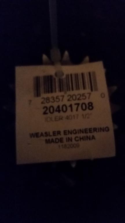

If they have it Jay..stopped yesterday to pick up a roll and the #40 slot empty! :( Also needed two of these they had one :( Got the deer in the headlight look when I asked when they be getting more in! :unsure:
BTW that is the idler sprocket the chain rides on.
