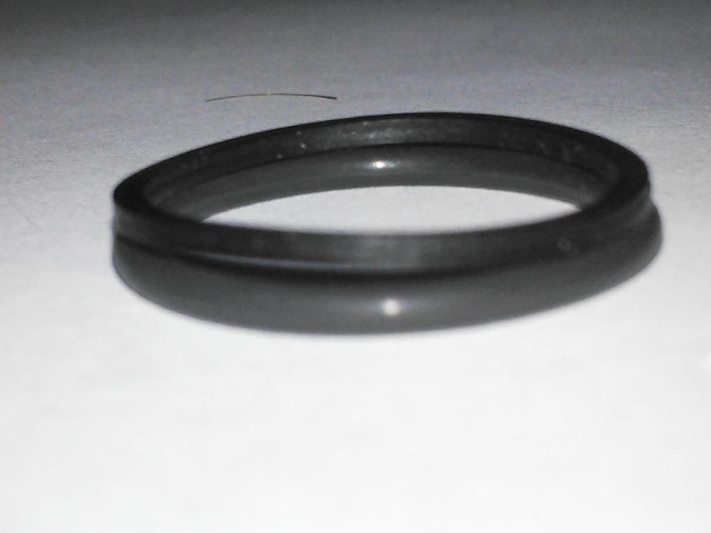

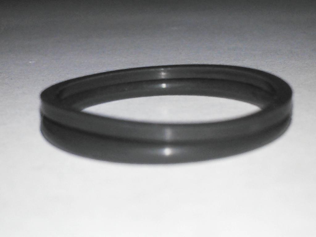

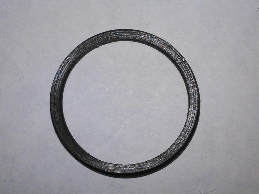

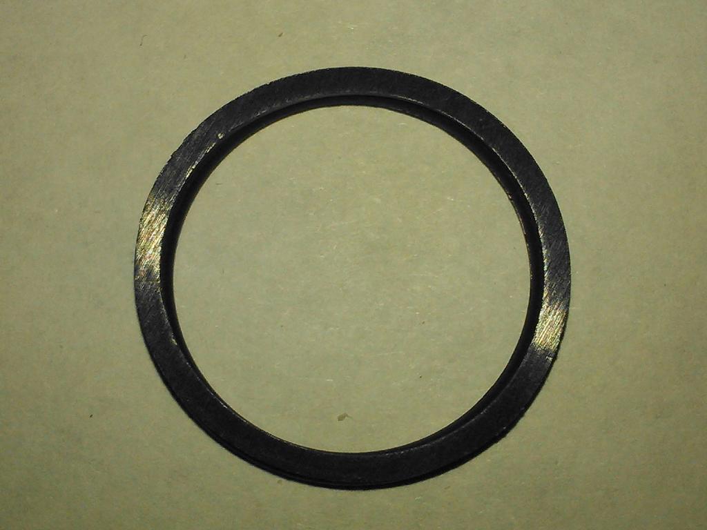

Thought I would share an experiment brought on by boredom and waiting for parts/payday. I found some new very old oem Toro backup o-rings and wanted to compare them to my new o-rings.
Measured them both and found the Toro backups to be 25 thousandths smaller diameter and a lot harder than the new ones. When I put the Toro backup on the new o-ring and
pushed down on them it wanted to roll off and was difficult to keep together. The new backup fit well and was very stable. I could put much more force on them.
The new backup also fit snugly into pump recess while the Toro oem would fall out. I figure the Toro ones may have shrunk over the years.
To measure, I used the highly scientific method of picking them up with my caliper then slowly opening it until they fell out :)
Toro #103184
Viton 90 durometer #018 contoured backup
Viton 70 durometer #018 o-ring
Toro backup on top of new o-ring
New backup on new o-ring
Toro backup side view with what looks like an eyelash in the background.
New backup side view eyelash removed.

Interesting.  Toro didn't make the backer rings (neither did Sundstrand).  Who knows how long ago they bought them and how long they have been sitting on a shelf in some warehouse.
I did some comparison of the o-rings for the Sundstrand hydro pump to manifold set I got from @pfrederi and a fresh set from LJ Fluid Power just for the heck of it and satisfy my own curiosity - exactly the same as far as I could measure them . Durometer appears to be the same as well - I cannot detect any difference in them anywhere id/od/thickness . Older rubber parts will shrink and I suspect it's why some of the older units have a tendency to start weeping a bit with age - new seals stops the problem . Same with axles and crankshafts ,ect - they all shrink over time and get brittle . Add a bit of bearing wear - you'll get a leak for no apparent reason . Waiting on a pair of seals and needle bearings for the D's hydro pump trunnion shafts for the swash plate - this pump decided to leak after I changed the housing gasket , ugh .
