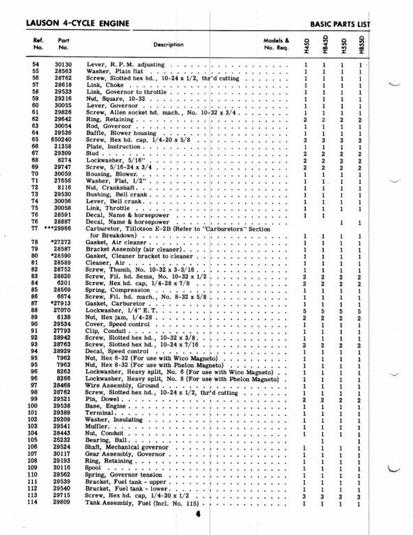

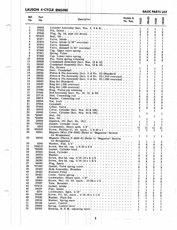

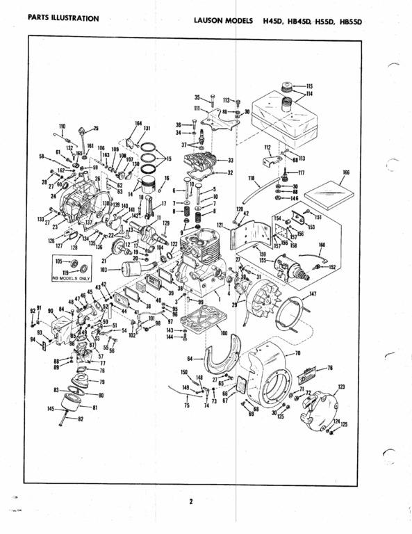

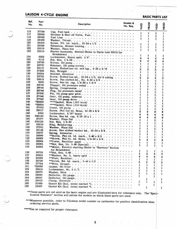

MoreyToo 68 #1 Posted September 17, 2017 I have been searching the RS forums for a parts diagram for my HT55C and have been unsuccessful so far. I can see where other members have ask for the same information but I am not sure if they where successful either. I can find a cutaway of the engine but the part #'s were not included in the post. Does anyone know of a source where I can find this? Any help would be greatly appreciated. Thanks, Randy Share this post Link to post Share on other sites
formariz 12,381 #2 Posted September 18, 2017 Look at post in link below. All of the information you need should be there. Engine internals are the same as for the HT55C as the H55's. The only real differences are engine mounting base and dipsticks. http://www.wheelhorseforum.com/topic/71224-hh55-and-hh60-engines/ 1 1 Share this post Link to post Share on other sites

gwest_ca-(File Mod) 12,451 #4 Posted September 18, 2017 Thanks formariz. Made it into a pdf. Share this post Link to post Share on other sites
formariz 12,381 #5 Posted September 18, 2017 1 hour ago, gwest_ca said: Thanks formariz. Made it into a pdf. You are welcome. Happy to be of help. There is actually quite a bit more I have related to that specific engine including magneto, starter, recoil,Tillotson carb ,etc. I will gather them all up and post it here. Perhaps you can then put it all together. 1 Share this post Link to post Share on other sites
