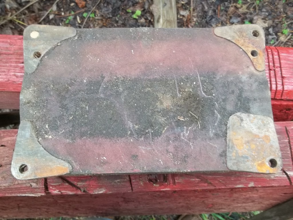

:WRS:     Many pump engines have a tapered crank shaft on the output side. You will need to make a mounting plate or (presuming it is the big block) find an oil sump with mounting holes on the bottom like this one.5980f54004c2b_Jaysoilpan005.JPG.e30ed2b903800a6ad8b3ddee65a1511d.JPG
