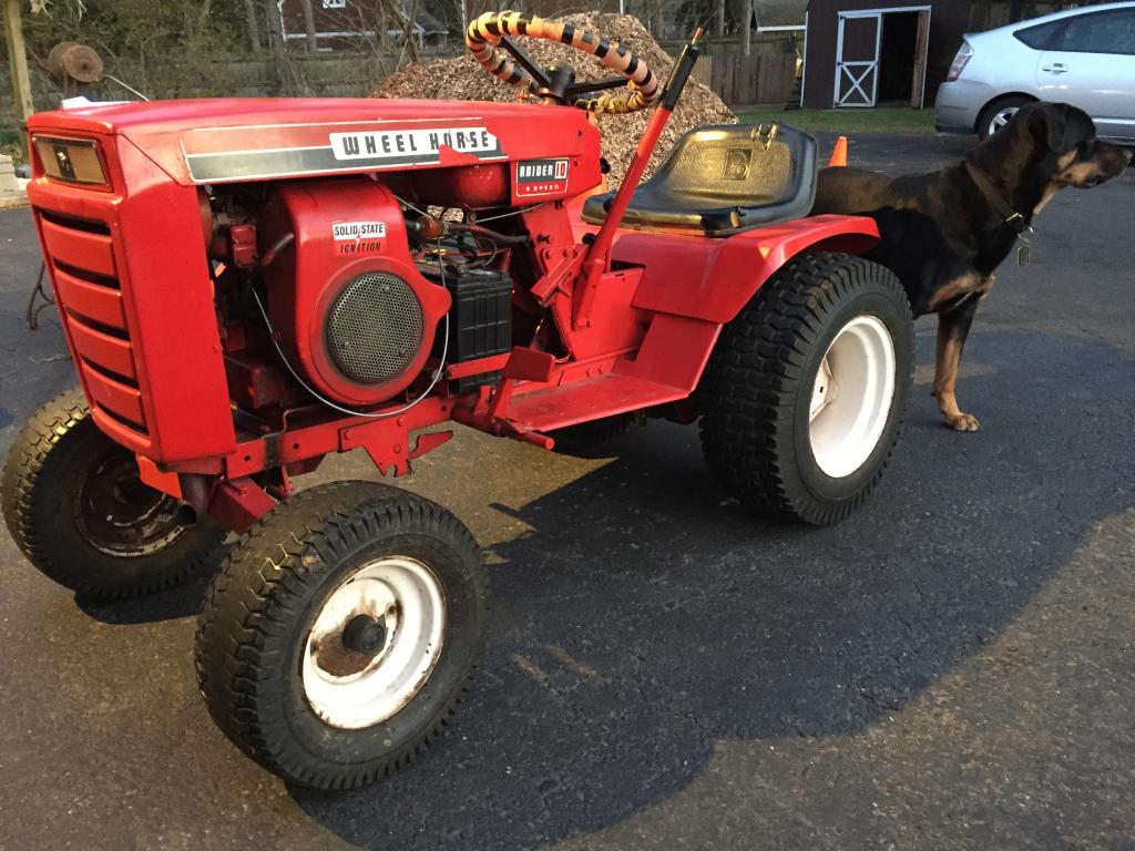

Hi all,
I'm a new member here because today I was gifted this 1970 Raider 10 with Solid State Ignition and Electric PTO from a family friend who had it since new and kept it inside always! I'm beyond thrilled and it's making my holiday happy!
She had some work done on it a couple of years ago and since then it has never run properly. They had replaced the ignition switch, choke cable and throttle cable from what I can tell. She had to fiddle with the ignition switch quite a bit to get it to start, cranking it and then quickly turning it back to run while the engine was turning over before it would start. Well, today when I got it home I dug into the wiring and found that the ignition switch wiring was a mess. The first thing I noticed was that I believe they installed the wrong switch for a magneto system - my clue was the switch had an "I" instead of an "M" terminal. The magneto wire was tied to the Start wire which is why I assume it would crank but not catch while cranking (because it was feeding 12V into the magneto). Then if she switched it to Run while the engine was turning over it would sometimes start. Sheesh. That's what I think was happening but if any of you more experienced folks have an opinion I would love to hear it.
I also noticed that the rectifier was disconnected at the plug - I plugged it back in and assume that it was charging unregulated previously.
After spending time with the forum and manuals here, I rewired the "wrong" ignition switch and then just left the magneto wire off. Garry's post above really put me on the right track. BAM! She started right up and ran nicely. I am able to kill the engine for now by choking it fully.
So here is my question: Rather than acquiring the proper switch which would connect the Magneto wire to ground at Off - can I just install a toggle switch as a Kill switch to connect the magneto to ground when powering down?
Thanks for your help. I'm really looking forward to having some fun with my new Raider!
