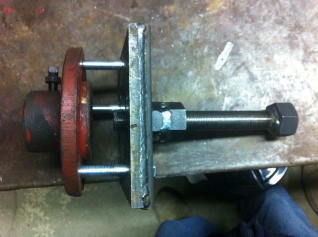

My Super-Whoopie hub puller. I came up with the pieces and a friend of mine welded it. This tool has a special place in my tool box. I picked it up from him when he called to say it was done. Drove home and promptly went to the E.R. Later found out I was having a heart attack all day and didn't know it! :scared-eek:
  Actually, I am planning to make such a puller, I had already cut a pattern piece and marked it and was going through the scrap pile when I found a piece that already had the bolt pattern drilled in a matching pattern. 2001 chevy rear disc brake rotor for a heavy duty one, or possibly a front rotor center for lighter weight. Of course use Squonk's excellent idea for the bolt that pushes on the axle.
 Anyway, it is very likely that a guy who works on brakes will have scrap rotors that will fit the bolt pattern and perhaps save you a little time
