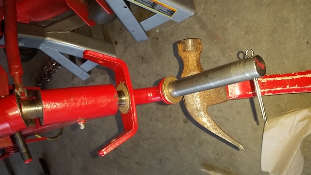

While I was at it I installed bronze washers in the axle pivot and under the spindles to take up some slop and wear.
