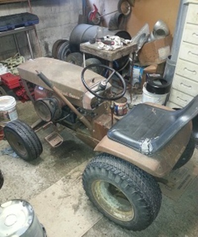

My first post here on RedSquare and I thought I would post about my latest restoration. I picked this little 855 up last winter but I had too much fun playing with it so I'm just now getting around to restoring It! When I bought this thing the shift lever was sitting on the seat, but I figured for $60 I really couldn't go wrong. I brought it home, and split the transmission to look for damage, but it was actually In pretty good shape. I put new needle bearings In the axel housings, along with new seals and a new seal on the brake shaft. Turns out the only reason the shifter pulled out was because the set screw broke.
Anyway I finally decided to pull it into the shop and get It restored before the big Wheel Horse show In June. So far I have it torn down to a rolling chassis except for the blasted steering wheel. I never have luck with steering wheels! Spent the last few evenings working on stripping the paint off the parts I do have torn off.

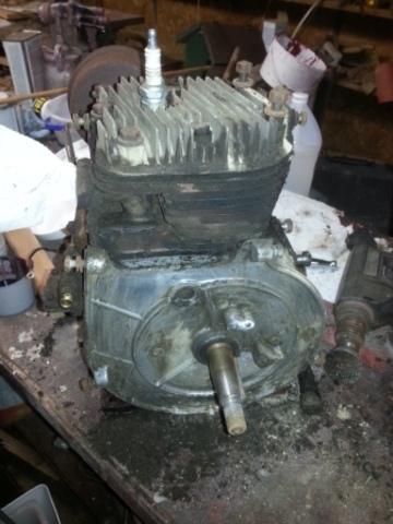

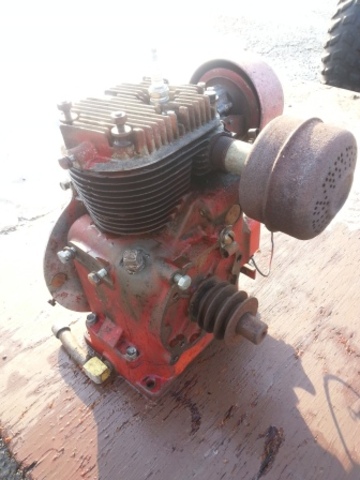

Tonight I took the motor apart. It runs like a champ with no smoke or any bad sounds so I’m just going to put some new gaskets on It and rebuild the carb.

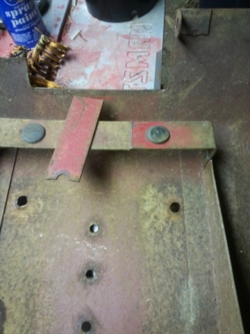

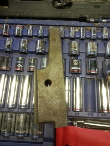

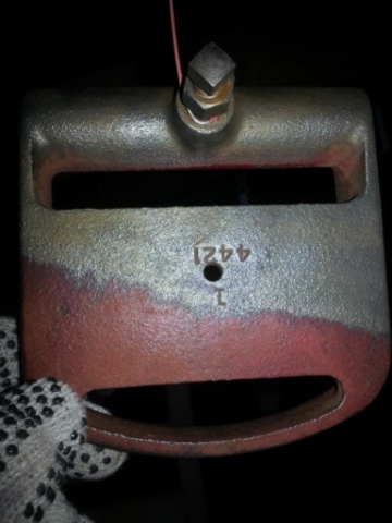

Update: So i saw a thread on here somewhere about soaking parts in apple cider vinegar to make the paint removal process go easier and it worked surprisingly well.
You can see where half of the foot rest was out of the vinegar and the other half was in. I think it worked well. Worked well on the other two parts as well.

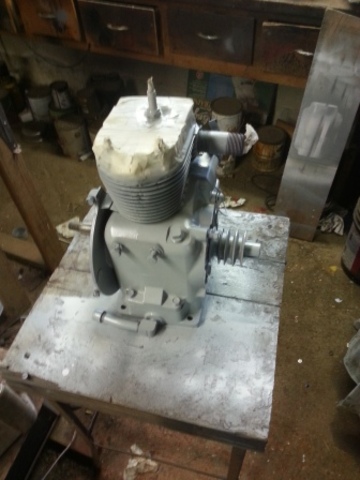

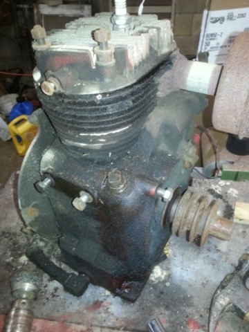

The Kohler ended up being kind of a greaseball so i'm going to spray it with engine degreaser and pressure wash it on a warm day......warm as in above freezing lol! Pulled the flywheel and cleaned it up and sprayed the back with a high heat paint and primed the front. I got quite a few parts cleaned up today and primed with a can. When the weather warms up I will prime them with the gun.

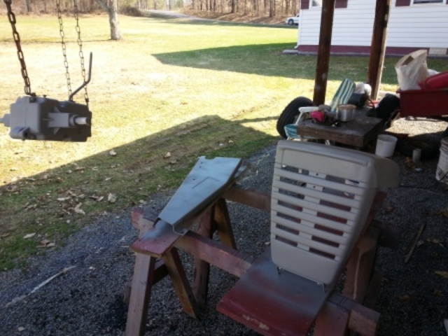

Sorry it's taken so long to put my progress up. I've been sick for a while and haven't done much with it, but i'll give a progress update.
I've pretty much made a mess of the shop. Parts laying everywhere waiting for spring and good painting weather.

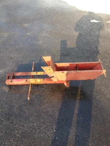

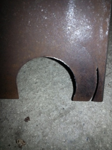

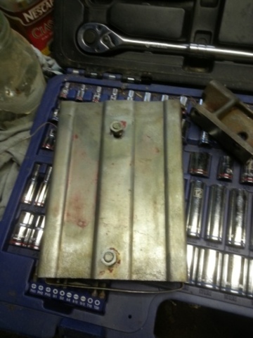

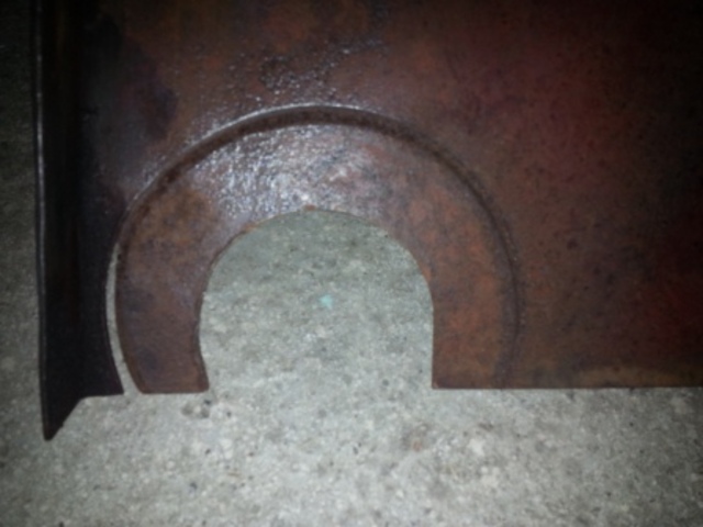

I've had to do some body work. The drive pulley on the tranny was bent (Don't ask me how) and it did this to the drive belt shield. So now i need a new drive pulley. Anyone know if i can get that at an autoparts store. My dad thought it would be difficult getting one since it's a 3/4 inch bore and keyed. Any thoughts would be nice.

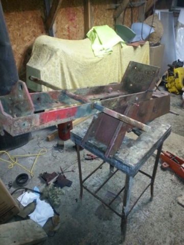

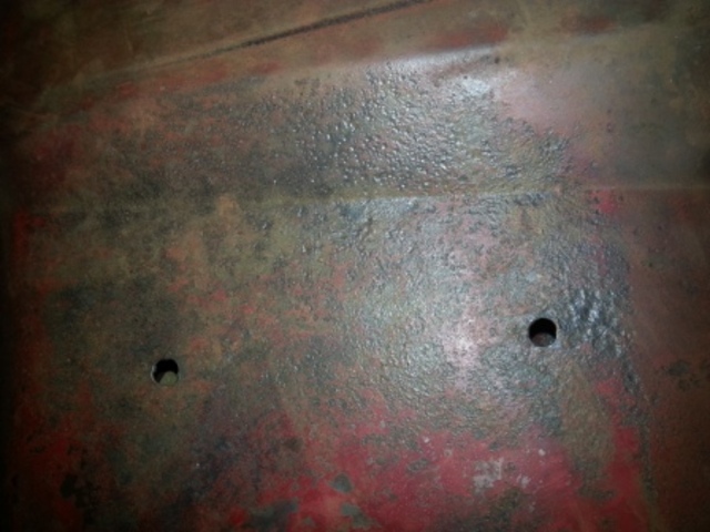

The fenders were pitted under the seat so i got that all patched up.

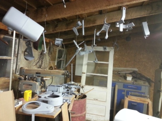

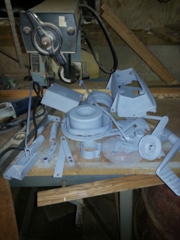

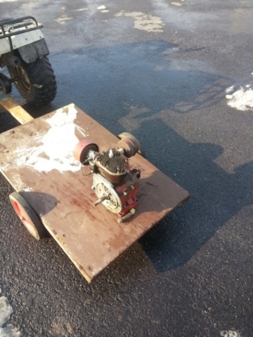

We did have some warmer weather last week. And by warmer i mean above freezing. lol So i was able to finally degrease the engine and wash the frame off before i started working in those.
post-9813-0-03687100-1393445004.jpg post-9813-0-05061000-1393445006.jpg post-9813-0-65320600-1393445007.jpg
So to make myself smile and feel like a serious transition from rust bucket to thing of beauty is happening, I painted the black parts lol.

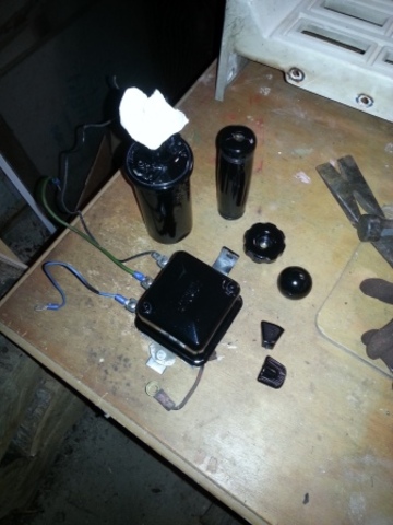

So I was cleaning up some electrical components on this tonight and my cigarette lighter is burned out and so is the wire that goes to it. I want to put a fuse in the line so my question is this. Anyone know what size of fuse I should use?

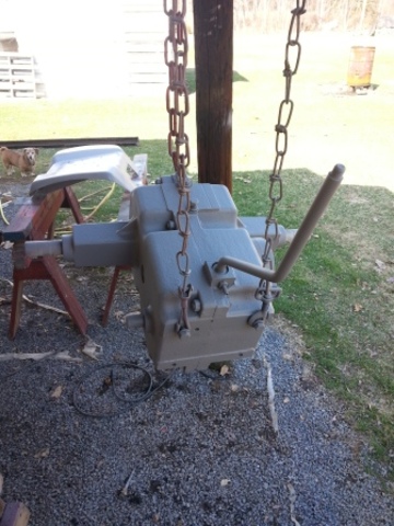

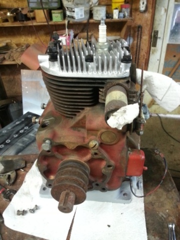

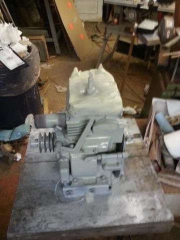

Was able to start putting in the new gaskets on the engine and i put one last oil seal on the drive pulley shaft in the tranny. That being said, i have officially replaced every single seal in that thing lol.
Put a new points gasket on. Then removed the fuel pump to give it a good cleaning. One thing i noticed about that pump is that it is heavy for such a little thing! Modern fuel pumps don't have a thing on this one! Anyway, i primed the fuel pump and put it back on after i cleaned away some of the grease i missed with the pressure washer.
post-42575-0-37249700-1394070093_thumb.j
I moved on to the head to decarbon and clean it. I noticed that someone put rings in this motor at one time or another. Not sure if it's been overhauled....didn't measure the bore. It runs like a champ so i'm not planning on going that far on the engine anyway,,,,just a good cleaning.
post-42575-0-03971200-1394070095_thumb.j
Certainly needed cleaned

Tomorrow it's time to replace the pan gasket as it leaks pretty good around the old one. I also need to stop at autozone for some copper head gasket spray so i can get this head put back on and torqued.

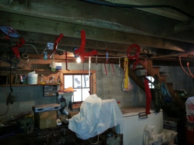

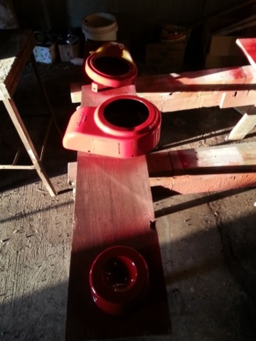

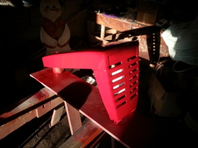

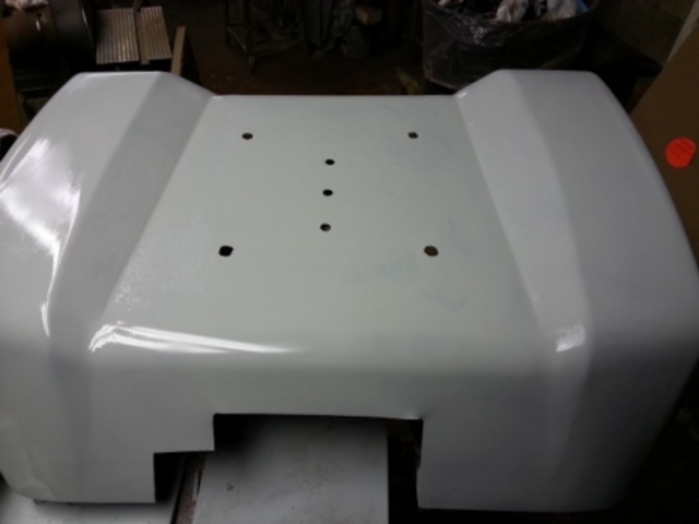

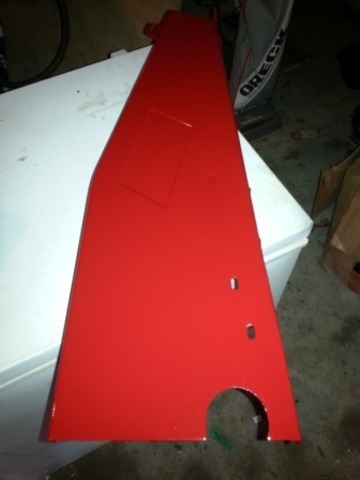

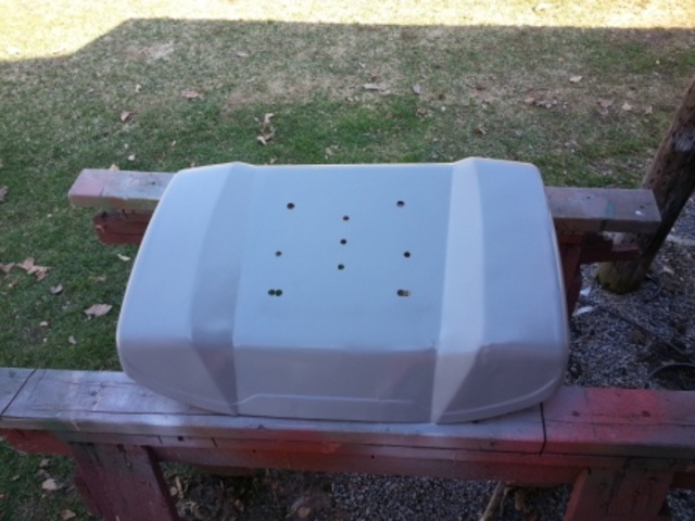

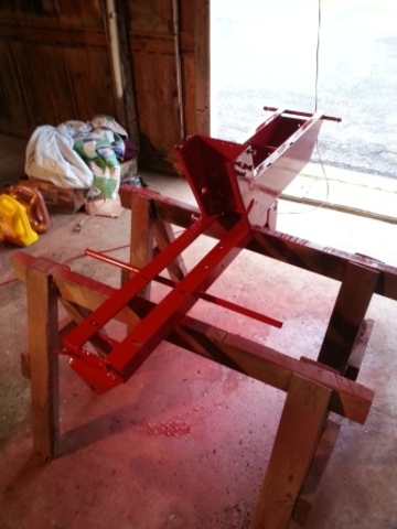

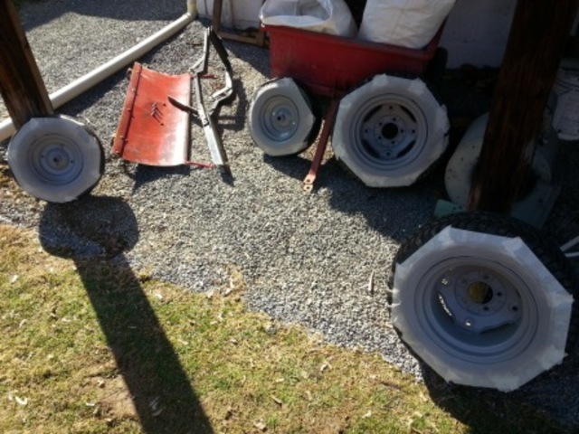

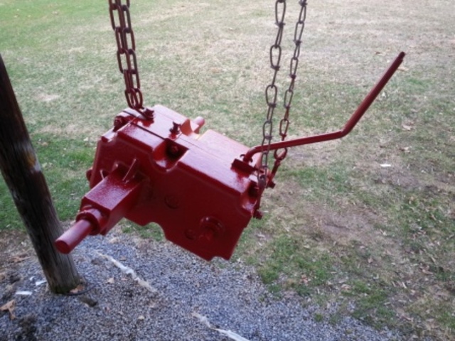

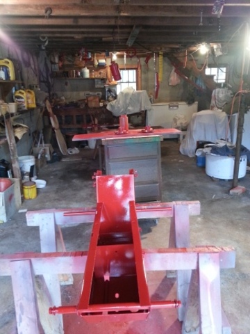

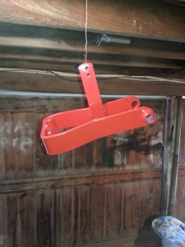

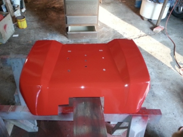

So this past weekend yielded some quality painting time. Primed some bigger pieces like the hood and fenders with the spray gun. And then the Red Paint flew! Have a little more to paint yet like the engine block and some small pieces but i ran out of paint tonight so i'll have to make a trip to the IH dealer this week. Won't be warm enough to finish until Sunday or so. Have to paint the wheels and then it's time to put it back together!
post-9813-0-49914000-1397527547.jpg  post-9813-0-70506700-1397527545.jpg  post-9813-0-10147600-1397527544.jpg

I know the question is going to be asked, so I'll ask. What brand paint/color are you using?
Mike'sHorseBarn
I'm using the IH ironguard brand paint in the IH red color.
