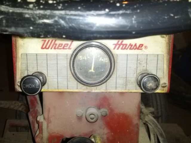

Hi GlenPettit,
This is the original dash panel of my 702 wheel horse tractor. The colour is what you can see.
Now I'm in restoration process and I cleaned it all with water. I will paint it in a few days. When I finish it I will post some photos.

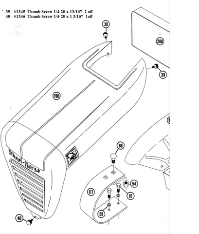

Hi Sergi,
              May be worth starting a new Topic in the 'Euro Horse Forum' to cover the work on your 702.
However, the help you need on the Hood bolts is confusing me. I am not familiar with your model, but  I am happy to try and help you if nobody else can.
Do you require the Hood Thumb Screws ?. On my 702 parts list, the numbers are different to #1271 ....see below-
post-3520-0-20316800-1384890922_thumb.jp
I do not know if they are still available.
If you cannot find them , or have them made in Spain. then maybe I can make them for you and send them out.
I would need a good close picture so that I can make them identical to the original ones......if someone could help with that.
Regards.

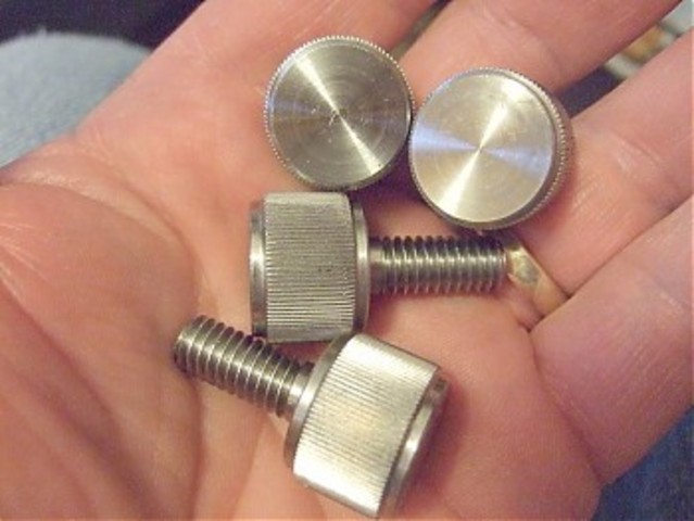

Hi Richard,
The thumb screws that hold the hood are a simple thing to make  they have a knurled top  , i will see if i can get a copy of the ones that i have .
There was a chap that made these & advertised them on Ebay in US
the person that sells the thumb screws here on Redsquare is   Gene -S  .
If you type  Round hood thumb screws in the search bar at the top right of the page it will take you to the thread ,
After those days I have asked for help, I have good news.
I said I knew a guy who could make an exact copy. He has done an amazing job. The thumb screws has been made ​​of stainless steel that will not rust. I put a picture of how they have been after all. Finally I don't need to buy them with this awesome work.
Thank you so much for your fast responses. I'm very happy for that.
I think I can finally finish the restoration in a few weeks. It is a reminder and a tribute to my great-grandfather.
