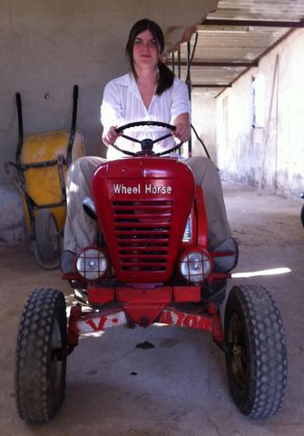

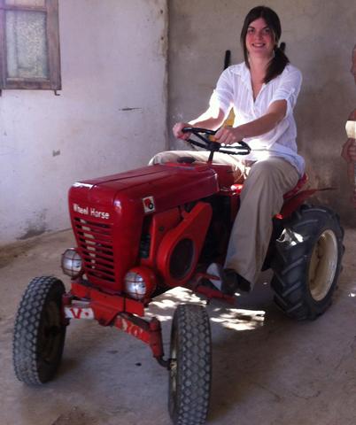

Mi name is Fito from Valencia, Spain. Last week I found this old wheel horse 702 in a town close to me and I couldn´t keep me away from buying it. After 20 year without use, I plugged a new battery, revised oil level, filled the gas tank and it started in two minutes!
It is in very good conditions with all the original parts and no modifications, all users manuals very well conserved. Originally bought in 1966 here in Spain. I am in love with it, also with the girl driving it!
Nice to find other proud owners in Europe!

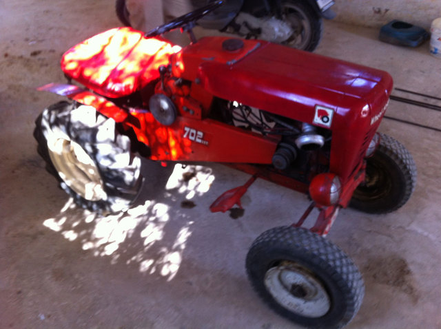

This afternoon I will try to find some parts to start basic tuning:
- Air filter
- New oil
- Sparking plug
- V Belts
- gas pipe replacement
- electric wiring
- I´ve noticed that gas tank has a little leak that must be repaired
- The exhaust pipe is broken (see picture) this will be hard to find here in Spain...
- There is no V belt in hydraulic unit, must find one (does anyone know de dimensions or reference of this V belt?
- Now it´s only running with closed choke, every time I slowly try to open it, the motor stops. Also with closed choke, the motor stops in about one minute. Carburetor adjustment is necessary (is there any tutorial out there on how to do it?)

Returning to the 702, I´ve been doing some work:
The good things:
New air filter
New V belts
New motor oil
New batteries
Tires repaired
New sparking plug
New gas pipe
Gas tank leak repaired
Hydraulic unit leak repaired, new belt and working!
The bad news:
As the problem with carburetor persist, I brought it to a mechanic to clean it. He told me that I need a new one because there is "looseness" inside. =( so it seems that it´s necessary to change the carburetor, and I don´t know how to find one here in Spain. Do you know where to find parts that be able to send it to Spain? I will appreciate any help here =)
The problem:
Motor is only running with closed choke, every time I slowly try to open it, the motor stops. Also with closed choke, the motor stops in about one minute. It´s like there is no suction force to aspire the gas. Do you think that carburetor replacement is the solution?

sounds like lack of fuel - not sure which engine you have, it could be the fuel pump (if it has one) or the jets are blocked in the main needle. There are a few tiny pin holes that can be clogged, they must be clean straight through.
mark
  • Like 1
is the carb getting enough fuel? anyway did you take it apart yourself, or just the mechanic that said scrap it?
