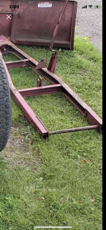

Jose 11 #1 Posted September 10, 2022 Will I need extension kit to fit 520 H 73501 model for this plow? Share this post Link to post Share on other sites
gwest_ca-(File Mod) 11,752 #2 Posted September 10, 2022 Back in the day this was the kit. Check the vendors for someone reproducing it. 1 Share this post Link to post Share on other sites
Jose 11 #3 Posted September 10, 2022 ? Would you happen to know the measurements from the long frame tractor mounting bar to the hydraulic lift bracket? Share this post Link to post Share on other sites
JoeM 8,925 #4 Posted September 10, 2022 The measurements in the photos are taken from the center of the pivot bolt of the blade. Photos shown with the 520 extension in place. 1 Share this post Link to post Share on other sites
