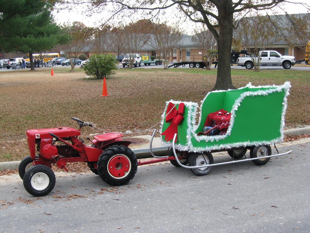

Wild Bill in VA 1,545 #1 Posted September 3, 2022 Years ago, a Wheel Horse dealer make a parade set up using 4 Wheel Horse tractors without drivers to pull a parade float. It consisted of 1 hydro tractor and 3 manual transmission tractors. The steering was mechanically linked together, and the hydro was the only tractor running and thus pulled the manual tractors along with it. I had gone to the dealer who had the set up and tried to purchase all the mechanical parts, but I did not find everything and decided to pass on the sale.. For the local Christmas parade almost 20 years ago I thought that i will just build my own driverless parade unit. I made a test run with a model 753 and some rope controls and thought hey this will work. A model 704 was used due to the 2 spoked steering wheel that the reins (ropes) tied to each steering wheel spoke could easily operate the steering. The starting and stopping was controlled by a lever operated cable that pulled the clutch brake pedal from the back downward. The clutch had to help back with the level, and I had to shift into second gear and leave in gear. And yes, there was a safety cut off switch wired in just in case something happens. The sleigh was built on top of my 4 wheeled wagon. I drove this set up for 2-1/2 hours during the parade and received many remarks from kids who thought it was magic that there was no driver on the tractor, women who thought it was romantic and wanted a to ride in the sleigh and men that said, "That guy is good". Wild Bill in Richmond VA 3 2 1 9 Share this post Link to post Share on other sites

hcminis 1,710 #9 Posted September 4, 2022 18 hours ago, Wild Bill in VA said: Years ago, a Wheel Horse dealer make a parade set up using 4 Wheel Horse tractors without drivers to pull a parade float. It consisted of 1 hydro tractor and 3 manual transmission tractors. The steering was mechanically linked together, and the hydro was the only tractor running and thus pulled the manual tractors along with it. I had gone to the dealer who had the set up and tried to purchase all the mechanical parts, but I did not find everything and decided to pass on the sale.. For the local Christmas parade almost 20 years ago I thought that i will just build my own driverless parade unit. I made a test run with a model 753 and some rope controls and thought hey this will work. A model 704 was used due to the 2 spoked steering wheel that the reins (ropes) tied to each steering wheel spoke could easily operate the steering. The starting and stopping was controlled by a lever operated cable that pulled the clutch brake pedal from the back downward. The clutch had to help back with the level, and I had to shift into second gear and leave in gear. And yes, there was a safety cut off switch wired in just in case something happens. The sleigh was built on top of my 4 wheeled wagon. I drove this set up for 2-1/2 hours during the parade and received many remarks from kids who thought it was magic that there was no driver on the tractor, women who thought it was romantic and wanted a to ride in the sleigh and men that said, "That guy is good". Wild Bill in Richmond VA Wild Bill Believe you are talking about the stage coach hook that I currently own. Was allowed to get the setup from the old Franklin, IL dealer several years ago. Unfortunately the stage coach that was on a 4-whee wagon was destroyed from being left outside. Have a YouTube video that I will try to link for you to view https://youtu.be/zAaeTlgBYwU 3 5 Share this post Link to post Share on other sites
