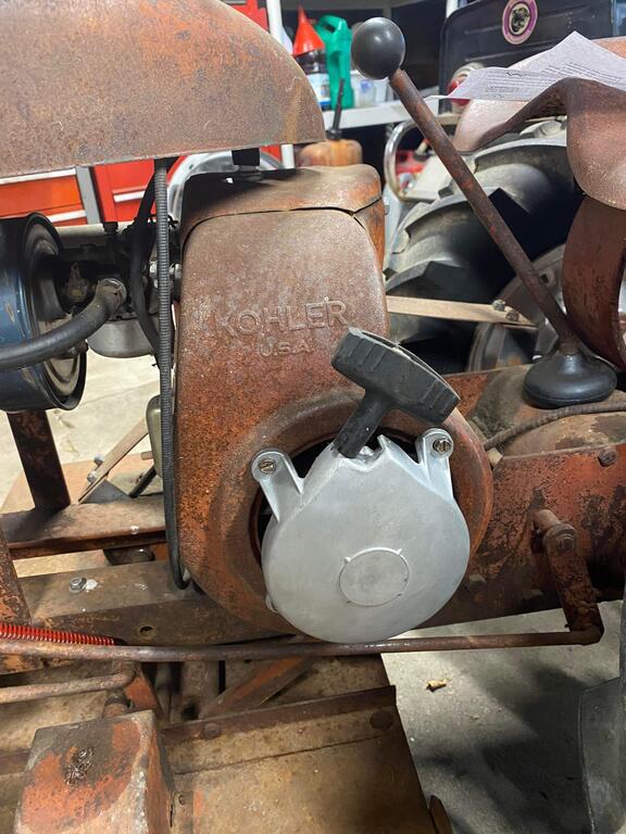

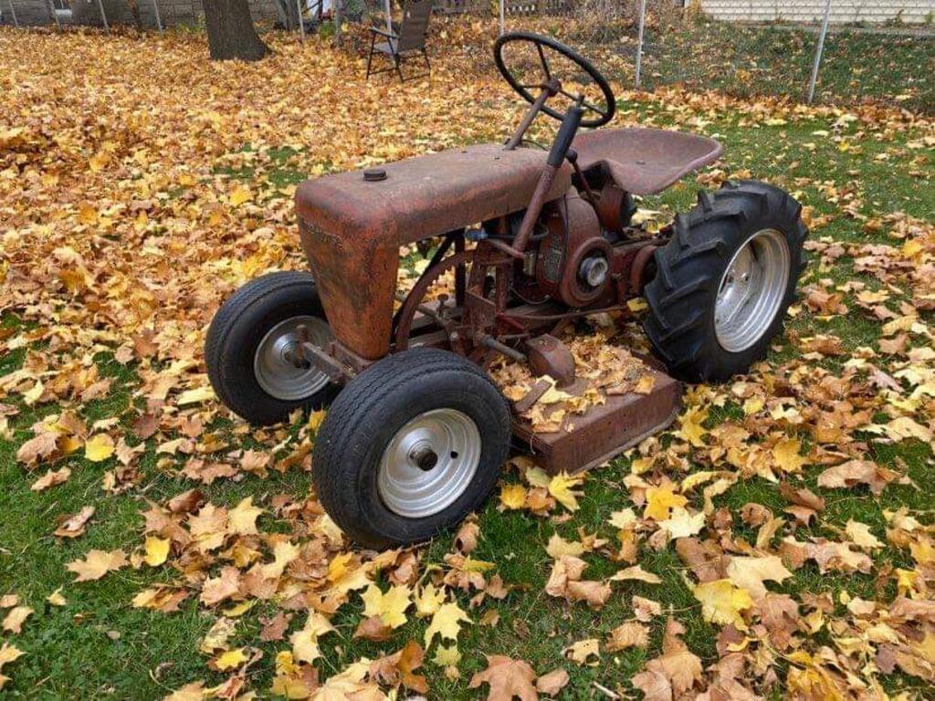

Laplantebd 92 #43 Posted November 13, 2022 (edited) The RJ had leaf mulching duty yesterday and did very well. Ready to go into hibernation now. Over the winter I will rebuild the carb and repaint the seat and wheels factory white. Also have some proper tires for the front. Edit: I almost forgot I found a NOS Fairbanks Morse recoil for it. No more wrapping a rope around the cup to start it. Edited November 13, 2022 by Laplantebd 1 1 Share this post Link to post Share on other sites
