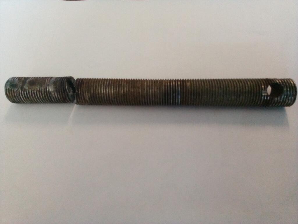

Forrest Carver 52 #1 Posted September 2, 2022 Grading my driveway with a snow/dozer blade yesterday, I managed to snap an index pin (part #103498). This is the pin that locks the blade in left, center, or right position. The blade is pretty useless without it, although I'm sure there are several other ways to secure it in place. I'm not sure this pin was supposed to be threaded, but mine is. Based on the cotter pin hole being slightly off-center, it looks to me like the original owner had snapped the original index pin and replaced it with this homemade one. I aim to do the same, unless anyone happens to have one they could sell me. I could also use an assembly lift rod, #39 on the exploded view and original part number 103015, if anyone has it. But it's kind of an odd piece and the need is not dire. EV: https://www.partstree.com/models/06-59bx01-toro-59-snow-dozer-blade-1980/snow-dozer-blade-56-in-142-cm-2/ Share this post Link to post Share on other sites

Achto 31,133 #3 Posted September 2, 2022 (edited) 43 minutes ago, Forrest Carver said: it looks to me like the original owner had snapped the original index pin and replaced it with this homemade one. I aim to do the same That pin was made from a piece of ready rod. Ready rod is a really soft metal and I would not suggest using it again. If you make it out of a piece of cold rolled round stock of the correct diameter, it should out last the life of the plow. Edited September 2, 2022 by Achto 3 Share this post Link to post Share on other sites
Forrest Carver 52 #4 Posted September 2, 2022 (edited) Thanks. I actually wound up finding a 6" 5/8 bolt which I plan to drill a hole in for the index rods and cotter pin. It's only grade 5...hopefully that's strong enough. If not, I'll just order some grade 8 rod from Mcmaster-Carr. It makes perfect sense that this was homemade, now. Before starting to grade, I tested the blade tilt adjustment and the blade wound up getting stuck in the rightward position because the index pin was still too long even fully retracted. It took about 2 hours and a stroke of dumb luck to get it to finally release. So perhaps the breakage was fortuitous...now I'll be able to change blade positions without dread Edited September 2, 2022 by Forrest Carver 2 Share this post Link to post Share on other sites
