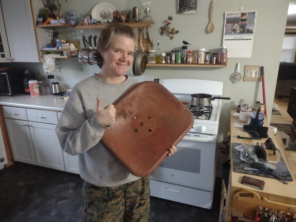

ebinmaine 81,289 #27 Posted January 6, 2023 Got a neat package delivered yesterday. PERFECT fit !! Thanks @Rob J. !! 2 2 8 1 Share this post Link to post Share on other sites
Handy Don 17,740 #28 Posted January 6, 2023 (edited) Nice seat in great condition. The not-period one that was on there was ready for the scrap pile, for sure! Edited January 6, 2023 by Handy Don 3 Share this post Link to post Share on other sites

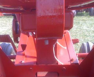

squonk 48,429 #40 Posted January 7, 2023 You can see the seat spacer made out of tubing on my 704 I used to have. 1 1 Share this post Link to post Share on other sites

Handy Don 17,740 #43 Posted January 7, 2023 4 hours ago, squonk said: You can see the seat spacer made out of tubing on my 704 I used to have. At first I was confused but realized there is a bracket going up to a seatback and other brackets going to armrests? It looks like 1.5 x 4+” tubing with a closure weled/glued into it (or maybe two smaller tubes welded side by side--the angle prevents a good view. Did you run long bolts through the seat/armrest bracket/tube/backrest bracket/spring or attach bits separately? How did you handle the ridges on the bottom of the seat that normally straddle the spring to keep it from twisting? 1 Share this post Link to post Share on other sites
squonk 48,429 #44 Posted January 8, 2023 6 hours ago, Handy Don said: At first I was confused but realized there is a bracket going up to a seatback and other brackets going to armrests? It looks like 1.5 x 4+” tubing with a closure weled/glued into it (or maybe two smaller tubes welded side by side--the angle prevents a good view. Did you run long bolts through the seat/armrest bracket/tube/backrest bracket/spring or attach bits separately? How did you handle the ridges on the bottom of the seat that normally straddle the spring to keep it from twisting? Used a longer bolt. The spacer had 2 weld beads that locked into the seat ridges to prevent twisting. 1 1 Share this post Link to post Share on other sites
