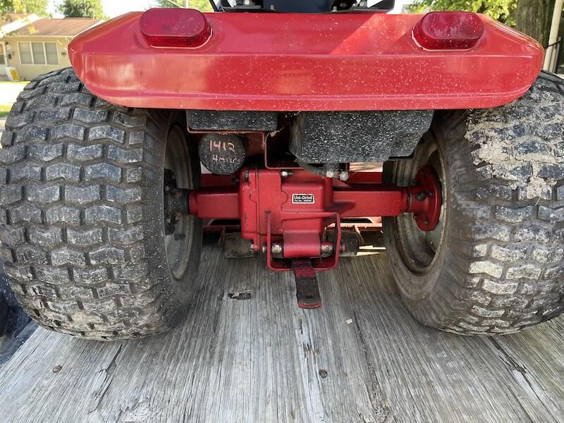

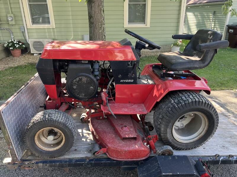

MilanWH 26 #1 Posted August 30, 2022 I'm new here, and wanted to say what a helpful sight this is! I bought a 416-8 about 2 years ago. It was cheap, and I really like the Kohler singles. I've owned several gravely walk behinds with them and all were great. Anyway, the 416 has been fine, but when I bought it, the 42" deck was rusted through in several places.It has been cutting fine, but I've been on the lookout for a nice deck. I saw an add on Facebook for what was described as a near new lightly used wheel horse for cheap, not running, so I had to check it out. I brought it home for $250 thinking the deck is great, been resprayed, but very solid. The tractor has a 16hp Kohler on it so I figured I can part it out, and keep the deck basically for free.Problem is, I don't know what this thing is. Any help you could give would be much appreciated. ACBC9975-F07B-4324-99EE-96C4A8CD2B76.heic DABFA816-423A-4A95-9016-7D0F4D4CDBA5.heic 217DA7F7-54E0-4B9F-BAA7-83FE020F6E47.heic 19E3FE03-A908-46B5-B152-B8A49B723EBA.heic 5D8EF247-3771-44C9-B1B1-59BA51E58398.heic F9CDD6BA-54F0-4230-83BD-E0EA8540E708.heic Share this post Link to post Share on other sites

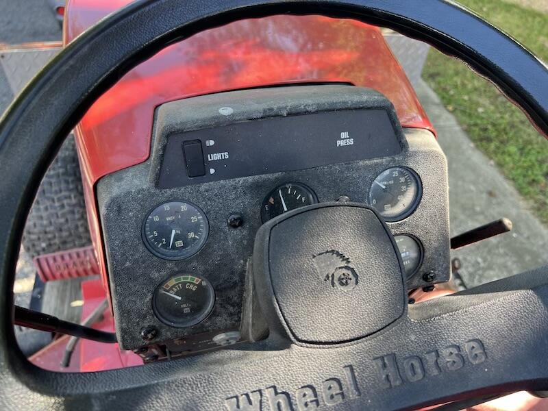

MilanWH 26 #4 Posted August 30, 2022 I think it might be a Frankenstein, the dash has an oil pressure gauge, doesn't make much sense on a Kohler. Unless it's for the hydro trans pressure. Share this post Link to post Share on other sites

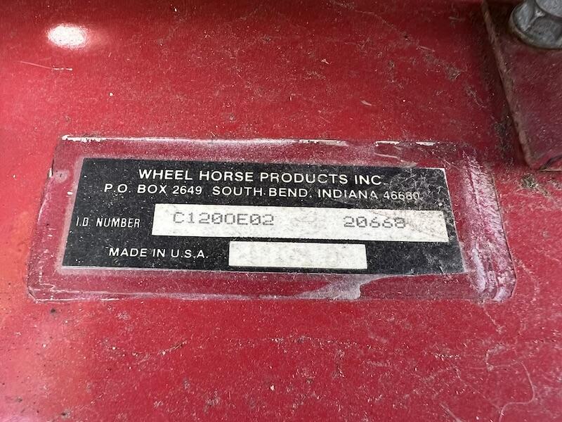

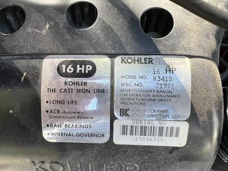

MilanWH 26 #6 Posted August 30, 2022 My mistake, oil pressure light, no gauge. It has a fuel level gauge, RPM gauge, battery charge and vacuum.The Kohler tag says model k341s, spec 71371. Share this post Link to post Share on other sites
gwest_ca-(File Mod) 12,070 #12 Posted August 30, 2022 Welcome to Red Square. The 71371 spec number was used in the 1985 416-8 model 31-16K801 8-speeed model. Here is what we have on this model - 23 files https://www.wheelhorseforum.com/search/?q=31-16k801&quick=1&type=downloads_file The C1-20OE02 is a 1989 520-HC which is a hydro transmission model. Suspect the above engine was a repower and a good choice at that. Here is what we have on the 520-HC - 29 files https://www.wheelhorseforum.com/search/?&q=c1-20oe02&type=downloads_file&search_and_or=or&sortby=relevancy Share this post Link to post Share on other sites
MilanWH 26 #13 Posted August 30, 2022 Thank you so much. You say a good choice, is it possible to make the tach work with this repower? It hasn't been completed yet. Also, would it be better if I swapped this Kohler with the magnum in my other tractor? Is the magnum much better, or just minor differences? Share this post Link to post Share on other sites
MilanWH 26 #14 Posted August 30, 2022 Also is the hood correct for a 520hc? Share this post Link to post Share on other sites
TJ5208 1,841 #15 Posted August 30, 2022 (edited) Yes the hood is correct. I'm going to say its a 520. Edited August 30, 2022 by TJ Salyers Share this post Link to post Share on other sites

bds1984 1,506 #18 Posted August 31, 2022 You can definitely make the tachometer work on this engine. I have a 520 tachometer connected to the K341 that resides in my C165. Of course you will have the power wires connected to the tachometer, the signal wire of the tach will be connected to either of the two outside terminals on the voltage regulator; the tach runs off the a/c output from the stator which is the two outside wires on the regulator, the middle wire is the DC output to charge the battery. 2 Share this post Link to post Share on other sites
Handy Don 16,062 #19 Posted August 31, 2022 14 minutes ago, bds1984 said: You can definitely make the tachometer work on this engine. I have a 520 tachometer connected to the K341 that resides in my C165. Of course you will have the power wires connected to the tachometer, the signal wire of the tach will be connected to either of the two outside terminals on the voltage regulator; the tach runs off the a/c output from the stator which is the two outside wires on the regulator, the middle wire is the DC output to charge the battery. Interesting. I just did some research and both engines have 18-pole stators so the tach will read correctly! Added bold above to emphasize that the tach will have a power input (pink wire, usually) and a sensor input (gray wire, usually). It is the sensor wire that gets connected one of the outside terminals of the voltage regulator. Also be sure the tach's ground connection is solid and clean. 1 Share this post Link to post Share on other sites

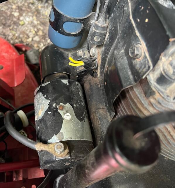

MilanWH 26 #22 Posted September 3, 2022 Success! I fiddled with the wiring and got the 520 to start and run. Now I need to figure out what I'm missing in the charging system, and how to properly attach the throttle and choke cables. These 2 wires are all I have to work with, there is no regulator that I can see. Are regulators still available? Maybe at N.A.P.A.? Does anyone know a part number? Any help would be great! Thanks. Share this post Link to post Share on other sites
ebinmaine 77,825 #23 Posted September 3, 2022 3 minutes ago, MilanWH said: Success! I fiddled with the wiring and got the 520 to start and run. Woohoo!!! There were 2 charging systems available for those 16 HP engines. One was a 15 amp. The other a 3 amp. The 15 amp system could perhaps be wired as a mid 70s C160? I'm not familiar with the differences in wiring on the 3 amp. Also not familiar with the 520 system. Others may chime in here. 1 Share this post Link to post Share on other sites
bds1984 1,506 #24 Posted September 3, 2022 54 minutes ago, MilanWH said: Success! I fiddled with the wiring and got the 520 to start and run. Now I need to figure out what I'm missing in the charging system, and how to properly attach the throttle and choke cables. These 2 wires are all I have to work with, there is no regulator that I can see. Are regulators still available? Maybe at N.A.P.A.? Does anyone know a part number? Any help would be great! Thanks. Those two yellow wires may be from the stator plate. If that is the case, you should be able to connect them to the a/c terminals on a generic voltage regulator. One way you could test them is to use a multimeter on an a/c setting on the wires as the engine is running and test what the voltage output is. It has been a while since I've came in contact with the 3 amp charging system so I don't 100% remember the wire schematic of it but I think it will only have a single wire coming from a diode after the stator wire output. Share this post Link to post Share on other sites
