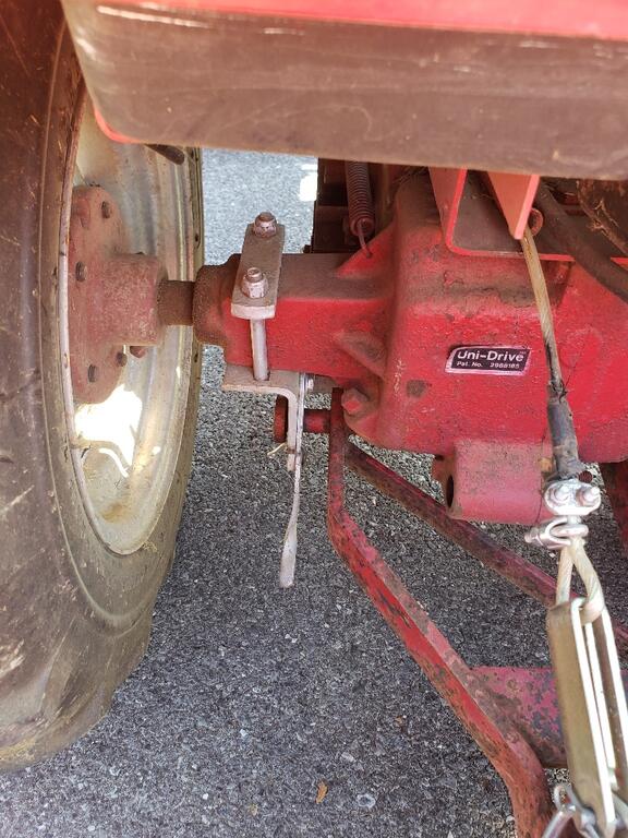

Hampton 95 #1 Posted August 29, 2022 These are the ones on Wheel Horse Parts and More. Are these the ones I need? for the tiller? 1 Share this post Link to post Share on other sites

peter lena 9,782 #4 Posted August 29, 2022 @Hampton that hitch is for a plow blade / frame set up , don,t think it has anything to do with tiller , look this up , pete 1 Share this post Link to post Share on other sites
Hampton 95 #5 Posted August 30, 2022 This is what was on the sellers 312-8 for the tiller. 1 1 Share this post Link to post Share on other sites
Hampton 95 #6 Posted August 30, 2022 (edited) The photo in the first post is listed under tiller parts. I'll give them a call tomorrow. Edited August 30, 2022 by Hampton 1 Share this post Link to post Share on other sites
Thor27 853 #7 Posted August 30, 2022 That is the bracket 1 Share this post Link to post Share on other sites
Hampton 95 #8 Posted August 30, 2022 20 minutes ago, Thor27 said: That is the bracket It seems to be a dual purpose bracket for a tiller and snow plow. The middle bar is a spacer to attach it correctly. Again, I'll give them a call. Share this post Link to post Share on other sites
peter lena 9,782 #9 Posted August 30, 2022 @Hampton sorry to give you incorrect info on the bracket, had only seen that bracket used on the plow set up , but that simple easy hook up for the tiller is right there , never seen one , BTW do a thorough lubrication service on the tiller , before use , probably over due . pete 1 Share this post Link to post Share on other sites
clueless 3,348 #10 Posted August 30, 2022 (edited) The picture of the hitch you posted is the right one for the tiller. That one actually has the top angle iron on the left for the assist spring to hook to, most new and old hitches don't come with that piece. Edited August 31, 2022 by clueless Share this post Link to post Share on other sites
