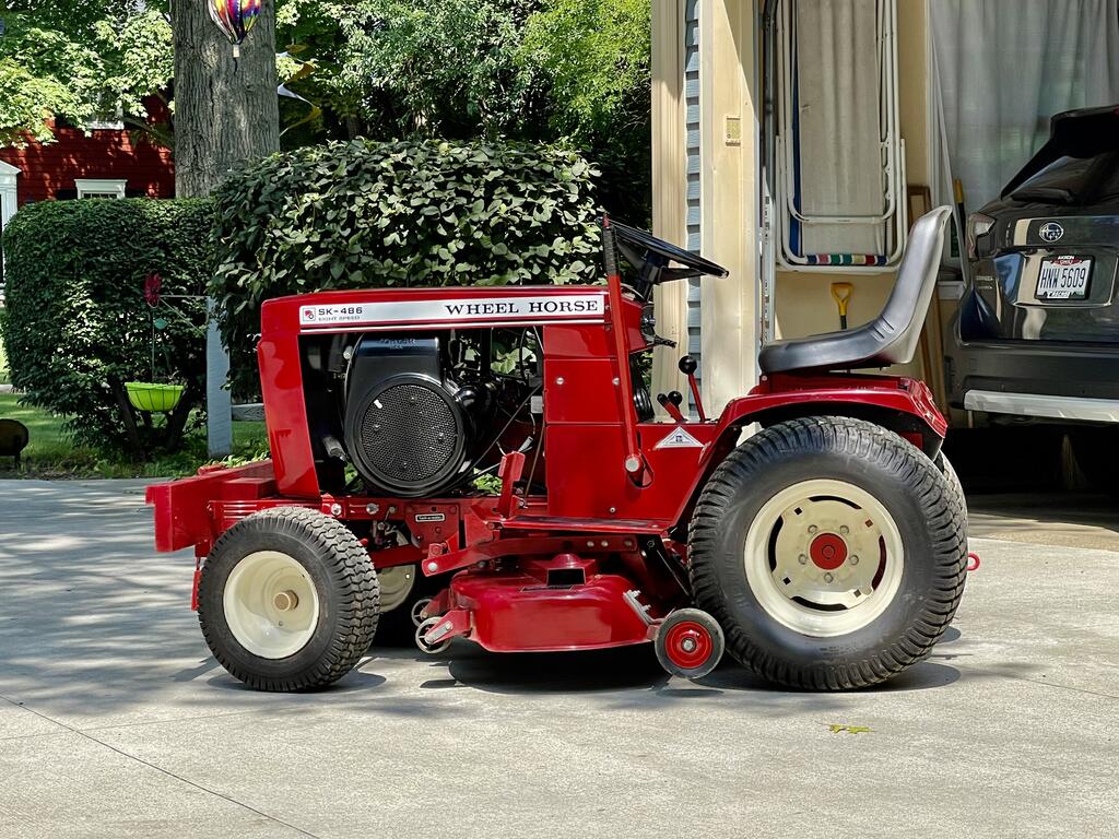

Al C. 1,429 #1 Posted August 28, 2022 I have two Wheel Horse tractors with Koehler K-Series engines. The 1067 with a K-241 (55 years old) and the SK-486 with a K-341 engine (40 years old). Both engines have about 1300 hours on them. Both engines have been well maintained, start on first crank, do not smoke or knock, and have good power. The tractors have been used exclusively for mowing lawns with 42 inch decks. My question is, should I perform a compression test on the engines to verify their health and do these engines have automatic compression release. Any thoughts? Thanks! 2 Share this post Link to post Share on other sites
