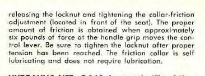

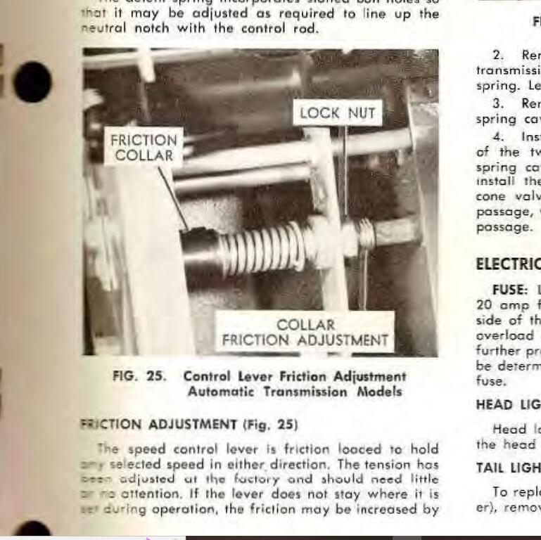

pfrederi 20,704 #2 Posted August 27, 2022 (edited) Try adjusting the tension on the motion control. Nut is 1-1/8" the squared end of the collar is 5/8" Edited August 27, 2022 by pfrederi 3 Share this post Link to post Share on other sites
TonyBer 79 #3 Posted August 29, 2022 Thnx, four top bolts/cover above tranny, will that Provide access or? Share this post Link to post Share on other sites
ineedanother 2,500 #4 Posted August 29, 2022 6 minutes ago, TonyBer said: Thnx, four top bolts/cover above tranny, will that Provide access or? Between the hood stand and the seat. Right between your legs when you're sitting on it. Share this post Link to post Share on other sites

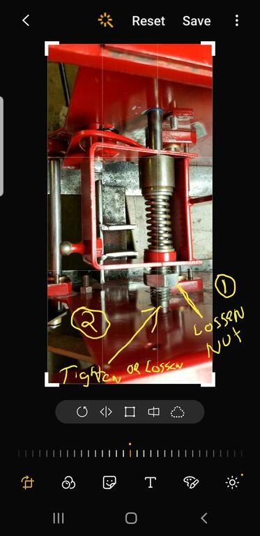

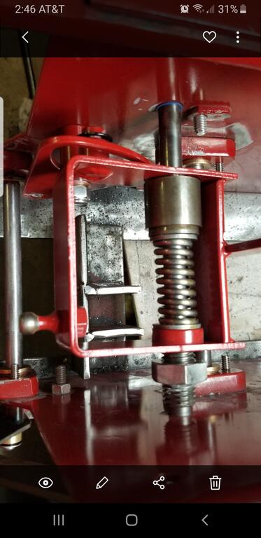

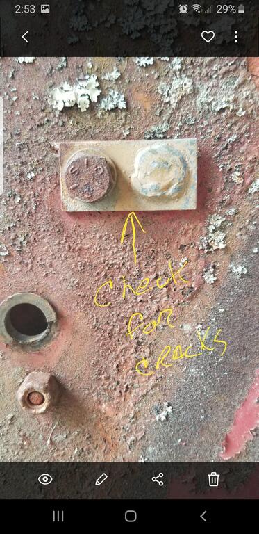

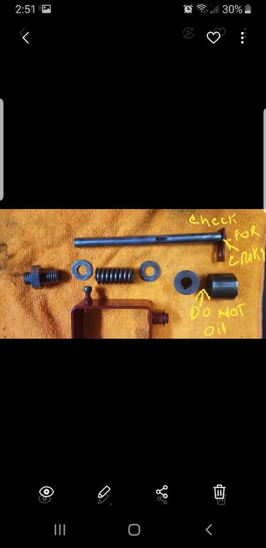

gt14rider 1,216 #6 Posted October 27, 2023 This is an oid post, should start a new one. The info on adjustments for motion control is in sundstrand manual. Here's a look at the parts. 1 Share this post Link to post Share on other sites
tommcgoo 0 #7 Posted October 27, 2023 I have checked for cracks and there are none. I have a very tight motion control setting. These are not my problem. I was wondering if a slightly loose belt would cause my tractor to pause when going slow at a slight hill until I increase the speed to slowly climb and when I reach the top it speeds up allot. Also when I am cutting on a flat grade the tractor will also speed up. Does anyone have any other ideas as to what might be the problem and fix ? Share this post Link to post Share on other sites
