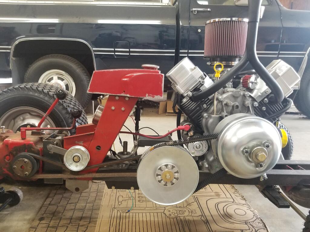

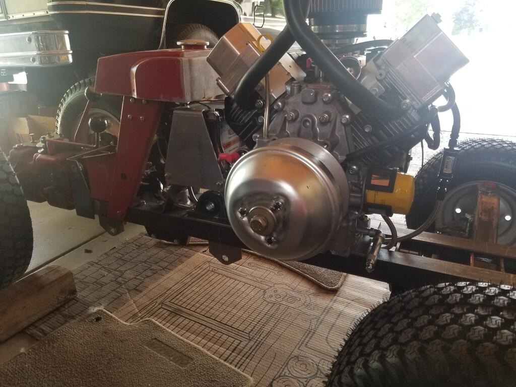

Wild Bill 633 943 #107 Posted June 21, 2023 CVT delivered and v-belt length determined. Installing a ball bearing on the crankshaft to take any axial thrust and overhung load off the Kohler Command crankshaft sleeve bearings. Waiting for parts for the v-belt tensioner. I am hoping the v-belt drive will transmit the power from the jackshaft to the transmission without issue. 2 7 Share this post Link to post Share on other sites

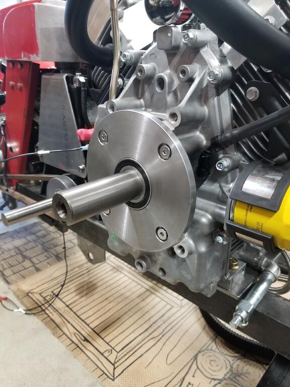

Wild Bill 633 943 #108 Posted July 3, 2023 (edited) The deep groove ball bearing installed on the crankshaft. Edited July 3, 2023 by Wild Bill 633 1 7 Share this post Link to post Share on other sites
Wild Bill 633 943 #109 Posted July 3, 2023 (edited) And the CVT driver pulley is installed on the crankshaft. Machining the jackshaft for the CVT driven and v-belt pluuleys. Edited July 3, 2023 by Wild Bill 633 3 5 Share this post Link to post Share on other sites

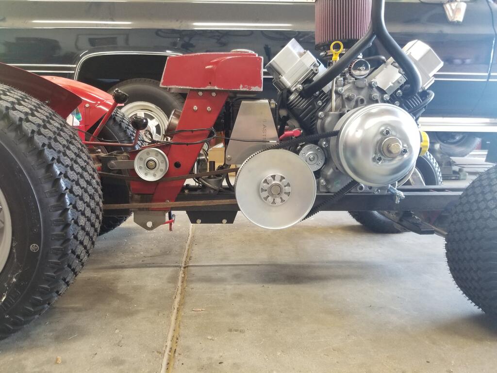

Wild Bill 633 943 #115 Posted July 5, 2023 (edited) Machining on the RH side of jackshaft complete and assembled CVT and v-belt drive with tensioner. By the way @WHX?? aka Uncle Jim, the cardboard laying on the floor under the tractor is from my Traeger. See you tomorrow at Portage. Edited July 5, 2023 by Wild Bill 633 1 2 Share this post Link to post Share on other sites

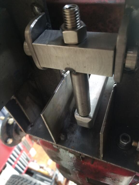

Wild Bill 633 943 #116 Posted July 5, 2023 The v-belt tensioner is an equal length arm on the idler pulley arm with a trunnion mounted to the bottom of the frame and a compression die spring providing the tension load. View from the top. 2 2 Share this post Link to post Share on other sites

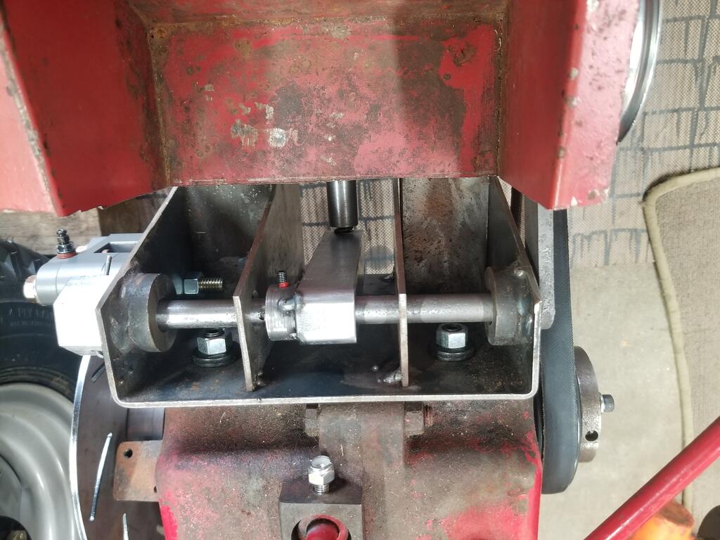

Wild Bill 633 943 #117 Posted July 5, 2023 (edited) And a view of the tensioner from the bottom with a set screw to set the die spring compression. Edited July 5, 2023 by Wild Bill 633 3 2 Share this post Link to post Share on other sites

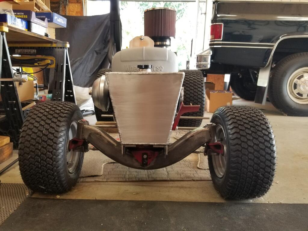

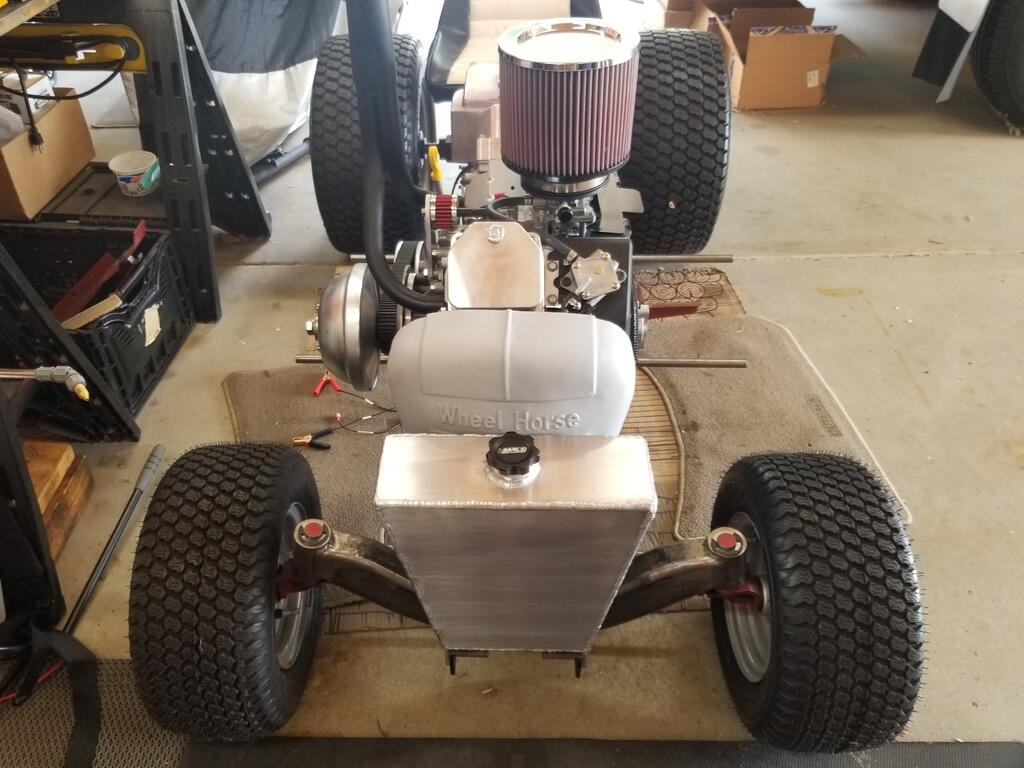

Wild Bill 633 943 #121 Posted August 8, 2023 The 702 fuel tank has a 1 gallon capacity. I don't think the 25+HP engine would run very long on 1 gallon so an auxiliary fuel tank has been added. I wanted it to look similar to a tombstone weight but higher. I left it short enough to see the Wheel Horse emblem on the grille. 4 1 Share this post Link to post Share on other sites
