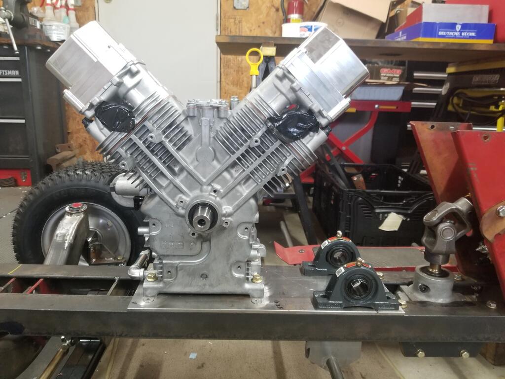

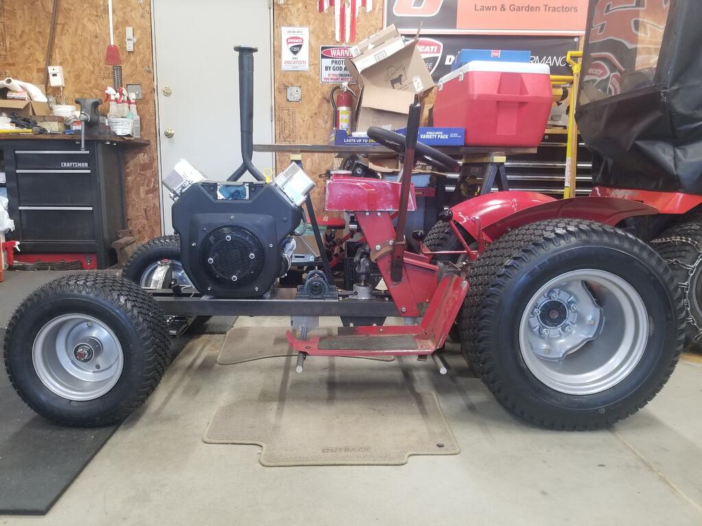

Wild Bill 633 943 #82 Posted March 24, 2023 (edited) Since my last post, the crankshaft has been balanced, and engine assembly has started. Installed crankshaft, rods and pistons, roller camshaft degreed, roller lifters and cylinder heads. Next, determine the correct push rod length. Edited March 24, 2023 by Wild Bill 633 2 2 Share this post Link to post Share on other sites

Wild Bill 633 943 #85 Posted March 25, 2023 (edited) 8 hours ago, Wheelhorse#1 said: Great looking machine and fabrication work, Bill.You really thought this out. Will it be at the big show this yr ? I do not think It will be finished. I am waiting for the carburetor which is at an engine builder to replace the OEM emulsion tube with a jet and adjuster. Then the engine will be run to determine the idle speed so the CVT can be ordered. Some other things to be completed are brake master cylinder, jackshaft, v-belt tensioner, plumbing and electrical. Test run and debug. Then to sheet metal shop and then disassembly for paint. I have been working on this project for 20 months and the one thing this project has taught me is there is always light at the end of the tunnel and patience. Hopefully next year we will see all of you. Can't wait. Edited March 25, 2023 by Wild Bill 633 5 Share this post Link to post Share on other sites

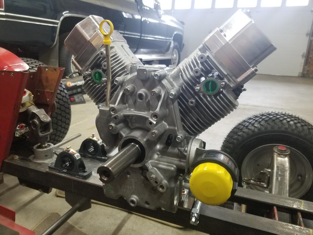

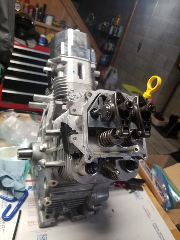

Wild Bill 633 943 #86 Posted March 29, 2023 Correct push rod length has been determined. After 10 months, it's time to finally assemble the engine. 1 3 Share this post Link to post Share on other sites
Wild Bill 633 943 #87 Posted March 29, 2023 Started to assemble the engine today. Still waiting for carb. 1 4 Share this post Link to post Share on other sites

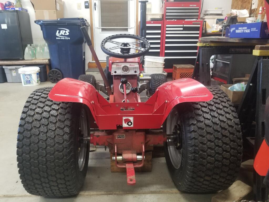

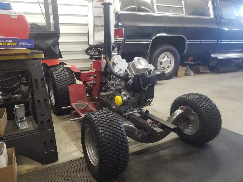

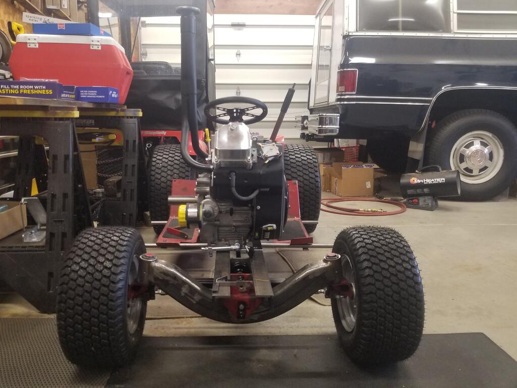

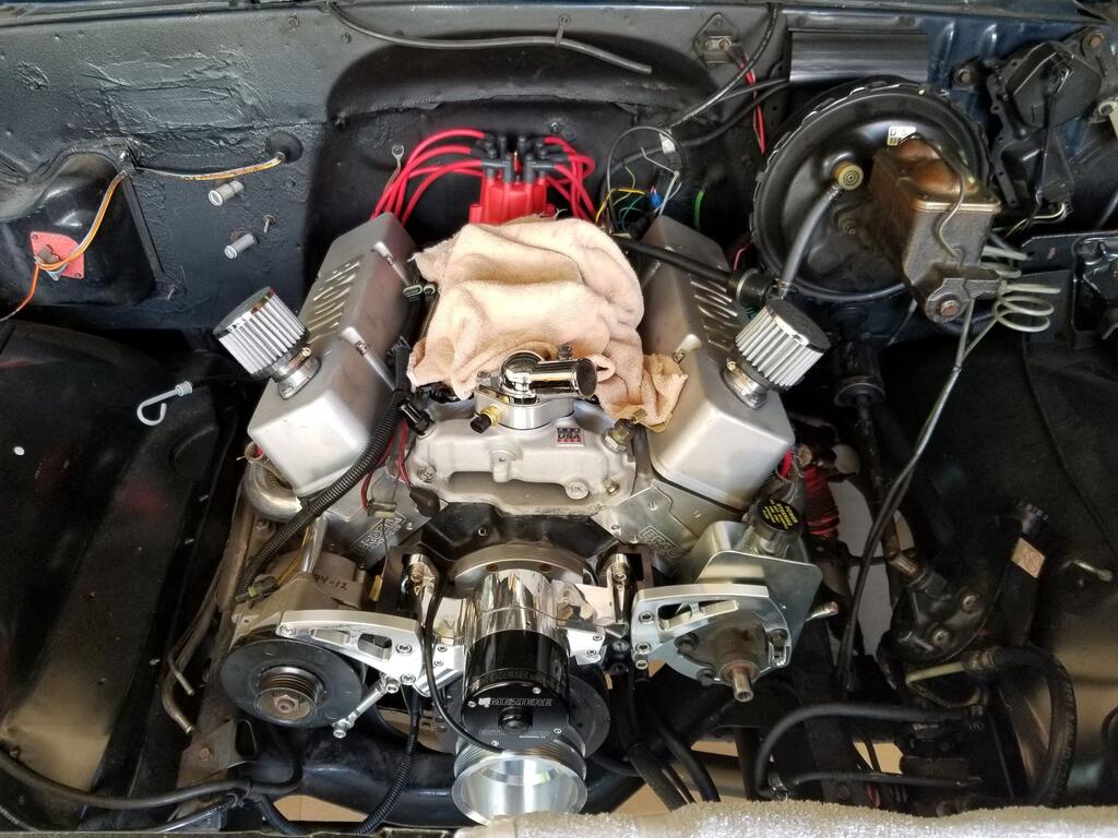

Wild Bill 633 943 #89 Posted March 29, 2023 (edited) Edited March 29, 2023 by Wild Bill 633 1 3 1 Share this post Link to post Share on other sites

Wild Bill 633 943 #95 Posted March 30, 2023 23 minutes ago, Pullstart said: Nice square body Chevy! 1986 GMC K2500 HD 3/4 ton 4X4 350CI 4-Speed which I bought new. The last year of the carburetor and less than 200 HP. So replace the top end with roller-hydraulic camshaft, Brodix Track 1 cylinder heads, roller rockers, stud gridle, Edelbrock Air Gap intake and throttle body fuel injection. Started this project and I got distracted with my Wheel Horse Hot Rod project by @Achto. After the Hot Rod project is done I need to complete this project. 3 5 1 Share this post Link to post Share on other sites
