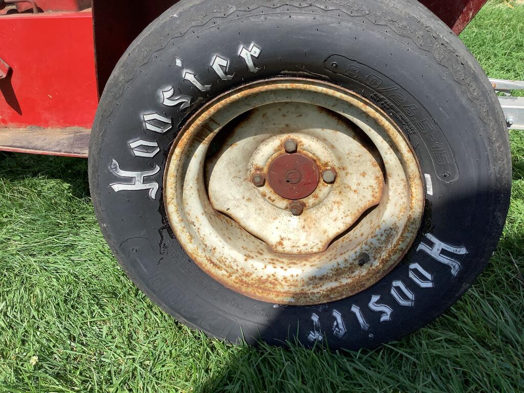

The Freightliner Guy 1,363 #28 Posted August 22, 2022 Hey I now you have a nascar in your shop would the tires fit the tractor? Share this post Link to post Share on other sites
Pullstart 69,550 #29 Posted August 22, 2022 11 minutes ago, The Freightliner Guy said: Hey I now you have a nascar in your shop would the tires fit the tractor? I like these short track tires, they have some tread on ‘em for off road use 2 Share this post Link to post Share on other sites
