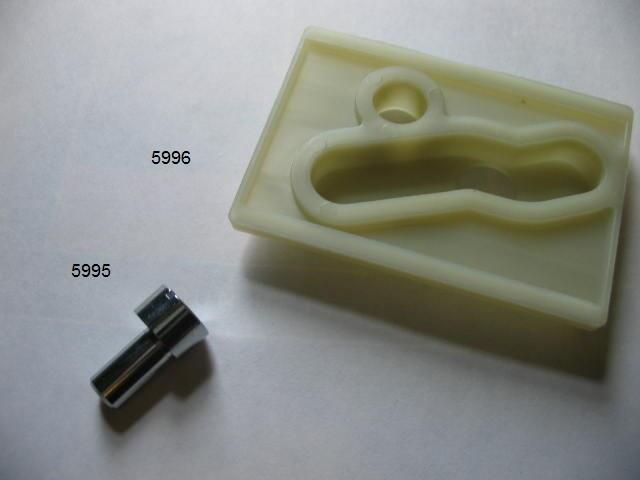

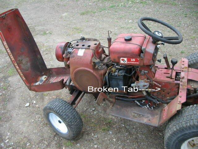

daveoman1966 3,881 #3 Posted August 18, 2022 (1) You need to look at the side of the hoodstand... there is a Lock Down TAB that is very often cracked or broken. This condition allows for the eractic you've described. (2)...cracked frame (3) broken or worn out Nylon Cam (5996) or (4) worn out concentric (5995). Share this post Link to post Share on other sites
moe1965 770 #4 Posted August 18, 2022 (edited) Definitely cracked. Can I weld it back together or are replacement parts available???? Edited August 18, 2022 by moe1965 1 Share this post Link to post Share on other sites

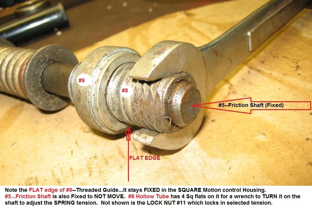

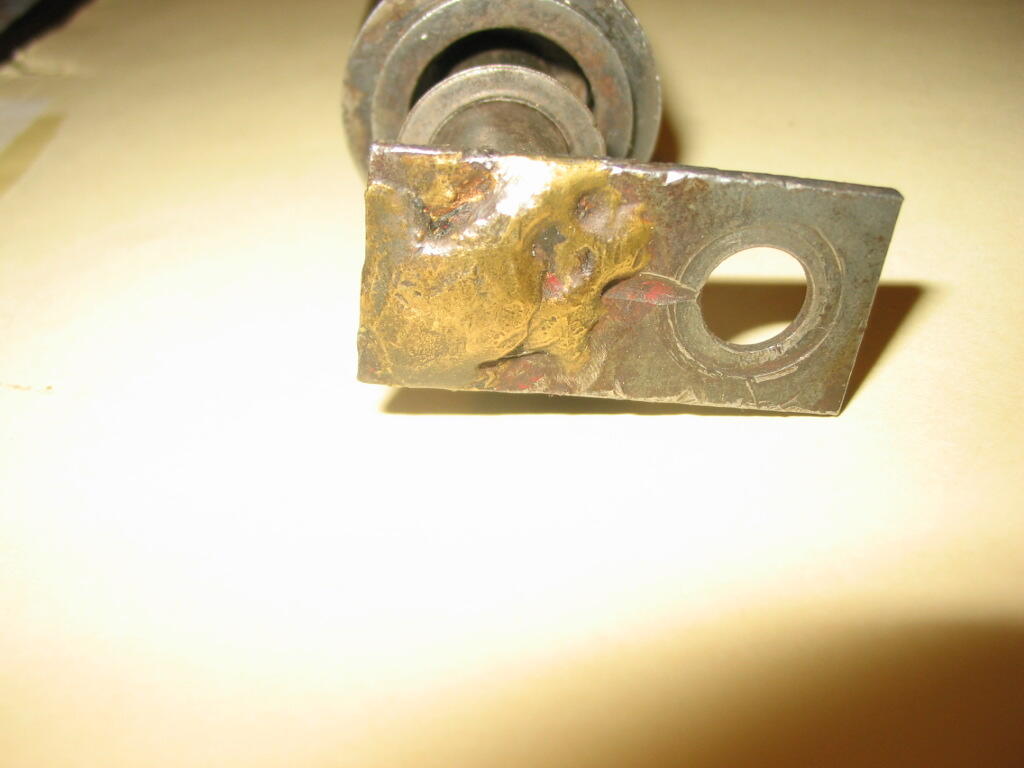

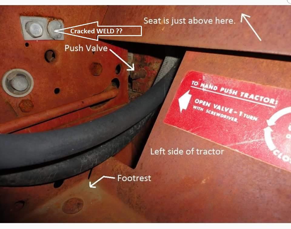

daveoman1966 3,881 #6 Posted August 18, 2022 (edited) This is a schematic of the motion control apparatus. Item 55 is the Cam Pivot Rod part #7604. IMHO...this weld usually breaks because the friction control parts (56-60) are FROZEN to this pivot rod. You MAY get lucky by re-welding the TAB... fingers crossed because this can be difficult to repair otherwise. I was able to BRAZE one of these TABS...maybe you can too. Edited August 18, 2022 by daveoman1966 1 Share this post Link to post Share on other sites
daveoman1966 3,881 #7 Posted August 18, 2022 The Pivot Rod #7604 is available here...ONLY $174.52. https://www.rcpw.com/parts-lookup?arisku=7604&arireturnurl=https%3A%2F%2Fwww.rcpw.com%2Flookup%2F%23%2FToro_Consumer%2F1-0511%252c_B-100_Automatic_Tractor%252c_1975%2FBrake%252c_Clutch%252c_Speed_Control_Linkage-Continued%2F874e479e-ca8a-4881-aa0c-29a505c9340e%2Fa651bef2-a536-4c54-b85d-b29403b0458a&aridescription=See+Supercession%3A+741211&aribrandcode=TO 1 Share this post Link to post Share on other sites

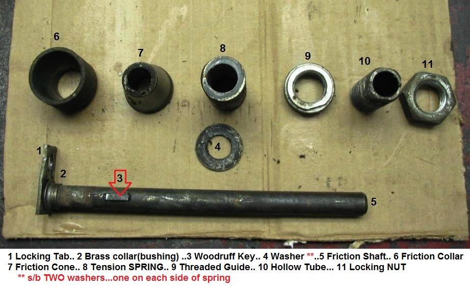

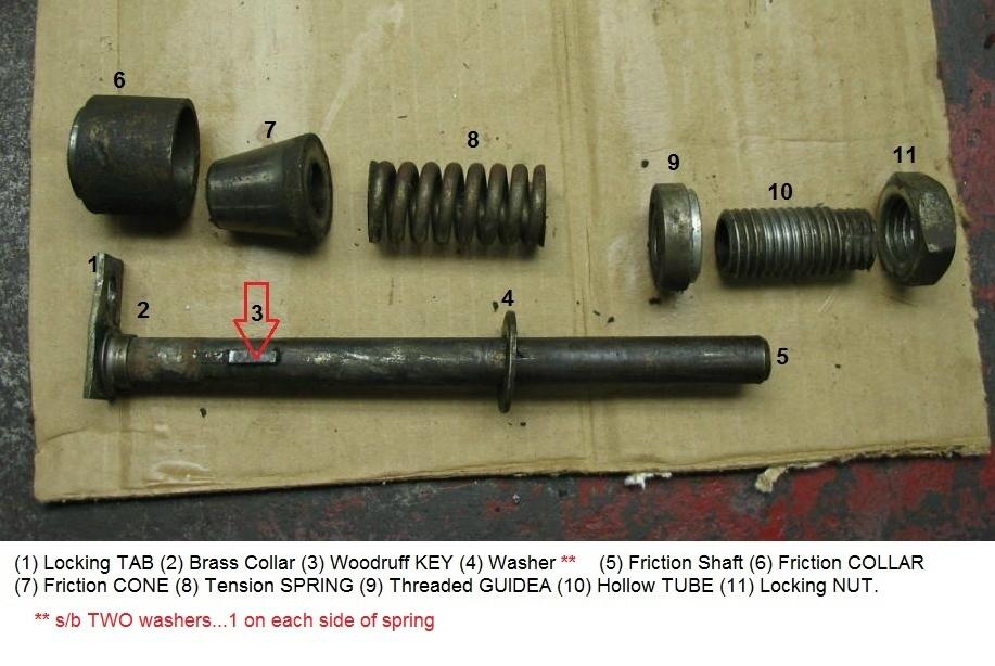

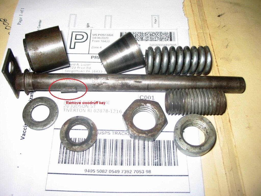

daveoman1966 3,881 #10 Posted August 19, 2022 48 minutes ago, moe1965 said: Wow. Sooooo next question if I pull that rod out to try and repair it will all those springs and things fall out as well as pictured NO... they don't just fall apart. These are the parts.. Share this post Link to post Share on other sites
daveoman1966 3,881 #11 Posted August 19, 2022 Trying to upload a short video of the PIVOT ROD being stationery while other parts move. I your parts move like this, the PIVOT ROD is NOT frozen and you MAY be able to re-weld without tear-down.... Otherwise, it is much more difficult to tear apart and fix/replace the pivot rod.. 023.AVI Share this post Link to post Share on other sites

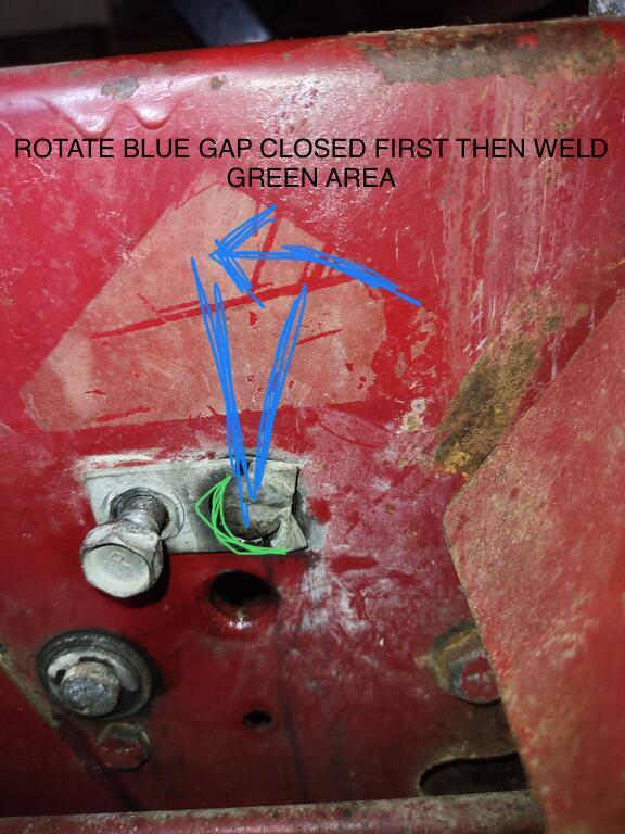

Pullstart 68,682 #12 Posted August 19, 2022 If you chose to weld it while in place, it looks like the rod needs to rotate forward. It’d close the gap on the top and weld it in place. The bottom is warped and bent so don’t worry about it’s gap. Share this post Link to post Share on other sites

moe1965 770 #14 Posted August 19, 2022 (edited) I couldn't wait until tomorrow I got the broken shaft out and getting it repaired by a friend of mine that owns a machine shop. I do however need a bushing. Any where I can locate one. Item number 6-42 Edited August 19, 2022 by moe1965 Share this post Link to post Share on other sites
