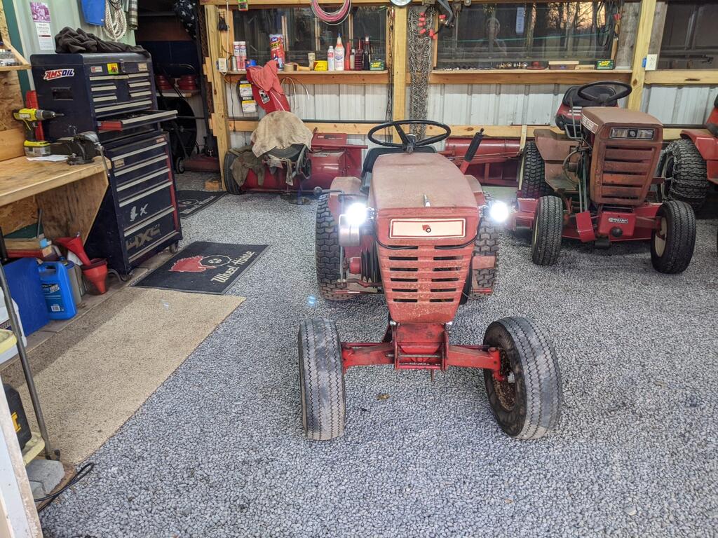

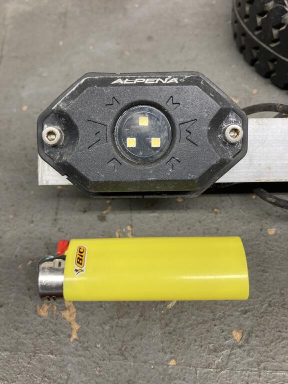

Blasterdad 3,163 #6 Posted August 17, 2022 (edited) Personally, I hate when when people drill holes through the sheet metal & bolt lights to the sides of the hood, to ME it ruins the lines of the tractor & just looks plain "ol ugly. If you can't find a factory headlight bucket & lens I would do this... Make a small metal plate to fit in the hood opening & mount 2 of these to it. They are super bright, they put the light pattern where you want it, & doesn't spoil the looks of the tractor. ( also keeps wires further away from the muffler ) Edited August 17, 2022 by Blasterdad typo 3 Share this post Link to post Share on other sites

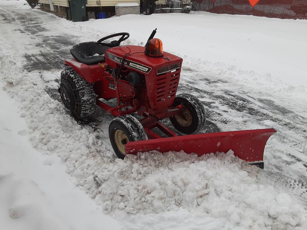

Rob R 981 #7 Posted August 17, 2022 To me the real reason you need lights on a machine is if you are going anywhere near or on the streets in front or around your house. Everyone is moving really fast and talking on their phones and you need the help you can get! In addition, when plowing I ALLWAYS add a magnetic yellow circling light to the hood of the tractor (added cigarette lighter outlets to all my tractors. Just saying still alive!!!! 6 Share this post Link to post Share on other sites

Heatingman 977 #9 Posted August 17, 2022 1 hour ago, Blasterdad said: Personally, I hate when when people drill holes through the sheet metal & bolt lights to the sides of the hood, to ME it ruins the lines of the tractor & just looks plain "ol ugly. If you can't find a factory headlight bucket & lens I would do this... Make a small metal plate to fit in the hood opening & mount 2 of these to it. They are super bright, they put the light pattern where you want it, & doesn't spoil the looks of the tractor. ( also keeps wires further away from the muffler ) Is that called a rock light? Share this post Link to post Share on other sites
Blasterdad 3,163 #10 Posted August 17, 2022 32 minutes ago, Heatingman said: Is that called a rock light? Alpena Tough Pods, ( Walmart has them ) Share this post Link to post Share on other sites

Handy Don 15,934 #12 Posted August 17, 2022 Agree with all of the above. A WH on the road is not an expected encounter for a motorist so anything you can do to make it visible will help. Add to this that the WH operator is focused on plowing or blowing atop a noisy machine. Several members here have mounted yellow flashers or circling lights on a removable pole that extends above head height in addition to headlights, rear-facing lights, and tail lights. 3 Share this post Link to post Share on other sites
Heatingman 977 #13 Posted August 17, 2022 Im not going to be plowing on the road, just my driveway. Tractor is a B-80 from the mid 70’s. I plan on using a low wattage requirement light. Found some 9 watt 12v lights used for residential outside lights that I could make a fixture for. Gonna take a trip to the home center and have a looksie. I like the amber strobe idea also. 2 Share this post Link to post Share on other sites

D_Mac 9,333 #15 Posted August 17, 2022 I had a yellow rotating light on my 857. I added a waterproof auxiliary plug and the light was magnet and held firm on the hood. You are able to take it on and off easily. I also added led lights on the 856. The holes were already drilled into the hood at some point in its life. I don't think the lights look bad at all. Got them for 15 bucks for the pair on fleabay. They fold in and out.. Look better then empty holes that's for sure. For what you need I would go with the cigarette plug magnetic yellow flasher. 2 Share this post Link to post Share on other sites

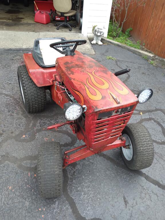

rjg854 12,842 #16 Posted August 18, 2022 I have a set of headlights on my raider that I'm pretty pleased with Share this post Link to post Share on other sites
Heatingman 977 #17 Posted August 19, 2022 7 hours ago, rjg854 said: I have a set of headlights on my raider that I'm pretty pleased with How does the charging system handle those, being a tractor without factory lights? Share this post Link to post Share on other sites

rjg854 12,842 #19 Posted August 19, 2022 1 hour ago, Heatingman said: How does the charging system handle those, being a tractor without factory lights? This model has a starter/generator, so there's no problem with charging the battery and running the lights. Share this post Link to post Share on other sites
Handy Don 15,934 #20 Posted August 20, 2022 On 8/18/2022 at 9:53 PM, rjg854 said: This model has a starter/generator, so there's no problem with charging the battery and running the lights. Pretty much all of the S/G tractors could deliver 15 amps once they hit 1500 RPM or so. Share this post Link to post Share on other sites
