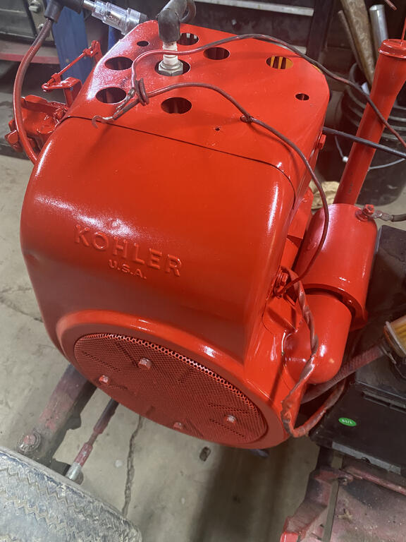

ElevatorChris 0 #1 Posted August 15, 2022 Freshly rebuilt motor but try to figure out the wiring if anyone could help thanks Share this post Link to post Share on other sites

squonk 45,805 #3 Posted August 15, 2022 The wire with the hook on the end and rubber grommet is supposed to go from the coil negative to the points. Why it's in the location it is is beyond me. 3 1 Share this post Link to post Share on other sites

953 nut 64,647 #5 Posted August 15, 2022 I see a coil wire with a spark tester apparently emerging from the engine flywheel cover which would indicate a Magneto Ignition system. I also see what appears to be the wire from a set of ignition points to a battery ignition coil. Got to know a bit more about this engine to give you the correct wiring. Please don't do anything involving putting power to the wires on this engine until we know the Spec number or the application it was installed on prior to being rebuilt. 2 Share this post Link to post Share on other sites

squonk 45,805 #8 Posted August 16, 2022 Now I'm thinking it's a magneto engine and that points wire is supposed to exit the shroud on the other side. 1 Share this post Link to post Share on other sites
953 nut 64,647 #9 Posted August 16, 2022 5 minutes ago, squonk said: Now I'm thinking it's a magneto engine and that points wire is supposed to exit the shroud on the other side. BINGO, that is why I didn't want any power applied to any wire until we know more about the engine. @ElevatorChris Share this post Link to post Share on other sites
