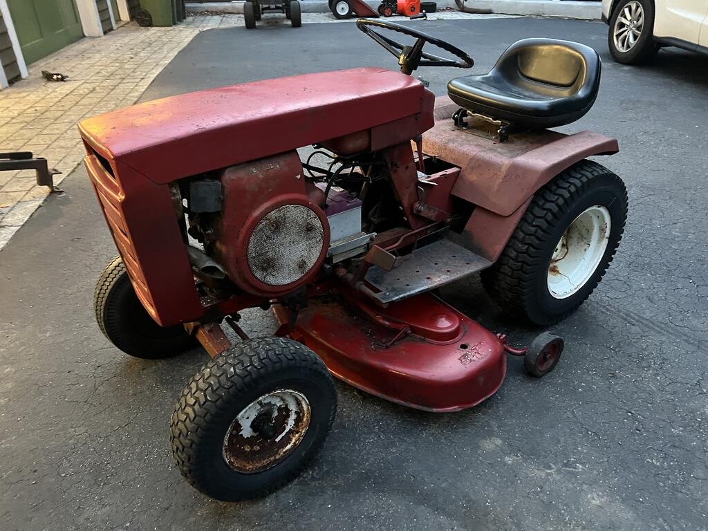

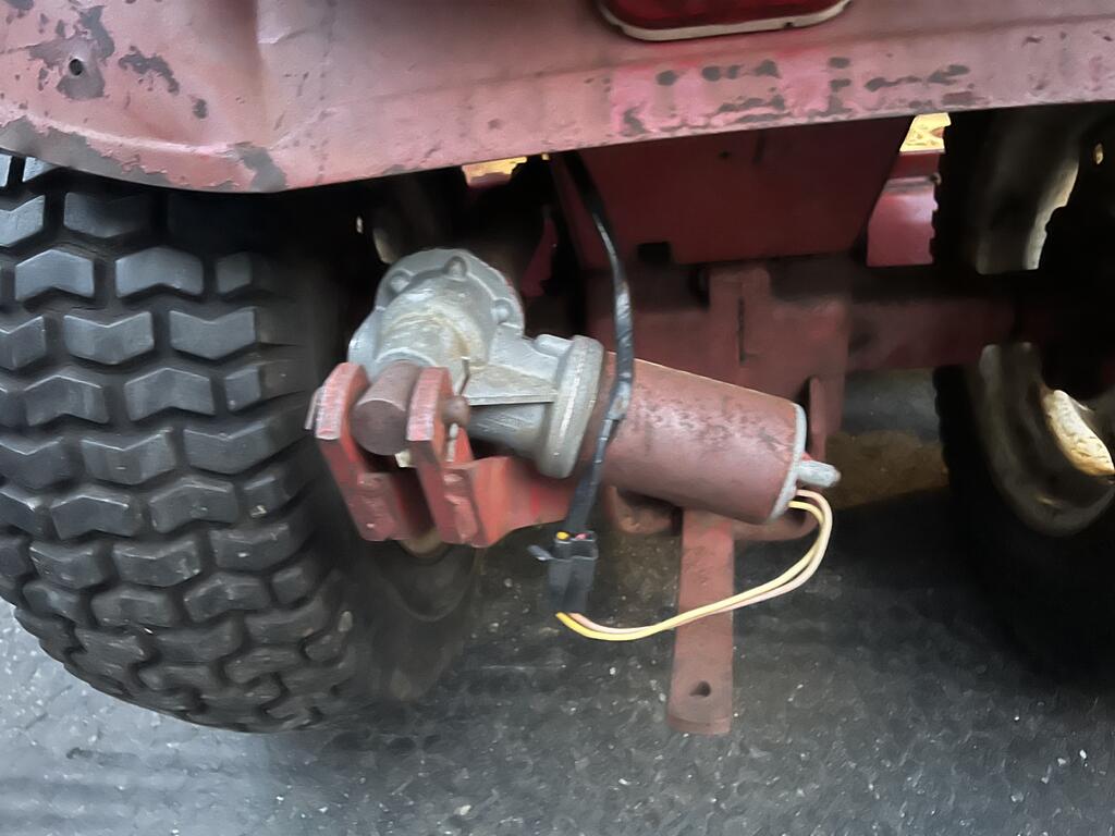

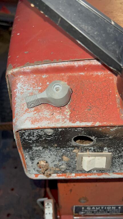

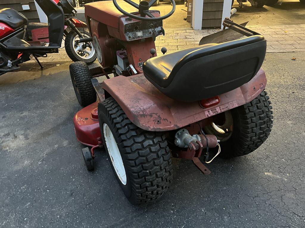

Bens vintage tractors 1,555 #1 Posted August 15, 2022 Found a pretty cool one today. Raider 12 with electric lift. Only bought it for the deck so if anyone is interested in the tractor let me know. 2 1 Share this post Link to post Share on other sites
Sparky-(Admin) 23,519 #2 Posted August 15, 2022 Interesting lift….not a factory setup (I don’t think it’s factory) Share this post Link to post Share on other sites

Hampton 95 #9 Posted August 16, 2022 Where do you attach something to lift? Share this post Link to post Share on other sites
Thor27 835 #10 Posted August 16, 2022 1 hour ago, Hampton said: Where do you attach something to lift? Under or with a cable out the rear same as any other wheel horse of that Era. The actuator just replaces the lift handle. Share this post Link to post Share on other sites
Hampton 95 #11 Posted August 16, 2022 11 minutes ago, Thor27 said: Under or with a cable out the rear same as any other wheel horse of that Era. The actuator just replaces the lift handle. I don't see a place to attach anything. No holes or what ever. Share this post Link to post Share on other sites

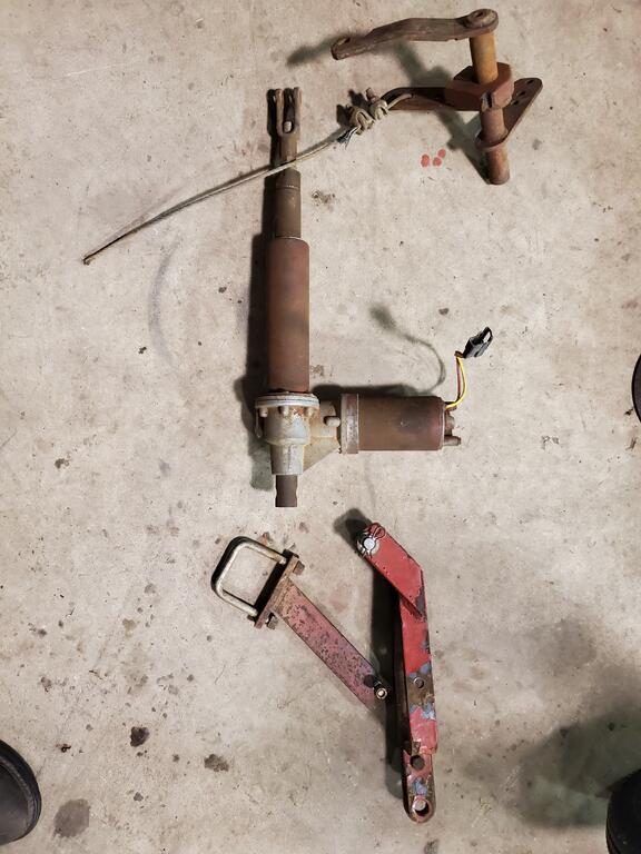

Thor27 835 #12 Posted August 16, 2022 (edited) Everything attatches exactly as it would to a similar horse without an electric lift. The actuator replaces the lift handle. the bell crank that normally operates off the lift handle is still there but attached to the front of that actuator. The rear of the actuator you see in the pictures is on a bracket that bolts to the rear axle and doesn't move. Edited August 16, 2022 by Thor27 Add pic. 2 Share this post Link to post Share on other sites

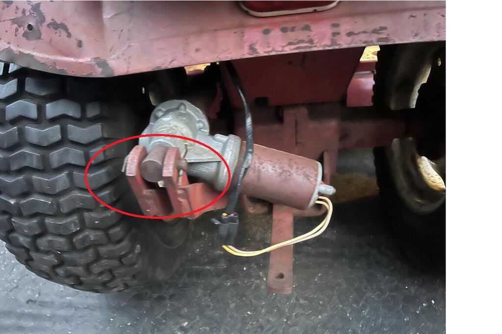

Hampton 95 #15 Posted August 17, 2022 (edited) I understand how the lift works. I mean this section I have circled. How do you attach something to it? Edited August 17, 2022 by Hampton Share this post Link to post Share on other sites
pfrederi 18,806 #16 Posted August 17, 2022 Looking at the manual you do not attach anything there. if you are using a slot or clevis hitch it is raised by the cable that goes through the tube up to the pivot arm under the hood stand. Same setup as if you were using a manual lift. Share this post Link to post Share on other sites
Thor27 835 #17 Posted August 17, 2022 4 hours ago, Hampton said: I understand how the lift works. I mean this section I have circled. How do you attach something to it? 19 hours ago, Thor27 said: The rear of the actuator you see in the pictures is on a bracket that bolts to the rear axle and doesn't move. Share this post Link to post Share on other sites
Hampton 95 #18 Posted August 17, 2022 So nothing on that end. Got now I think. duh lol Would like to see one in action. 1 Share this post Link to post Share on other sites
