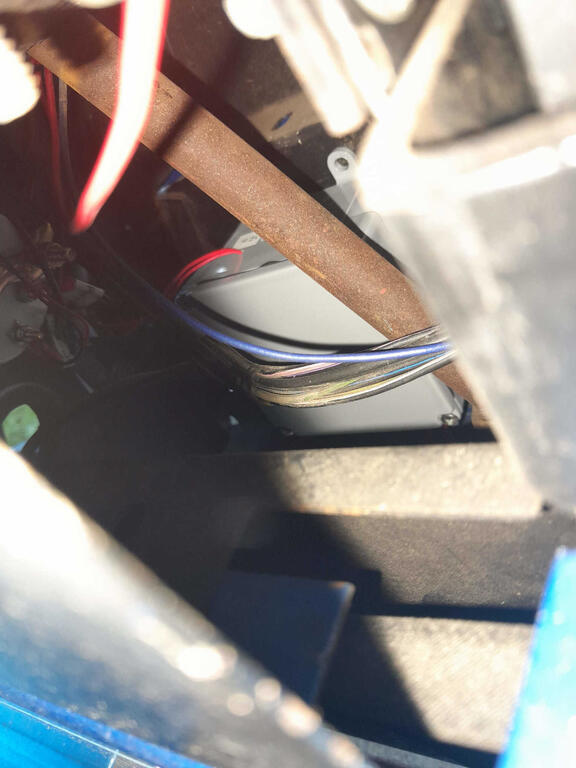

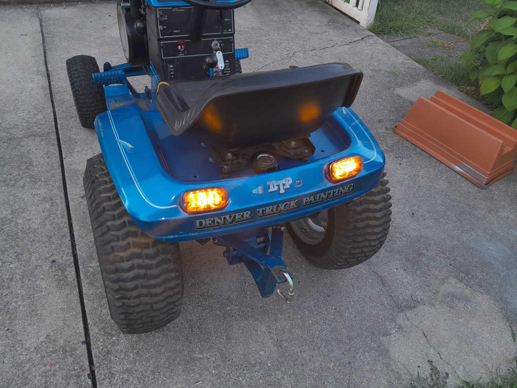

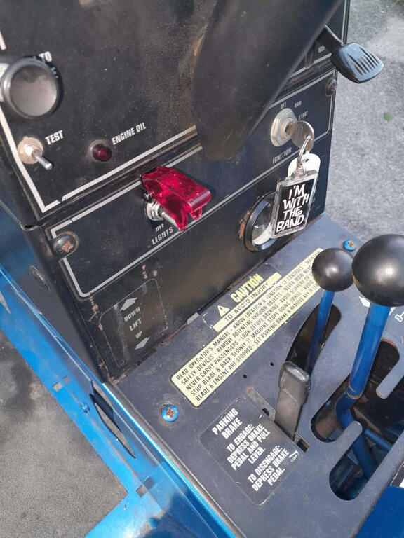

subvet720 179 #1 Posted August 13, 2022 I finally put my circuitry to give me clean 12VDC in a box and mounted it in the mighty Conrad Wieser Wheel Horse. Then we got the LED tail lights installed/hooked up with a fancy new headlight switch that my helper picked out. My helper even took me on a test drive. He told me to sit in the wagon so that I could admire the new tail lights as we drive around the neighborhood Next step... Add LED light strips under the frame that are controlled by my phone and music. 8 Share this post Link to post Share on other sites

subvet720 179 #7 Posted August 17, 2022 The reason I went to the bridge rectifier and buck converter was so that I can use 12V or 5V LEDs (2 buck converters running at the two voltages, all located in the same power box) with digital controllers. The 12VAC coming off the magneto is between 10V and 24V and would not work with the controllers. I did take the grounding advice and ran a 12AWG ground line directly from the battery that I use for all the LEDs. Because of the low current draw of the LEDs, I used 16AWG nickel/Teflon wire that I have left over from some high temp projects I did twenty years ago. It all works like a charm and I now have lots of power for expansion. 2 Share this post Link to post Share on other sites
