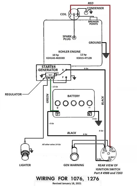

953 nut 62,969 #2 Posted August 8, 2022 This is how it was done from the factory. 41 minutes ago, Thompson1276 said: Gen Warning light off a old Sears and put it on middle to S and the outside wire to I , and it didn’t even light up Adding a solenoid would require some changes to make the generator light work. You can use the three prong switch and just run the "BAT" terminal of the regulator back to the battery. 1 Share this post Link to post Share on other sites

rmaynard 16,690 #6 Posted August 8, 2022 If you user name is any indication of your model number (1276), here is the wiring diagram from the 1276 manual. Share this post Link to post Share on other sites
