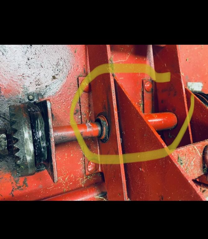

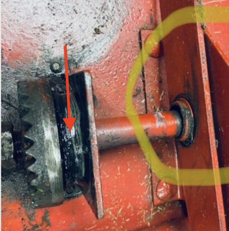

peter lena 9,471 #34 Posted August 12, 2022 @Handy Don so referring to the picture showing the gear set up , and the wallowed out shaft to frame fit , thats how its saposed to be ? looking at obvious lubrication gear wear , and probable play on the set up , thats a normal finished work area ? personally would make some changes to make that go away , good luck with it , pete Share this post Link to post Share on other sites
Handy Don 14,706 #35 Posted August 12, 2022 33 minutes ago, peter lena said: @Handy Don so referring to the picture showing the gear set up , and the wallowed out shaft to frame fit , thats how its saposed to be ? looking at obvious lubrication gear wear , and probable play on the set up , thats a normal finished work area ? personally would make some changes to make that go away , good luck with it , pete Pete, see Post #28. That picture shows the cross-shaft entering (or exiting?) the frame pivot tube as it connects the two spindles. The shaft does not touch the tube! The shaft is borne on two flange bearings (the red arrow points to one covered in grease) right next to the bevel gears. The sheet metal immediately to the right of the flange is part of the enclosure that keeps the bevel-spur gear protected from outside debris--the rest of the enclosure was removed for the photo. The tube itself forms the pivot/support for the two parts of the lift frame--think hollow, fat axle--and that is the tricky bit due to function, spacing, and tight tolerances. Share this post Link to post Share on other sites
