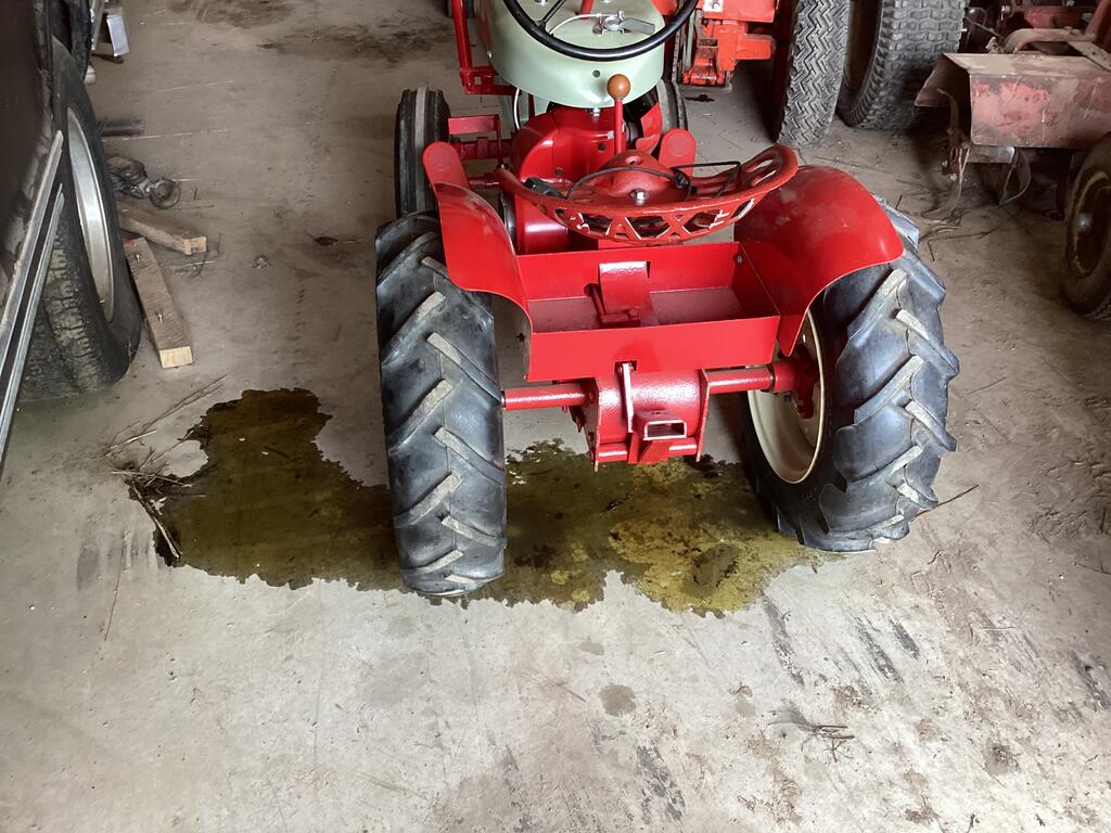

Pullstart 69,296 #31 Posted June 15, 2023 Something tells me… I shouldn’t have assumed the transmission was empty… 1 Share this post Link to post Share on other sites

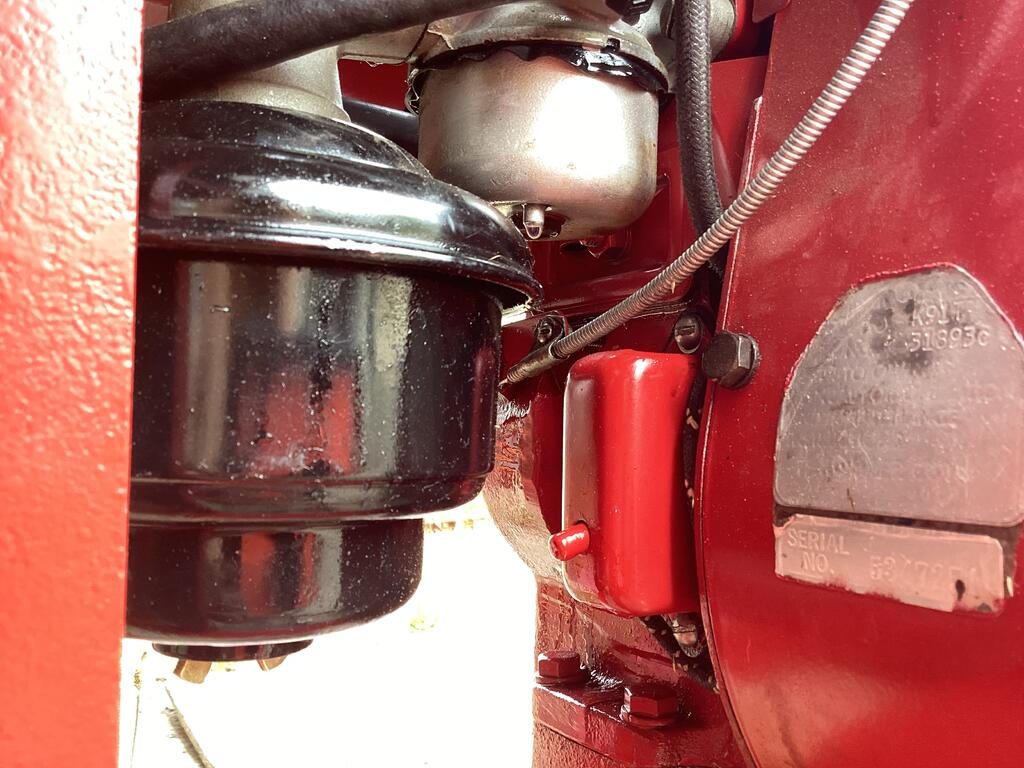

Pullstart 69,296 #32 Posted June 15, 2023 Cleaning out the bowl did the trick, but now I can’t get the little drain button to stop leaking. Happy to have a runner though! 1 Share this post Link to post Share on other sites
wallfish 19,500 #33 Posted June 15, 2023 3 hours ago, Pullstart said: but now I can’t get the little drain button to stop leaking If you can cut a sliver of small fuel line like from a trimmer, you can make an O ring to seal it. It needs to be straight which is the tricky part since it crushes when you go to cut. Or find a tiny O ring One of the guys in the barns at the show has kits to fix them. Think it's AZ 1 Share this post Link to post Share on other sites
Pullstart 69,296 #34 Posted June 15, 2023 8 minutes ago, wallfish said: If you can cut a sliver of small fuel line like from a trimmer, you can make an O ring to seal it. It needs to be straight which is the tricky part since it crushes when you go to cut. Or find a tiny O ring One of the guys in the barns at the show has kits to fix them. Think it's AZ Until the big show, K&B’s fuel bowl shut off works great! Share this post Link to post Share on other sites
