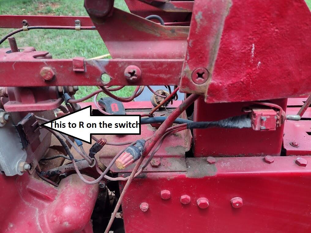

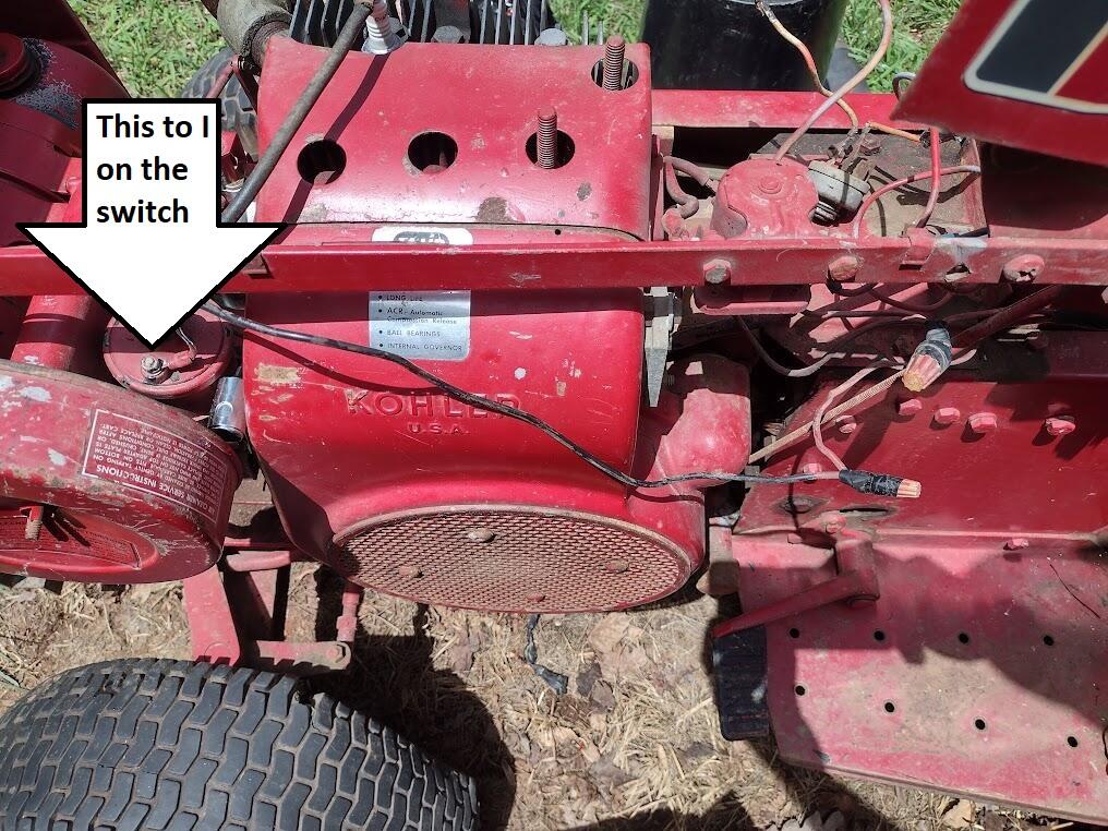

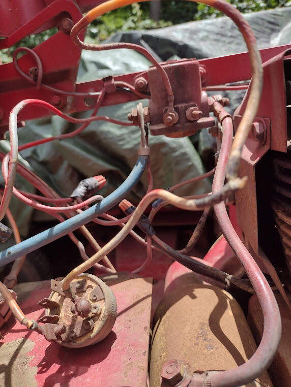

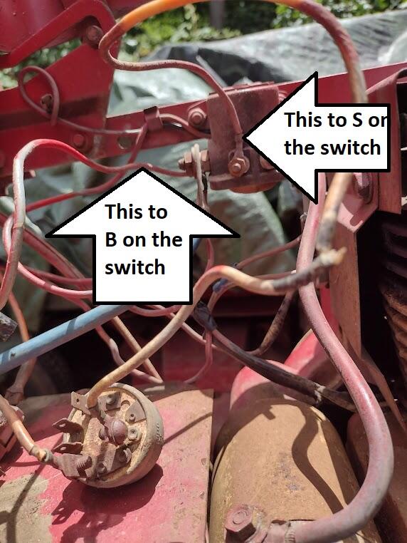

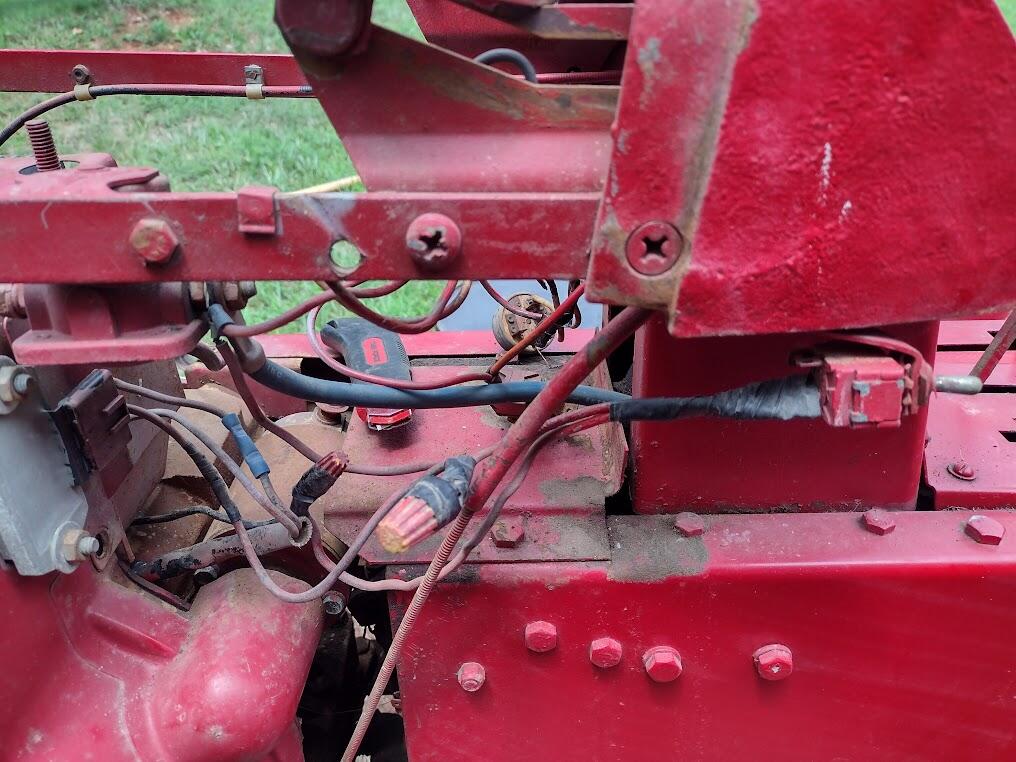

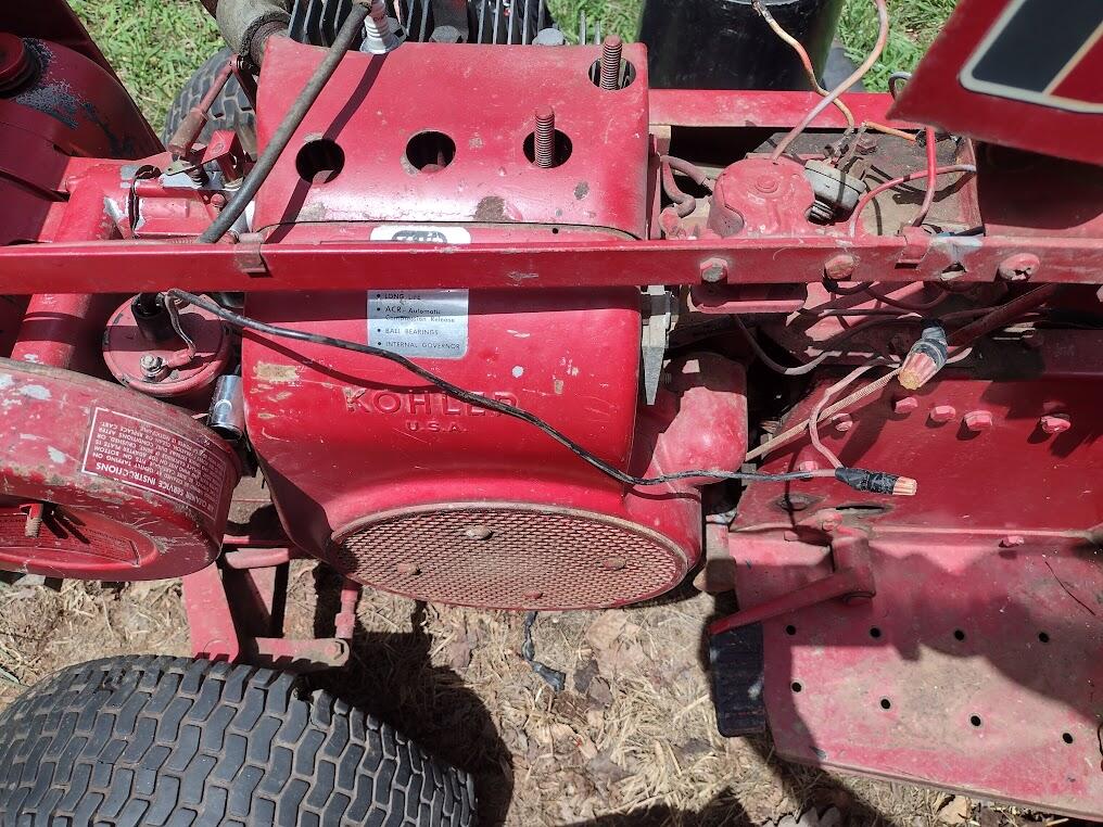

Skwerl58 811 #1 Posted August 1, 2022 I picked up a 103-990 ignition switch, electric fuel pump and condenser for my 1970 GT14 that I am trying to get going. After installing the condenser I went to install the switch and immediately noticed that there was a wires going to a toggle switch that went to the coil and the solenoid. The ignition switch only has two wires connected. Can anyone help me solve this. Also where would be the best place to wire in the fuel pump. Thanks for any suggestions. Share this post Link to post Share on other sites
gwest_ca-(File Mod) 12,066 #2 Posted August 1, 2022 The flat 3-wire connector at the left looks like a small voltage regulator and one wire from the switch appears to go to the center terminal on the regulator. Another goes to the hot side of the solenoid. Correct? Then the other small wire goes to the black and guessing on to the ignition coil but this is not original to the 1970 GT-14 which had breakerless ignition. Post a picture of the ignition coil so we can determine the type of ignition. The 103990 is wrong for breakerless ignition. The ignition may have been changed to battery type and the 103990 would be correct. Share this post Link to post Share on other sites

953 nut 64,649 #4 Posted August 2, 2022 That birds nest wiring disaster is going to have to go. Use this wiring diagram as a guide and you will want to connect the fuel pump to the "A" terminal of the ignition switch and give it a 10 amp fuse. As long as your voltage regulator is inserted into the cooling fin area of your engine's flywheel cover it should be fine. 1 Share this post Link to post Share on other sites
