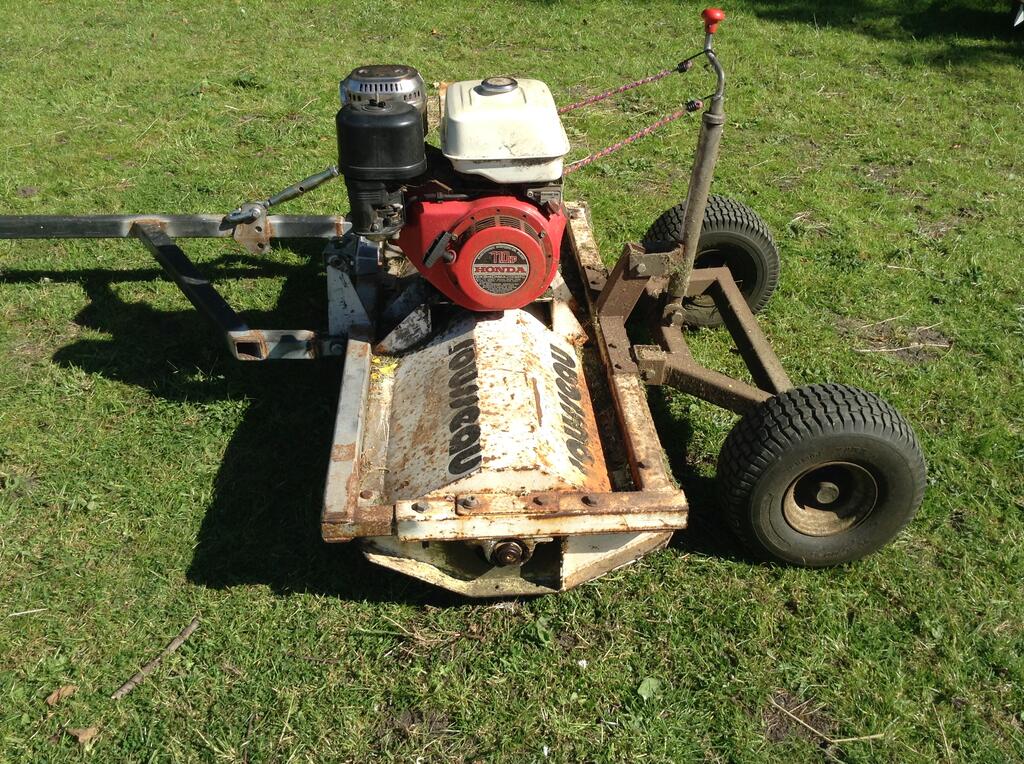

ranger 1,828 #10 Posted August 1, 2022 Here is a photo of mine Mick, I don’t know what it weighs, but my C121 has no trouble at all handling it. It has a 4ft wide rotor, 11 hp Honda engine, modified from a front mounted ‘quad’ mounted unit. With the wheels at the rear it adds a nice bit of weight to assist traction. With the wheels at the sides, you get less drawbar weight, but less traction assist, plus, it makes the whole unit wider for access through gateways, and mowing against fences, etc. The drawbar ‘flips’ over to allow the unit to, either follow directly behind, or to run offset to the left. Must remember to grease it with the ‘Lucas Green’ before next use! Doug. 2 2 Share this post Link to post Share on other sites

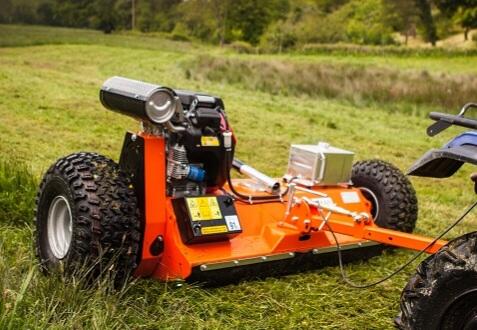

Mickwhitt 5,231 #11 Posted August 2, 2022 This is the beastie I am looking at. I'm going up to the dealership this week to see one in the flesh. When you watch videos of them in use at the back of a quad bike they seem to travel too fast, but I'm not sure about the gearing of a quad. The reason I want one us because the 20 acre site has tall grass on it and we've had a few fires started by kids recently. Cutting paths acted as firebreaks and I'd like to cut a few more. We will see if it's the right kind of machine for the job. 6 Share this post Link to post Share on other sites

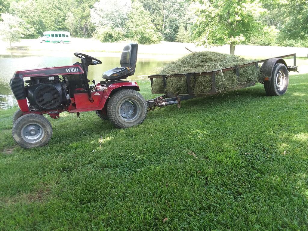

Lee1977 7,420 #12 Posted August 3, 2022 Tralier weights 1400 lbs. and my lot isn't level. 1 Share this post Link to post Share on other sites

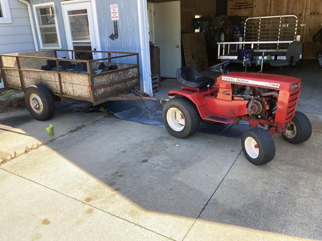

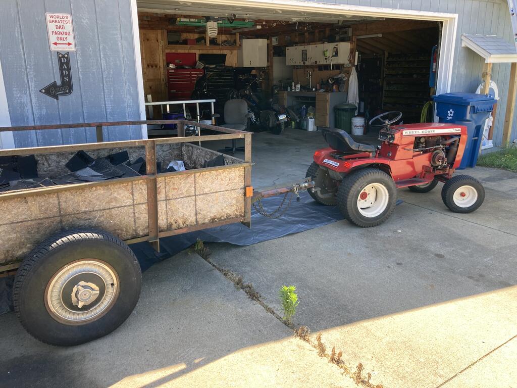

Blasterdad 3,045 #14 Posted August 11, 2022 C-81 with about 1000 pounds of shingles in the trailer, your C-125 will pull that around like it's not even there. transmissions are designed to pull, like you said, dealer is just trying to sell you a quad. 3 Share this post Link to post Share on other sites

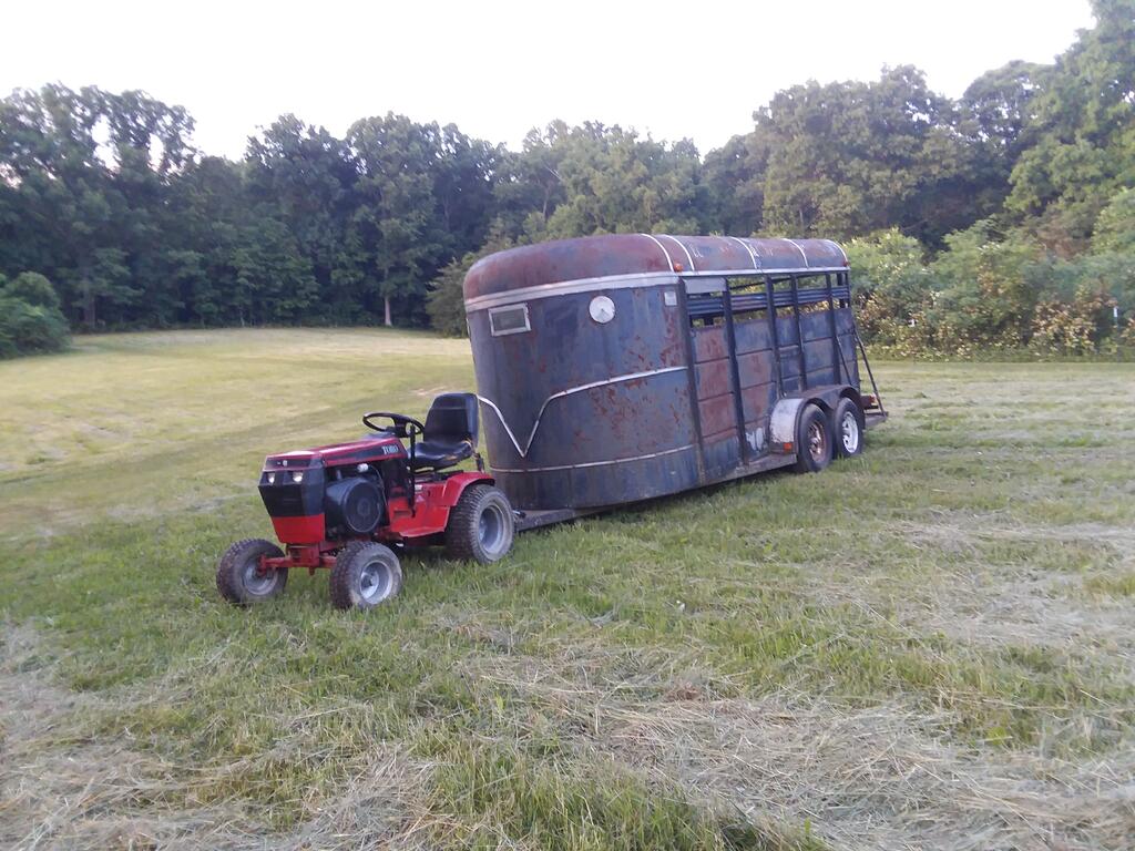

TJ5208 1,841 #16 Posted September 4, 2022 (edited) No problem pulling the horse trailer and it's full of my stuff. And you guys know how heavy grass it no problem moving this either. And i didn't have any trouble stopping either trailers. If this makes it better I had to pull the horse trailer up on blocks so you can see they will pull. That guy does not know nothing about Wheel Horses. Edited September 4, 2022 by TJ Salyers Share this post Link to post Share on other sites
