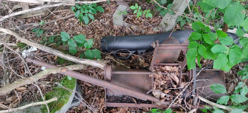

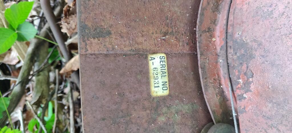

CountryRock 199 #1 Posted July 28, 2022 An acquaintance has an old snowblower attachment sitting in the weeds by his garage. I took a few pictures, including the serial number in hopes to identify it and figure out what models it fits. It appears to be a 36" single stage. Share this post Link to post Share on other sites
gwest_ca-(File Mod) 11,752 #2 Posted July 28, 2022 Appears to be a early 1964 serial number. If it is 37" wide it would be a model ST-374 (37" in 1964) to fit the 953, 1054 and 1054A tractors The other 1964 models are 32" models ST-324 and ST-324R that fit the Lawn Ranger 1 2 Share this post Link to post Share on other sites
