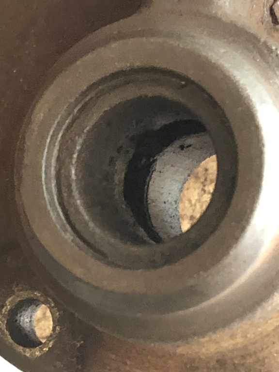

Handy Don 16,019 #1 Posted July 25, 2022 I'm trying to make one nicely running deck to put under my refurb'd 854. I have three parts decks and, so far, at least one decent usable version of every part, even blades (hooray!). The clip from one of the IPLs shows the spindle "stack" from the spur gear at the top to the blade bolt at the bottom. The thing in the middle is the main bearing housing plate. The one glitch I have is that the best of these plates has the worst bearings. You can see in the photo that the needles are completely caked-in with dried grease--in effect the spindles were spinning in a "grease bushing"! (I'd already removed the grease seal.) I do have a set of good spindles with no detectable wear and with cleaned grease ducts and zerks ready to channel some Lucas Red! Each spindle needs a pair of pressed-in 1508 needle bearings (#5) and a 1303 oil seal (#6). These are readily available for about $55 for the lot. Where I need help is the on best way to get the old ones out and the new ones in. I've never replaced bearings like this and don't have any purpose built tools for the job. What do I need and how do I do it? Thanks! Share this post Link to post Share on other sites

Handy Don 16,019 #7 Posted August 1, 2022 (edited) Thanks for the insights, gentlemen! The washer & bolt idea for removal intrigued me so I tried it quickly using a standard washer just to see if there was enough room between the two bearings in the bore to get the washer to turn across the end of the bearing. Nope.There is less than ⅜" separating them. I did check with my local parts stores (no nearby NAPAs) and none had the gripping bearing removers I would need (the kind that gets inserted and then a bolt goes down the middle to expand the "gripping lip" at the bottom so you can pull the bearing out. Finally bit the bullet and used a brass punch, penetrant, some heat, and some patience and they are all out (turns out that there were only three in there--the place for the 4th was just a "caked grease bushing ). I have a couple of minor scratches on the two bores to touch up before putting in the new bearings but I'm satisfied. The good news, though, is that another member has offered to make the tool according to the Torrington specs and lend it to me when its done. It'll set both bearings at their proper depths into the bore and, as well, set the oil seal. WooHoo! I will post some details and pictures when it gets put to use. Meantime, I'm working on painting, etc. Edited August 1, 2022 by Handy Don Share this post Link to post Share on other sites

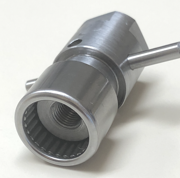

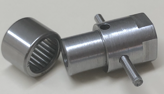

Handy Don 16,019 #9 Posted August 3, 2022 (edited) Wow. I picked up the tool from our member yesterday and, when I got home, the bearings had arrived. Here are a couple of pictures of them together. I have a bit more work to do before I insert the bearings but I'll get images of that. I'm thinking it'll be fun to use this! The quality of the work on the tool is amazing and it is to the exact specs that the bearing maker recommends with the proper clearances for the ID's of the bearing and the bore to assure proper alignment and clearance as well as the proper angle on the pressing edge to apply the force at the outer edge of the bearing cage and not near the roller ends. A couple of extra thoughtful details are: - the threaded hole in one end and the wrench flats at the other end--these let you pull a bearing into place using a bolt and plate from the opposite side--no press needed - the two holes through the body--in conjunction with the metal rod, each one stops the tool at a correct depth into the bore that the bearings and seal require for the RM-type decks (additional holes could be made for other depths)--no measuring required - it can work for removing bearings as well as setting them, where there is a through bore, such as with the RM deck bearing housings It was made by @ri702bill and anyone should feel free to contact him directly about a purchase. (You may recall, that he's also created a hitch pin with an interior grease channel and zerk to prevent the dreaded "frozen in place" syndrome--I saw one and they are really neat!) Edited August 3, 2022 by Handy Don 1 3 Share this post Link to post Share on other sites
ri702bill 11,409 #10 Posted August 3, 2022 (edited) @Handy Don - thanks for the kind comments - it was a pleasure to spend a bit of time with you and chew the "WH fat",,, A side note - the 3/16" dowel was the largest I could use so as to not create a breakout in the middle - other hole locations MAY require a double ended tool - more material, more machining, more time and expense... Bill Edited August 3, 2022 by ri702bill 1 Share this post Link to post Share on other sites
